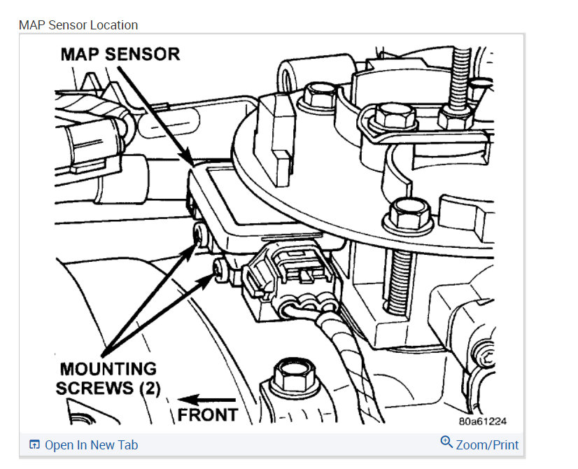

Can I ask which rebuilder did the engine? also does the engine seem to have the same power as the old engine? It sounds like you may have a bad MAP sensor. this guide can help us fix it with the MAP sensor location in the diagrams below:
https://www.2carpros.com/articles/engine-hesitates

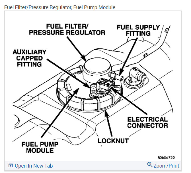

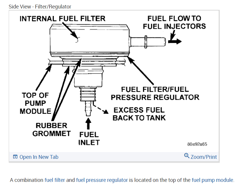

We should check the fuel pressure as well and check the fuel filter.
and
https://www.2carpros.com/articles/how-to-change-a-fuel-filter

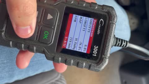

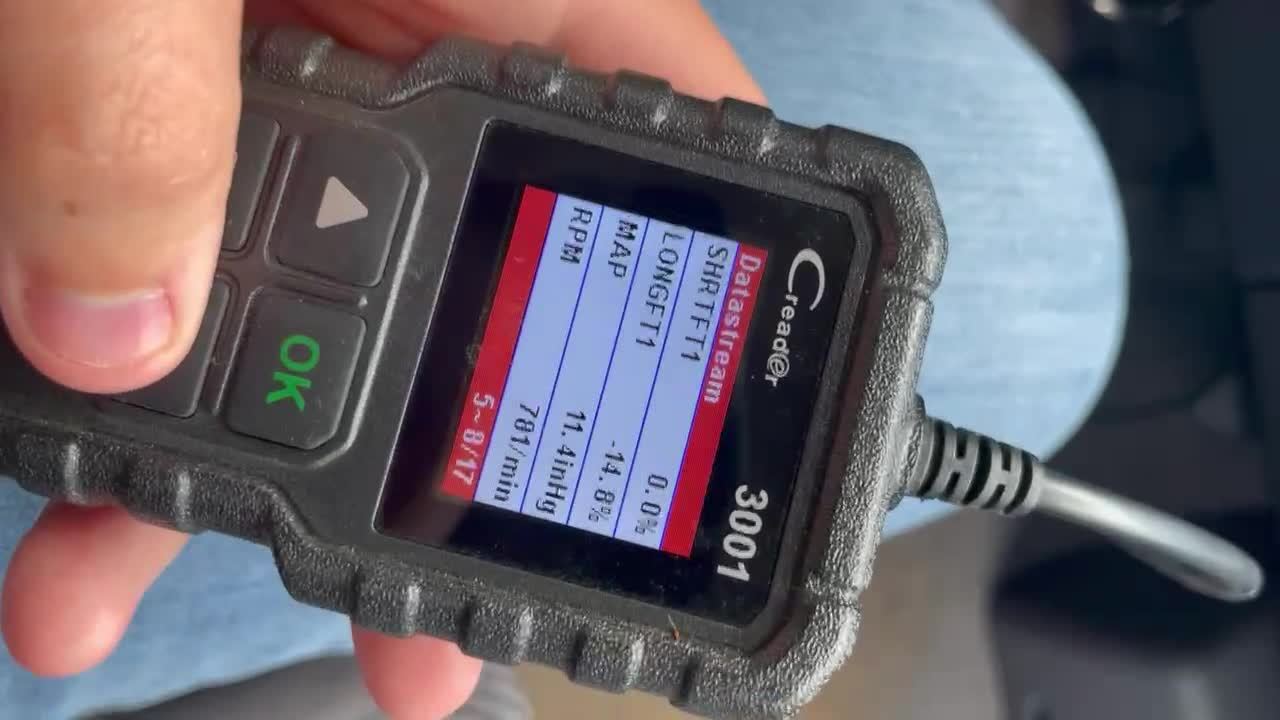

The rebuilder was AutoZone this is my 2nd one the first one had low compression on 2 4 and 6. So I made sure to check compression on this Ken and it is good.The fuel pressure is good.I recently put a new MAP sensor on it I tried to tell if it was good with a OB2 reader but couldn’t tell.I’ll leave that video below.

With those reading it seems like we may have a bad cylinder. let's remove the spark plugs and take note of the color. We are looking for the plug that is different from the rest. Then let's do a compression test. this guide can help:
