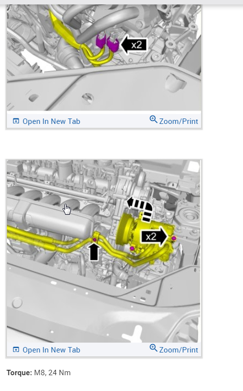

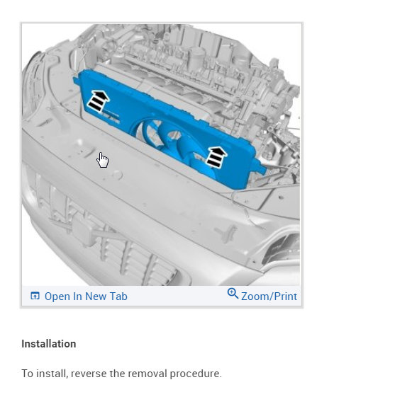

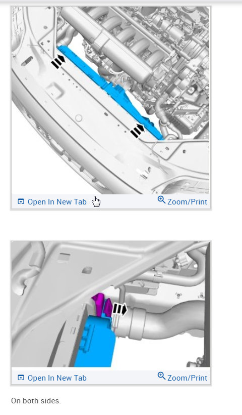

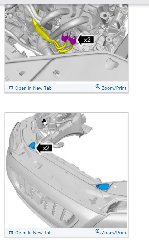

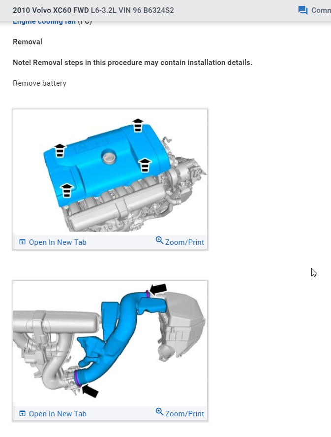

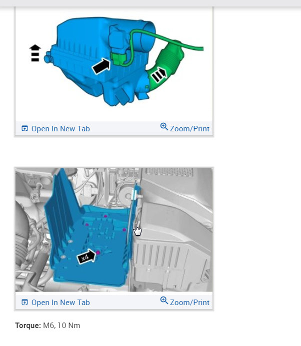

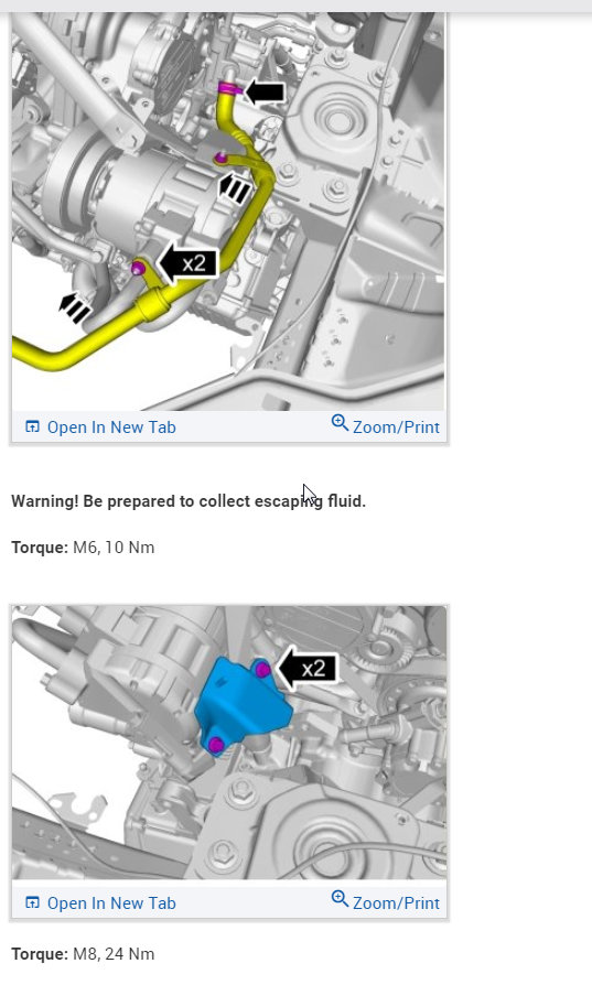

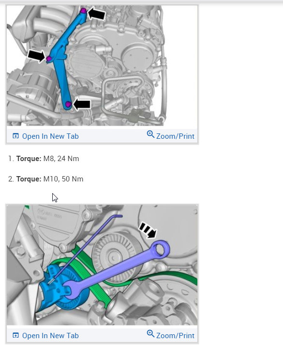

Here is the procedure on removing it. Let me know if you have questions. Thanks
