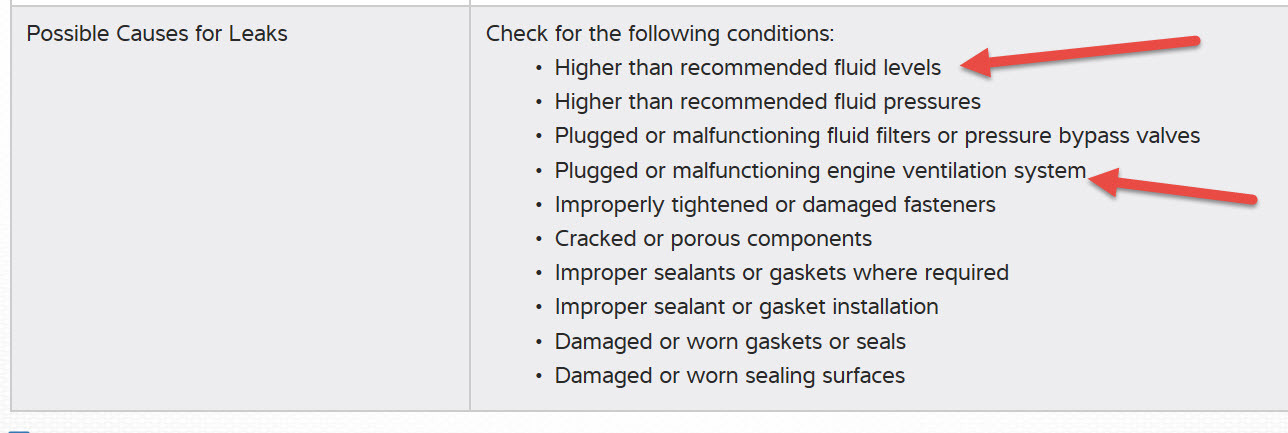

wow, what a problem I can suggest you get a court date on this for one reason is the people that are hired in to fast lube places. I'm sure that the company that changed the oil will say it's owner's responsibility to do maintenance checks. Like checking oil. Or that is one of the excuses they said to relieve themselves of responsibility. Having analyzed engine failure for GM North American operations I can tell you that much oil would have caused a bunch of problems that you explained like pushing oil through the seals and gaskets for one. I am however surprised that you got that far without a problem surfacing . it would be best to see how much coolant if any is/was in an oil sample to see if you possibly blew a head gasket and it dumped coolant into the engine and caused the overfill of oil. However not seeing this firsthand it is hard to give a proper answer. a sample should have been taken and analyzed right at get go to help support your case. If it were more oil than coolant then it would tilt in your favor. As far as the temp outside that would have nothing to do with the engine failure due to driving on eway which is very easy on an engine. when an engine is overfilled with oil it cause foaming or air in pan which would eventually get into system of not complete fluid lubing things like it should. As far as who is right or wrong is hard to say. Most mechanics will agree that it's not a good thing to overfill oil or you can overfill a tad and not have problems. But from what you are saying is a gross overfill and I would think give some type of problem quickly. However , having been a mechanic for 50 yrs today most people don't look under the hood unless they get a problem. long as it runs ok change oil an d put gas in it and go especially with today's engines So I guess you'll have to take your answer from what I've written which from my perspective is still vague....

one other thing to add in chart I'm sending in pic it shows two arrows which are for oil leaks the first arrow causes the second so oil Is forced out gaskets and seals because a pcv system in no way could keep up with that. make sure to read first reply as well.
