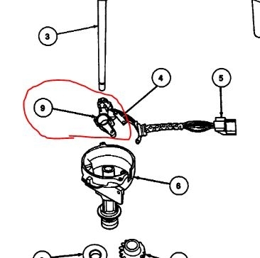

Now, the crankshaft sensor on your vehicle is different than most. It is located in the distributor. I attached a pic of the component and circled it. Here are the directions specific to your vehicle for replacement. The remaining pictures correlate with the directions.

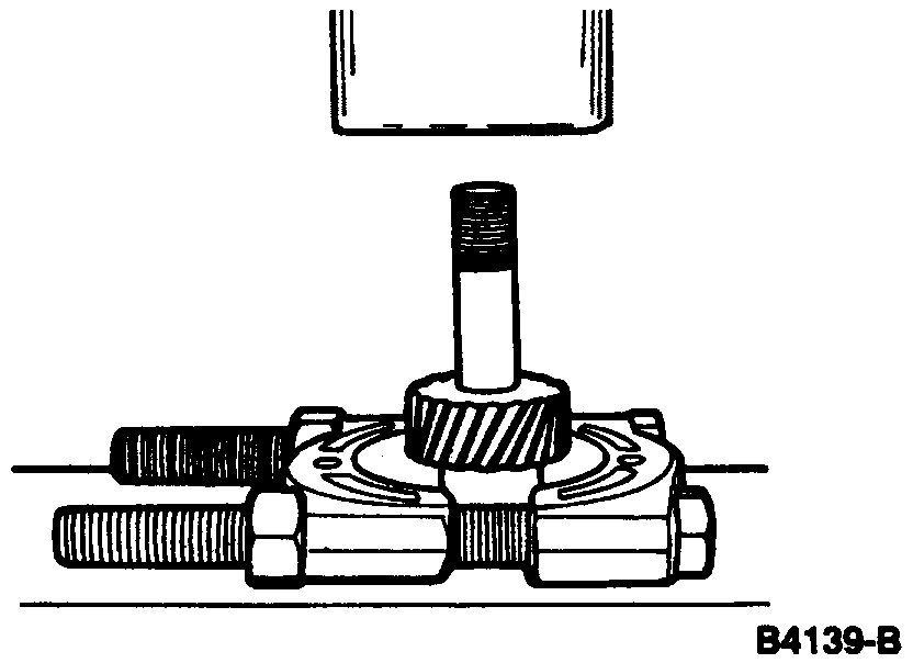

Pressing Distributor Gear Off Shaft
pic 2
10. Invert distributor and support in Axle Bearing/Seal Plate T75L-1165-B. Press distributor drive gear off using Bearing Puller Attachment D79L-4621-A or equivalent.

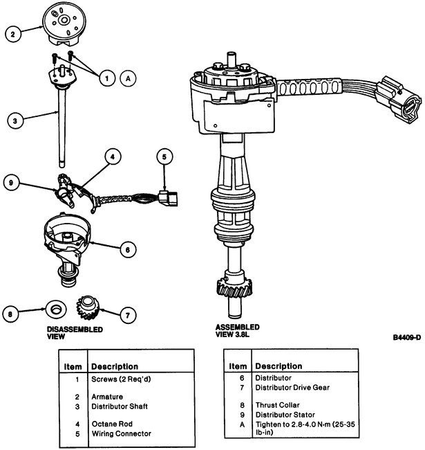

Distributor Assembly, (3.8L Shown, 3.0L Similar)

INSTALLATION
1. Place distributor stator over bushing and install into seat.
2. Place stator connector in position. Tab in notch on distributor housing and fastening eyelets aligned with screw holes.
3. Position stator wires away from moving parts.
4. Install two stator retaining screw or screws (depending upon application) and tighten to 1.7-4.0 Nm (15-35 in lb).
5. Install octane rod and retaining screw. Tighten to 1.7-4.0 Nm (15-35 in lb).
6. Apply a light coat of Motor Oil XO-10W30-QSP or -DSP or equivalent meeting Ford specification ESE-M2C153-E to distributor shaft below armature.
7. Insert distributor shaft through distributor housing bushing.
8. Install distributor shaft collar and roll pin.

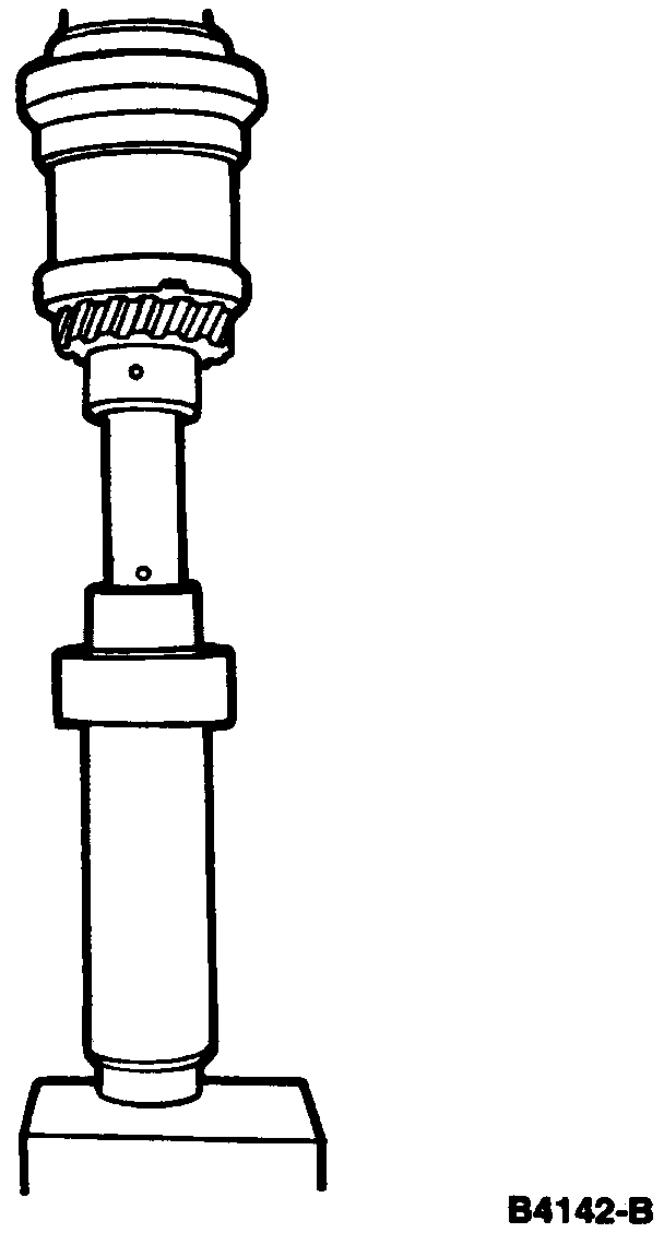

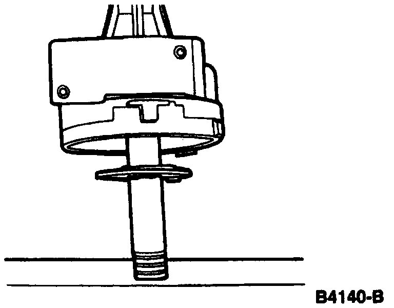

1/2 Inch Socket Over Distributor Shaft
pic 4
9. Place a 1/2 inch deep-well socket over distributor shaft on armature end of distributor shaft. Invert and place on arbor press plate.
