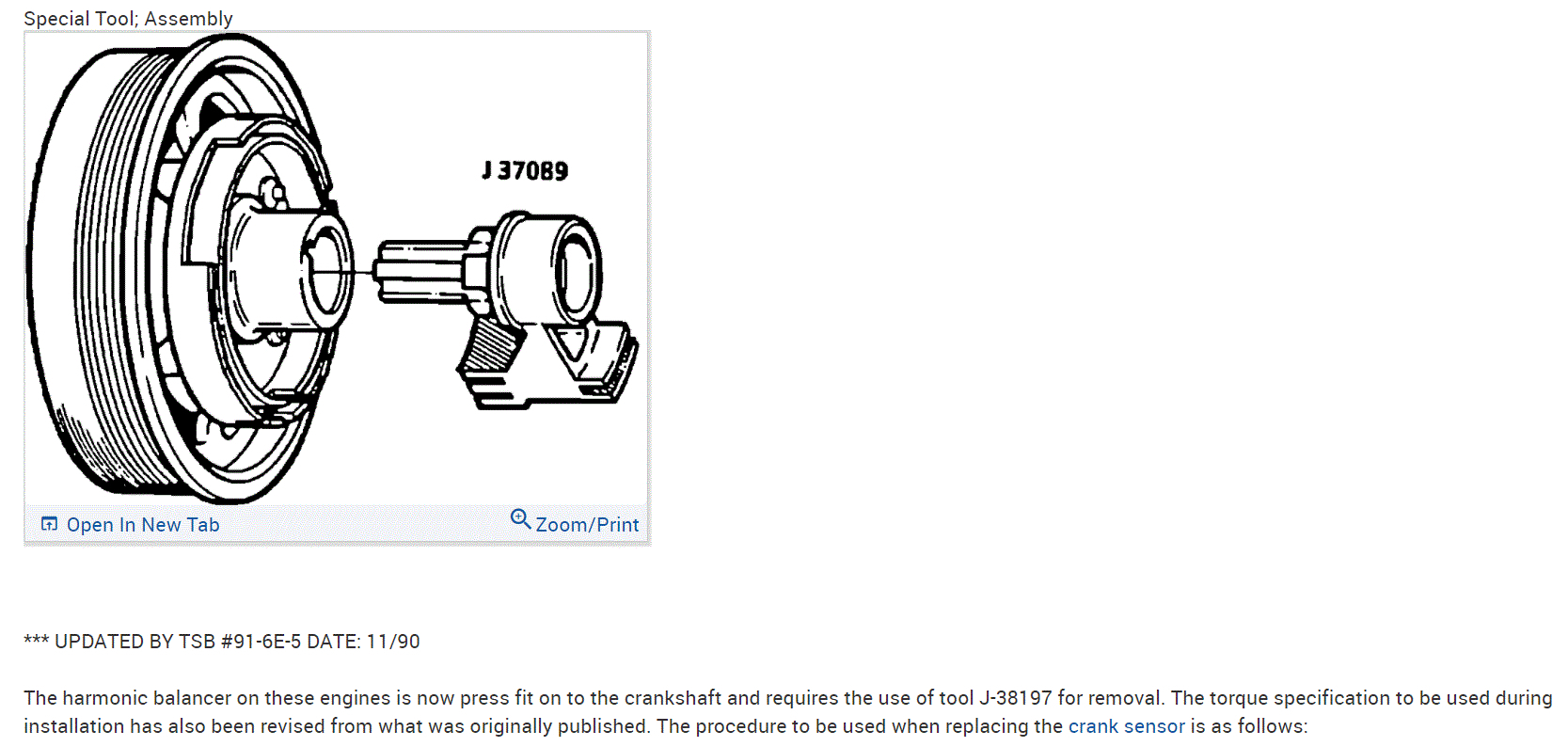

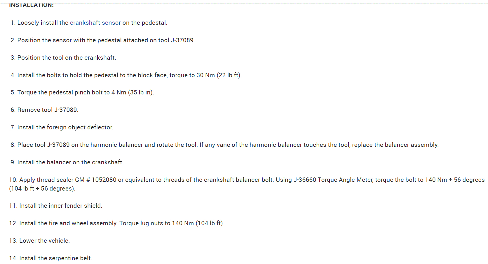

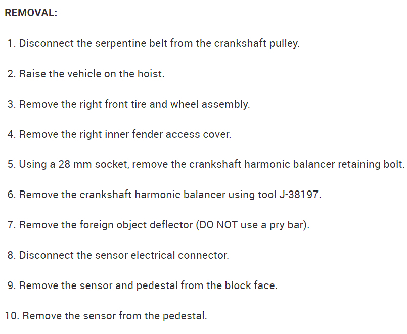

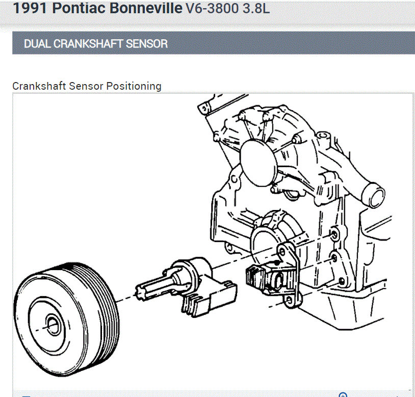

Now, what you described sounds like a bad crankshaft position sensor. You mentioned several things that were replaced. Was the crank sensor replaced?
Take a look through this link and let me know if it mirrors what you are experiencing:
When the sensor starts going bad, it will often fail due to heat. After cooling off, it will work again. When it fails, spark is lost to the plugs. So, you could check for spark when it doesn't restart. Here is a link that shows how that is done:
IF you determine it is bad, here is a link that shows in general how to replace one:
The attached pics below are the directions/pic specific to your vehicle for replacement.
