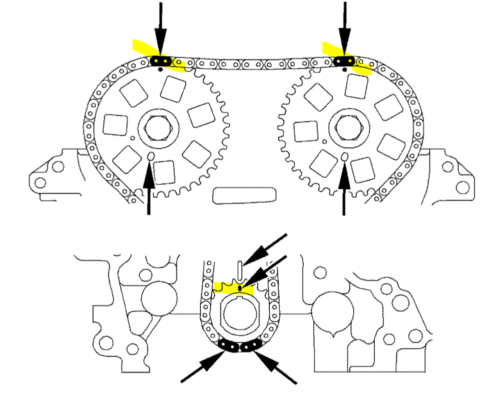

When you checked the timing chain marks on the cams, was the crank at TDC? See pic below. Also, when you crank it, is there any evidence of it firing? Are you spraying the starting fluid directly into the throttle body? If you remove the spark plugs, are they dry or wet with fuel?

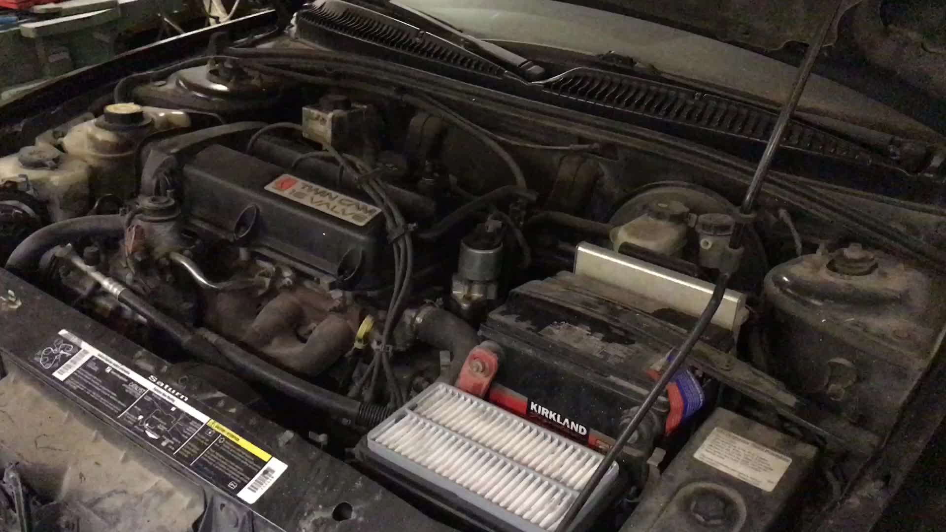

Hi Joe, I sent a reply, but it disappeared, so if there's a duplicate I apologize. I'm also thinking flooding could be the problem. Today I popped out the fuel pump relay and got my wife to try starting the car while I varied the timing of some engine starting spray down the throttle body -- I managed to keep it going for about 10 seconds. With the relay back in the initial start attempt was better than in the past but partial throttle and pedal to the floor was no better. If it is flooding, I'm guessing either the computer or a sensor. Is there any fuel pressure sensor? I don't see anything in my Haynes repair manual. Thank, Al.
Friday, April 15th, 2022 AT 6:21 PM
  • 109,724 POSTS
There is a fuel pressure sensor in the fuel tank, but its only purpose is to identify evaporative emission system leaks.

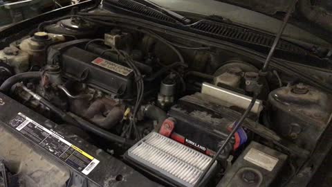

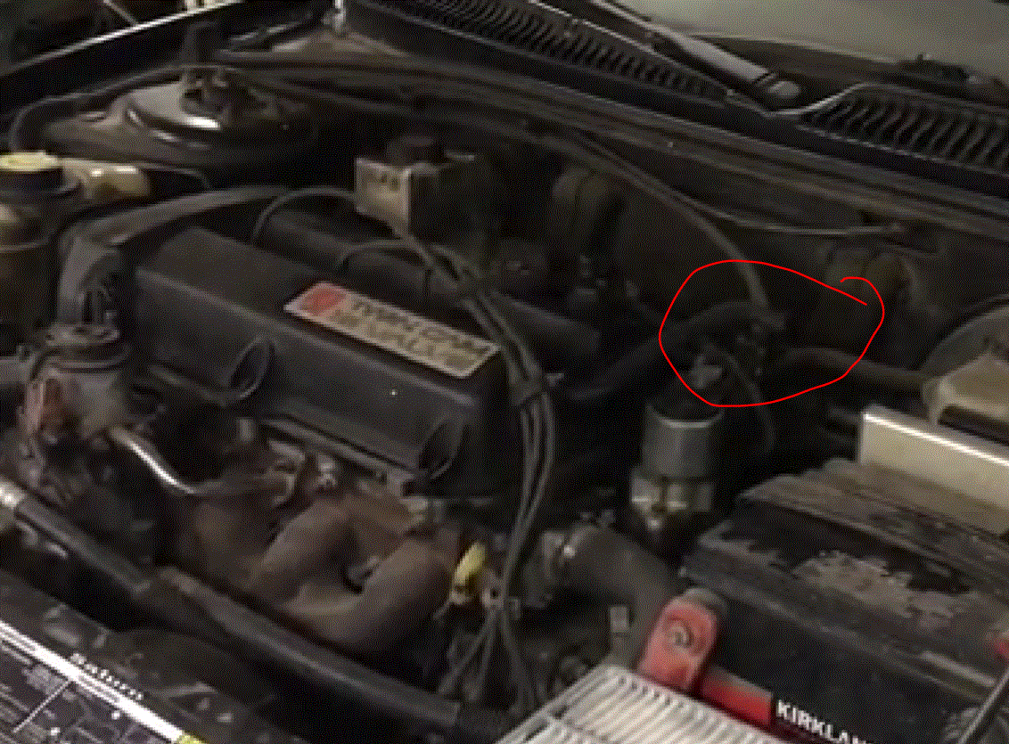

I attached a pic from your video. Is that the PCV hose?
Try something for me. Disconnect the MAP sensor and let me know if it runs differently or if there are any changes.
+1
Friday, April 15th, 2022 AT 8:23 PM
ALAWISHES
  • 12 POSTS
Hi Joe, yes that's the PCV hose. I removed a fair amount of the intake system to access the throttle body plus make sure there was no restriction anywhere. After sitting for a day and disconnecting the MAP plug, it initially resulted in a little longer run, slightly higher RPM and a little less roughness but the engine quit after 10-15 seconds. Restarting immediately after this resulted in the same rough run for a few seconds. 12v at 2 terminals on the MAP plug. TPS has 5v feed and varies from.43v to 5v when throttle is moved from one extreme to the other. Coolant temperature sensor has 5v feed and when removed it varied in resistance when run under hot/cold water.

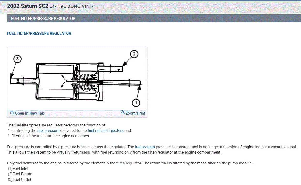

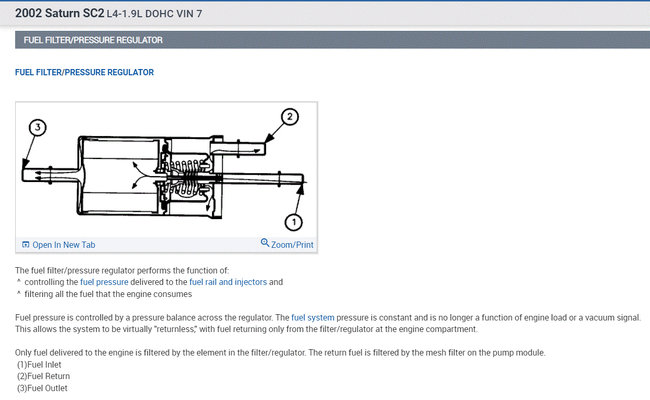

I may have figured this out. The fuel pressure is regulated at the fuel filter. The filter is just that, a filter, but it has an integral pressure regulator. See pic 1 below.
By chance, have you replaced the filter?

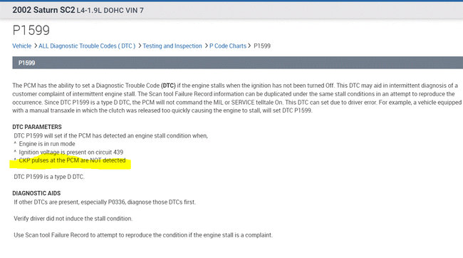

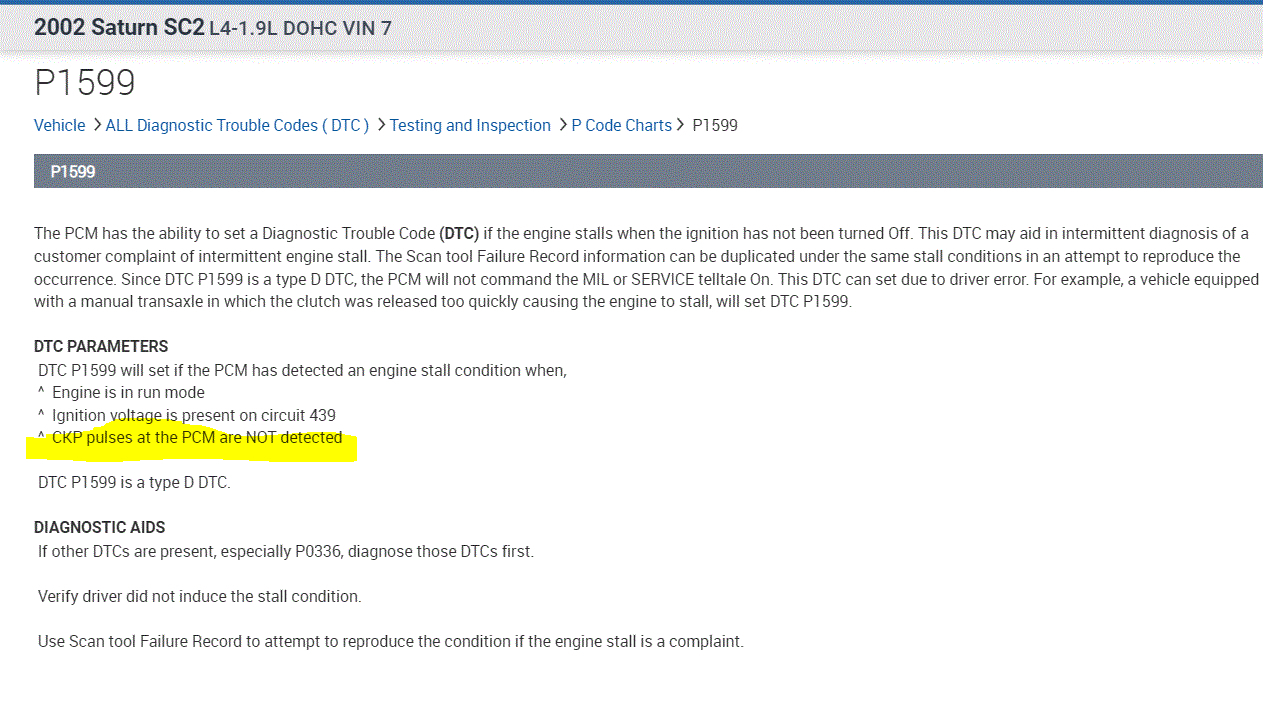

Hi Joe, my friend finally got back and borrowed a Snap-On high end code reader. It showed code P1599, and when I looked into that it just means the engine stalled when the key was still turned on. I checked the fuel pressure again and it's 56# when the key is turned on, and while cranking (or barely running) it varies between 50 and 55#. He said there was another code that indicated something about the air intake temperature sensor (maybe that it had been replaced). I had already taken out this sensor and the resistance checks out correctly as I make it warmer and cooler, and there is 5v at the connector. Now I'm back to no ideas again. If you have any other brainwaves, please let me know! Cheers, Al.
Saturday, May 21st, 2022 AT 11:23 AM
  • 109,724 POSTS
Al,
You may laugh at this but try it. Remove the upstream oxygen sensor to see if it will start.
I'm questioning if it is a plugged catalytic converter. Read through this link:
Also, the code does indicate it stalled with the key in the run position. However, it also indicates the CKP signal was lost.
Read through the code description below and let me know your thoughts. Also, by chance do you remember the code related to the intake air temperature sensor?
See pic below.
Saturday, May 21st, 2022 AT 8:57 PM
