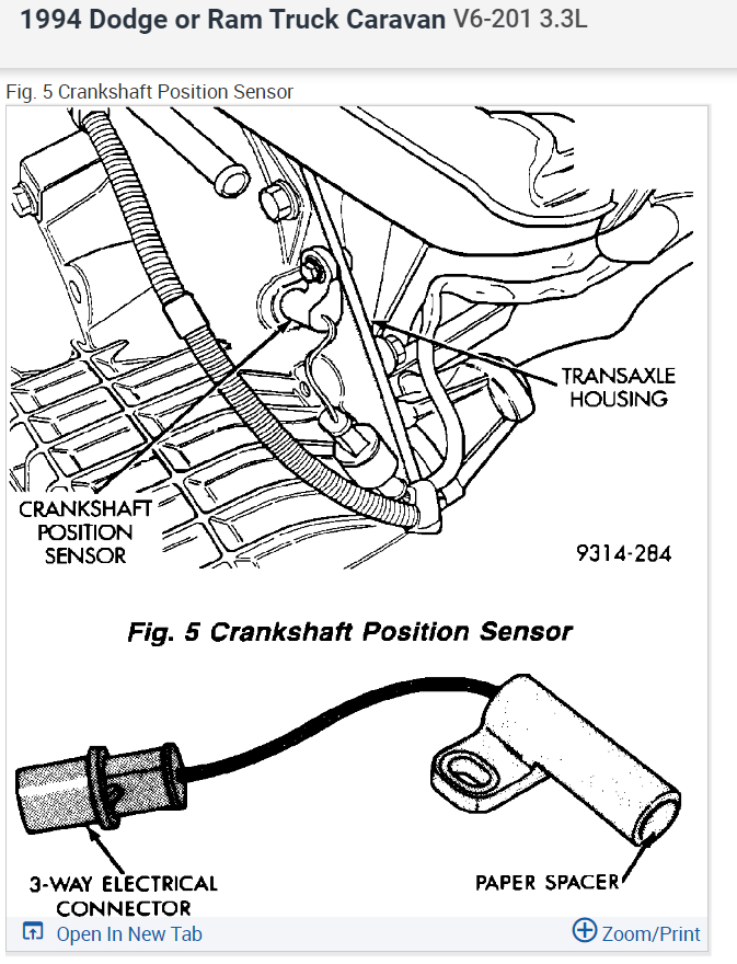

The engine shut off and will not restart?
1994 DODGE GRAND CARAVAN
190,000 MILES • 3.3L • V6 • 2WD • AUTOMATIC
DURK DABROWSKI
  • 30 POSTS
It felt like it was running out of fuel. i can still hear the fuel pump work when i try to restart it.
Jul 13, 2024 at 6:29 AM
  • 55,433 POSTS
How does it sound when it is cranking over? Can you upload a short video so I can hear it that way I can make sure the engine is not hurt. Also, let's check for spark which video will help you do.
https://youtu.be/baq_aEWNQ0Y?si=XFPy1s3jM04lRKV9
Please go over this guide as well:

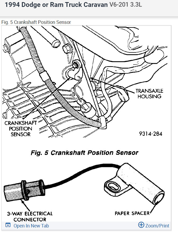

If there is no spark, I would swap out the crankshaft angle sensor here is the location of the sensor in case, you need it. Check out the images (below). Please let us know what happens.
