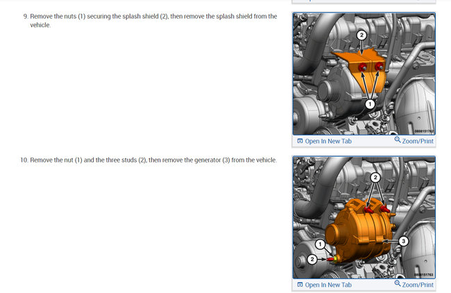

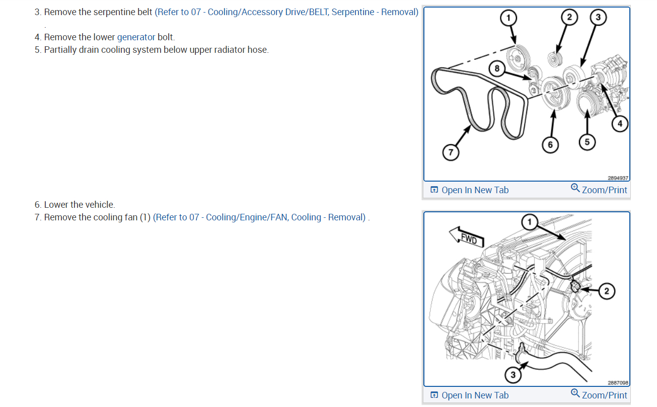

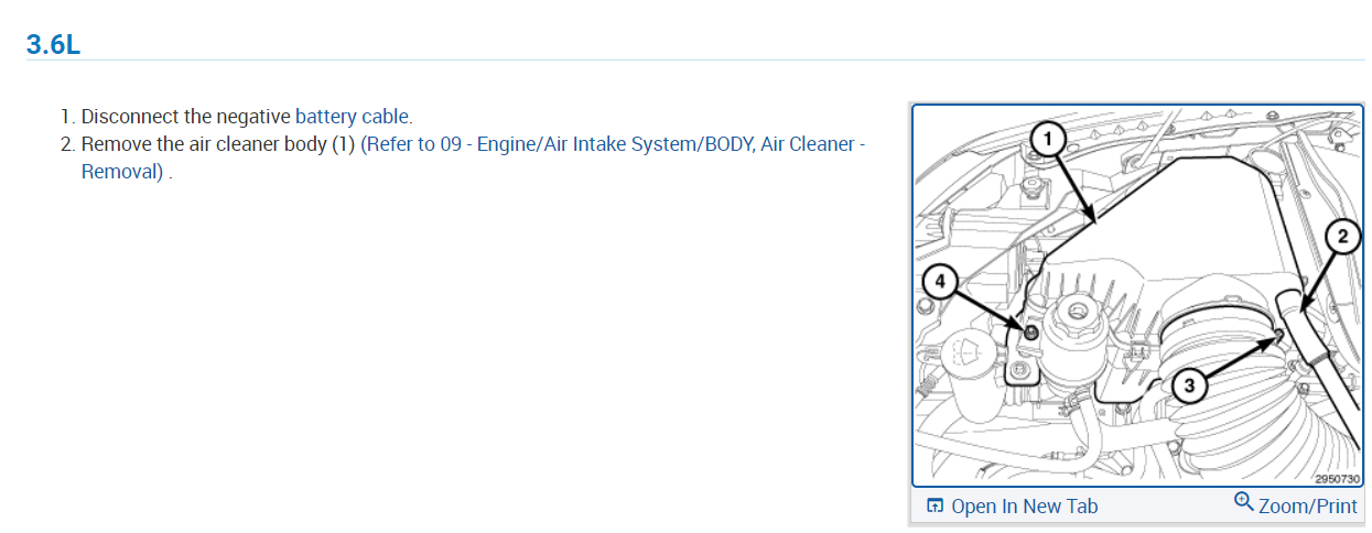

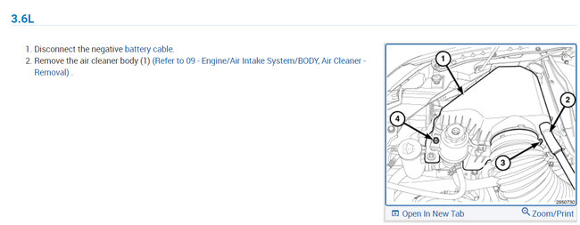

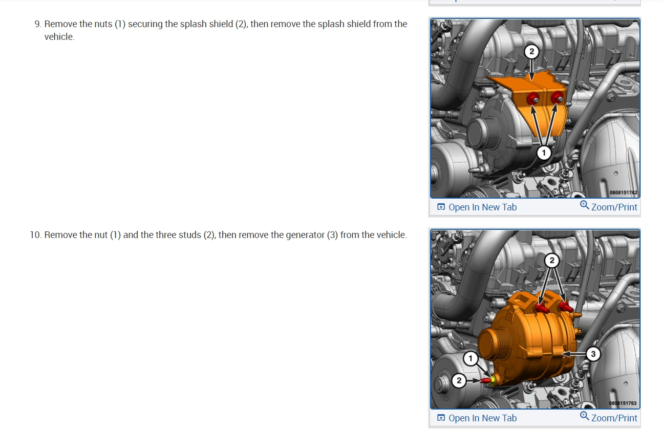

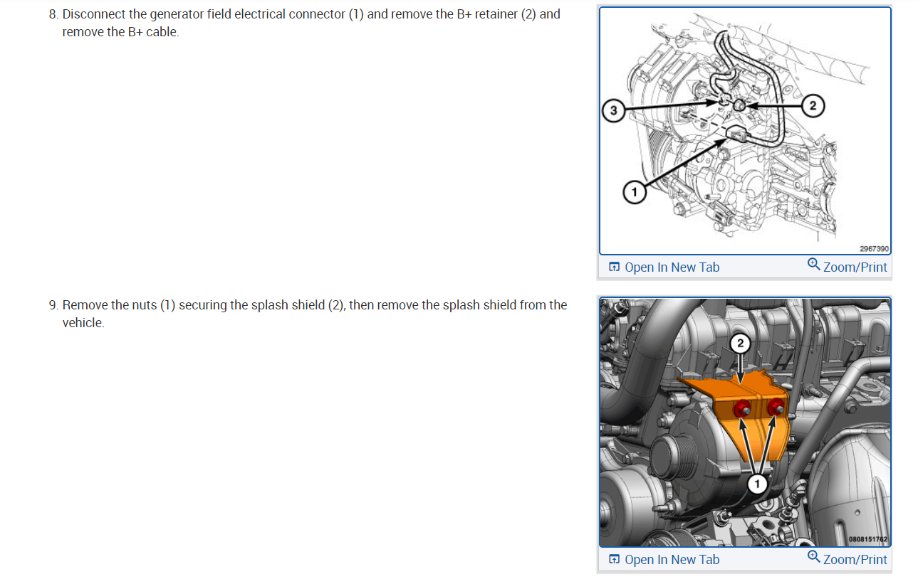

Good afternoon,
The alternator is not working correctly.
Most likely it got damaged from all the oil thrown around. It got inside the alternator and shorted out the alternator.
You would need a statement from the dealer that the oil leak caused the damage. Even then, I doubt the shop will own up to it. You may have to sue them to get any restitution.
