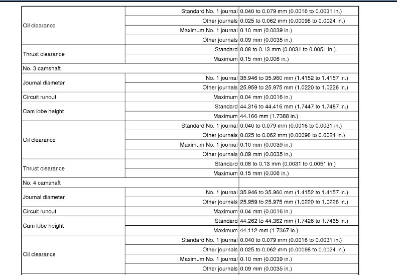

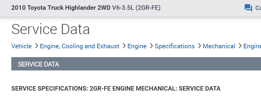

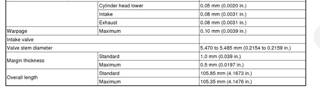

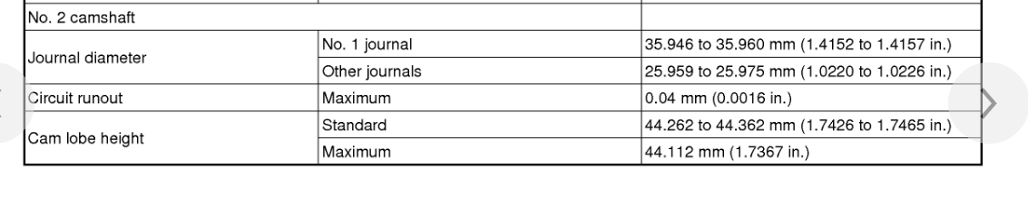

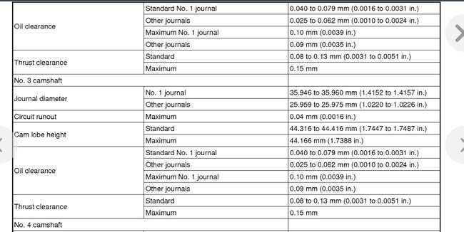

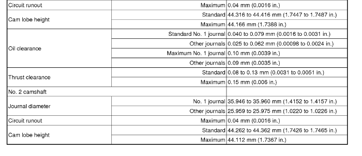

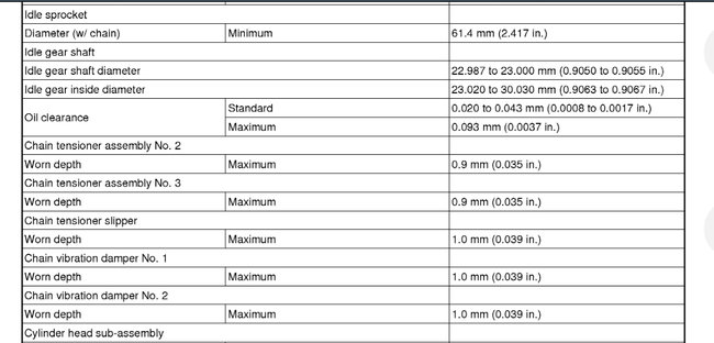

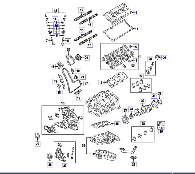

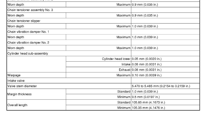

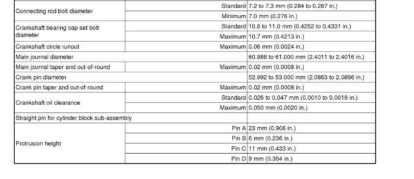

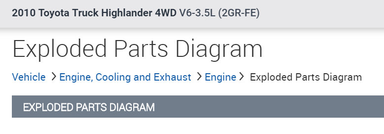

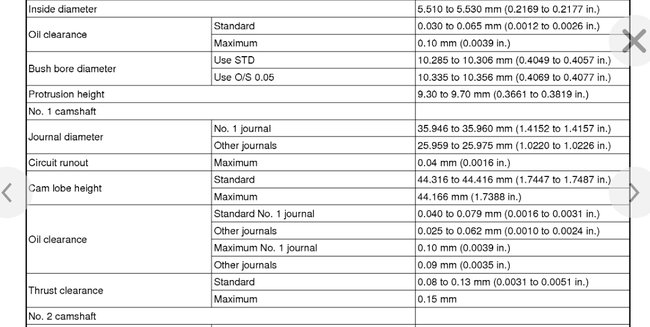

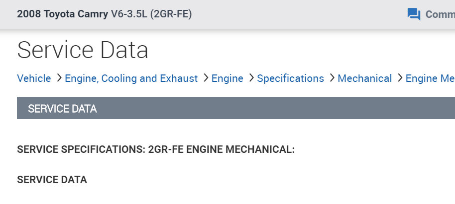

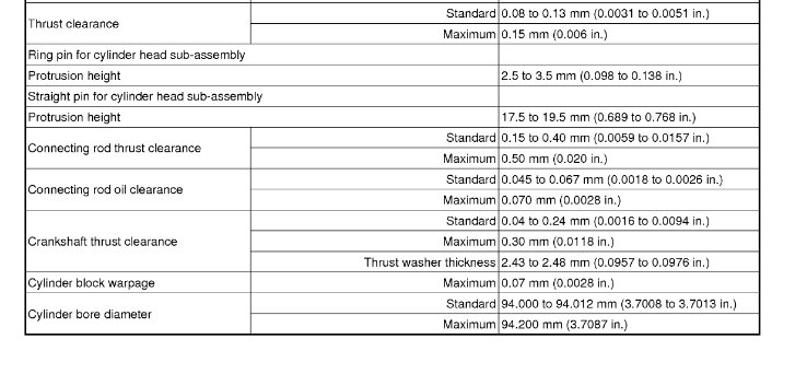

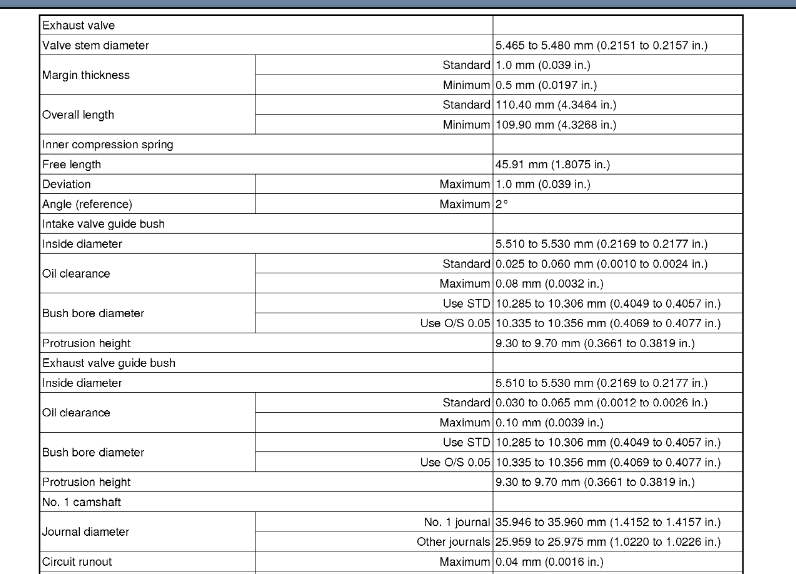

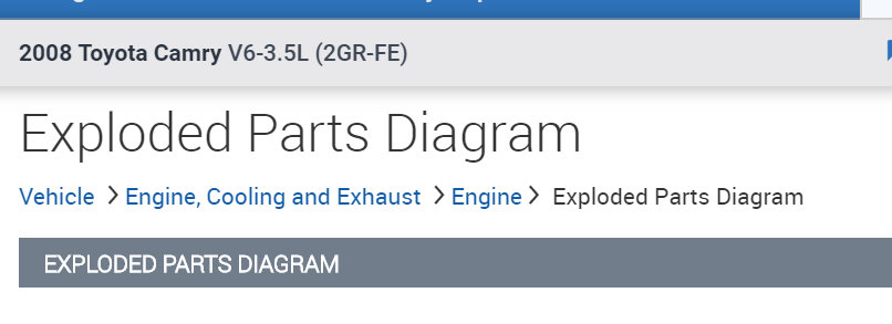

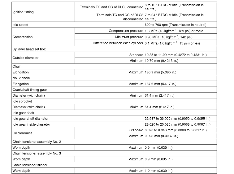

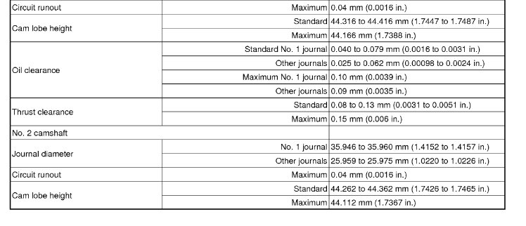

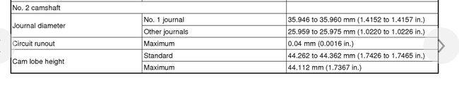

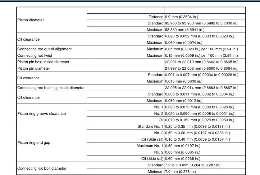

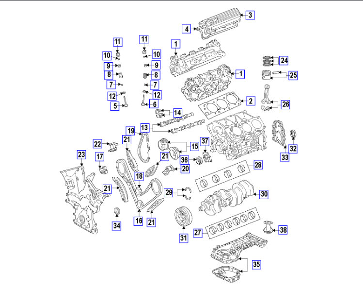

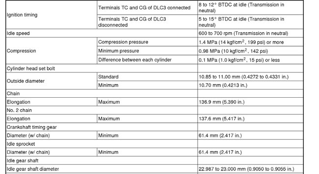

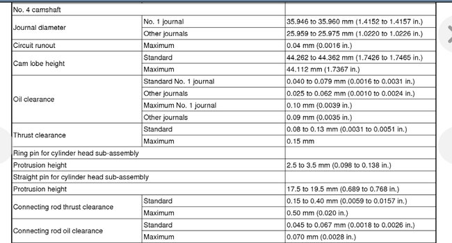

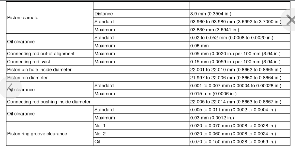

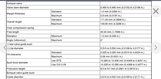

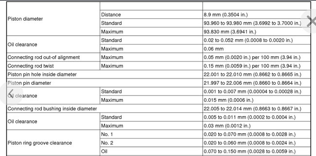

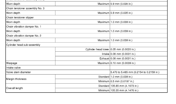

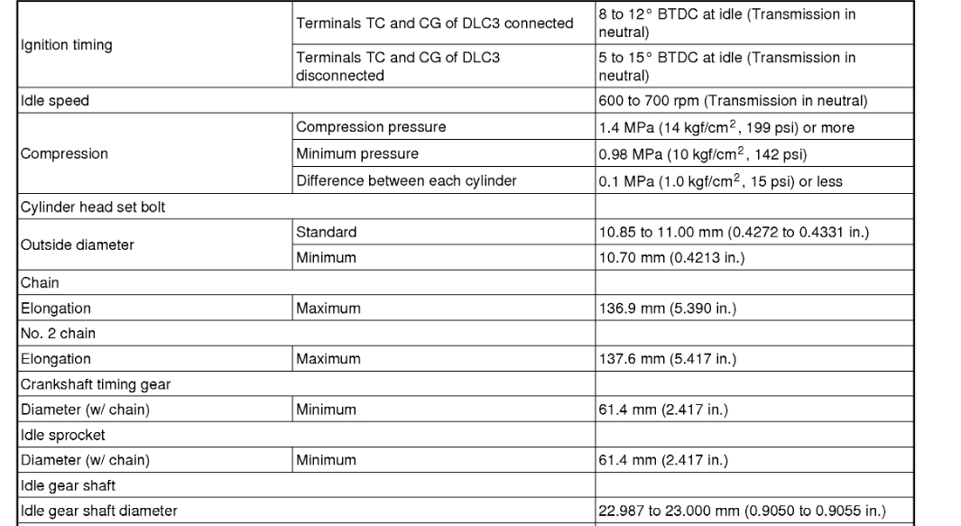

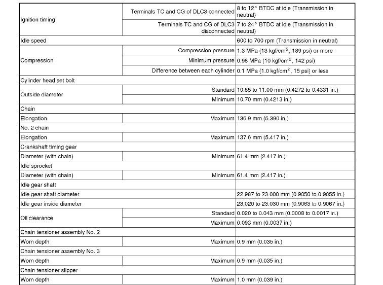

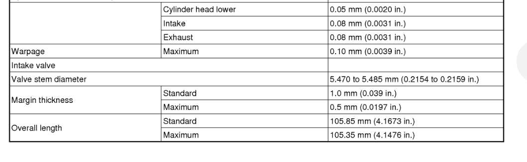

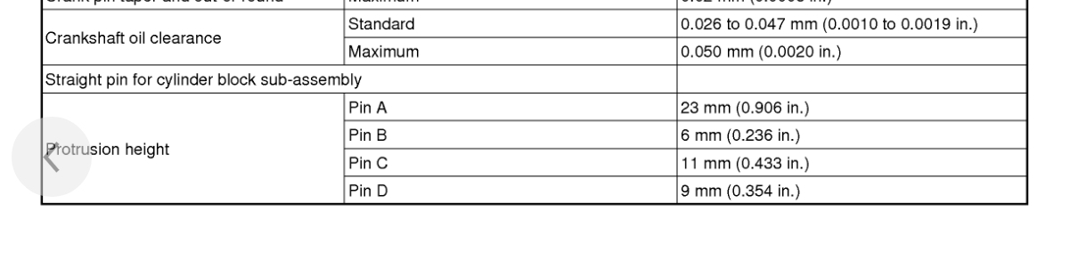

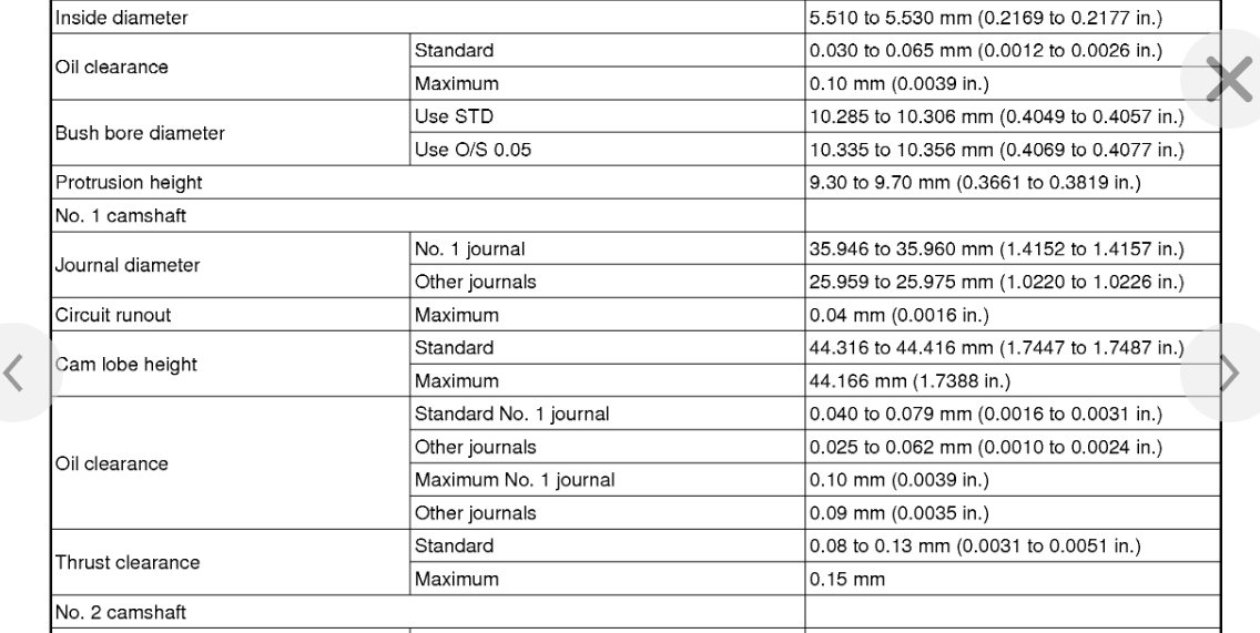

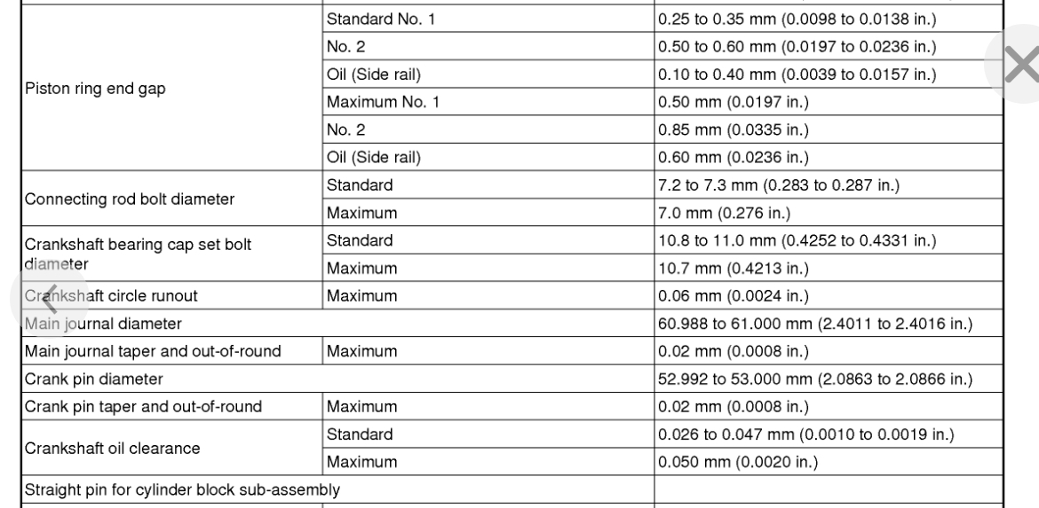

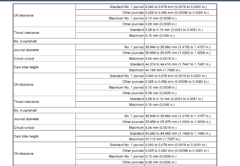

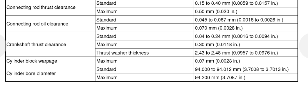

The engines are identical. The intake manifold probably needs to be swapped because of the intake runner length. The intake runner length will have a major impact on the characteristics of the engine. Longer, flatter intake manifold runners will produce more horsepower(like are on the Camry), while shorter and taller intake manifold runners will produce more torque(like are on the Highlander). The oil pan probably needs to be swapped because of the configuration in the engine compartment, simply to make it fit with the cross-member. Your mechanic probably doesn't want to do the work because he didn't purchase the engine and can't guarantee the engine. I would suggest finding a mechanic who is aware of your situation and is willing to do the work. We can send you instructions on how to replace the intake manifold and oil pan yourself, if you would like. In the diagrams down below I have sent you the engine specifics for both the engines so you can compare them side by side(Note the engine number on the top of the I.D. pages). Please get back to us with how things are progressing.
Thanks,
Alex
