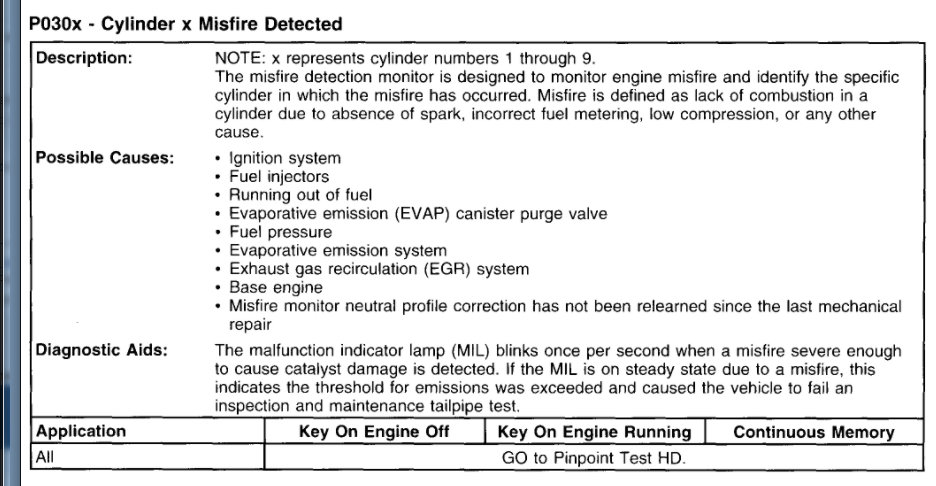

Loss of power, engine sputtering, smell of fuel from the exhaust, engine light flashing. Need to know where the fuel filter is for this model.

As for the issue, it appears you have a severe misfire that has damaged the o2 sensors. The two o2 sensor codes (p0030, p0130) are most likely a result and not the cause.
What have you done to address the misfire? If nothing, we need to start with this guide:
I would suggest swapping things from one cylinder to another on the other bank. Start with the plug and then the injector. If the misfire moves to that cylinder then that is the issue.
Then we need to check the compression if it stays on number 3.
Let's run through this material and go from there.

I originally suspected coil #3, however the additional symptoms had me a bit concerned that there was other or additional issues. I've had to change an ignition coil on another vehicle and it didn't really misfire unless you had to put it under load. I was also smelling gas in the exhaust that concerned me. I was also going to check the fuel pressure to the rail in case I had fuel filter issues. Of course that was dispelled when you told me that the filter was together with the pump in the tank. I will check the coils to narrow down the culprit. Thanks for the advice.
