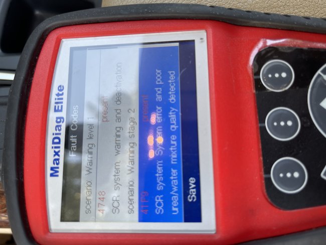

35d x5, There are codes p207F and P20EE, also a message on the cluster which says no start in 51 miles. Also, previously had the message on the idrive display: incorrect exhaust fluid. Also had previously: electrical malfunction message, but that went away after i drove it 20 miles. Car drives great with no engine or transmission issues.

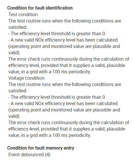

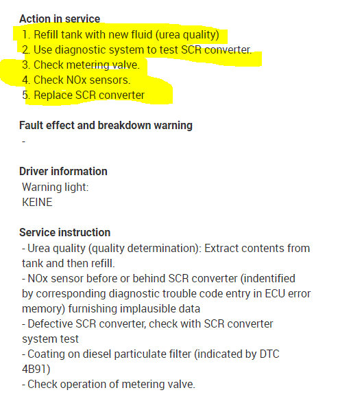

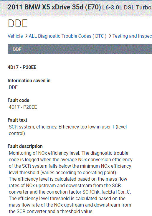

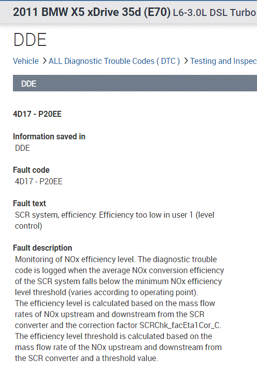

Did this start after refueling or adding DEF (diesel exhaust fluid)? I attached the info related to the codes you provided. They indicate the vehicle is producing excessive NOx gasses. NOx is Nitrogen oxide which is created when nitrogen and oxygen combust under pressure and at a high temp. They are poisonous and are controlled by the vehicle.
Selective Catalytic Reduction (SCR) is the most common method in diesel vehicle exhausts to lower NOx gasses. DEF is added to vehicles with Selective Catalyst Reduction (SCR) like yours to reduce the NOx output to nearly 0.
I hope that made sense, and I hope you understand why I asked if this started after refueling or adding DEF.

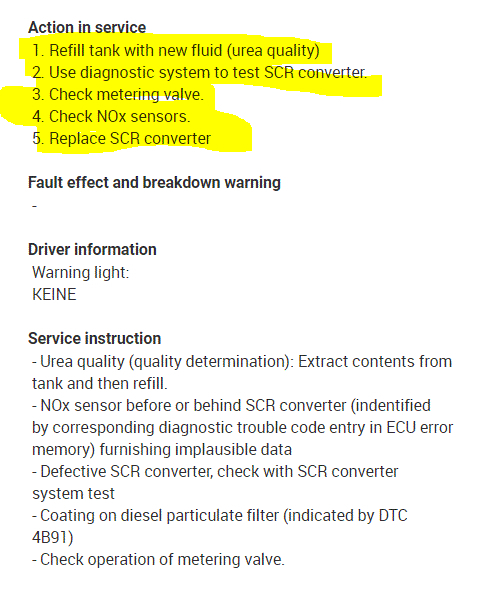

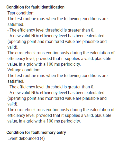

If you look at the attachments, it explains what is happening and what needs to be done. I highlighted the section which includes the diagnostics.
Take a look through these and let me know if you have questions. Also, note that the code 207F was rewritten by BMW to be 4D17 (manufacturer code and not a "P" code). You will note that the two, 4D17 and P20EE are identified in the attached info.
One last thought, make sure the engine is running at a normal operating temperature. If it is running hotter than normal, that can cause this to happen as well.

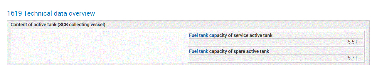

Is there a way ti remove the def fluid from both passive and active tank before refilling? If not how do i know if it is full when refilling? the def fluid.
Aug 24, 2021 at 9:21 AM
  • 110,194 POSTS

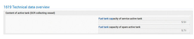

The only thing I can say is to remove the blend pump and siphon it. As far as quantity, I attached how much the system holds below. Also, there should be a level sensor in both. The fill level detection in the passive tank takes place by means of two individual sensors that are fitted on the top and bottom of the passive tank. This means it is possible to detect a full tank and an empty tank.
Let me know if this helps.
See pic below.

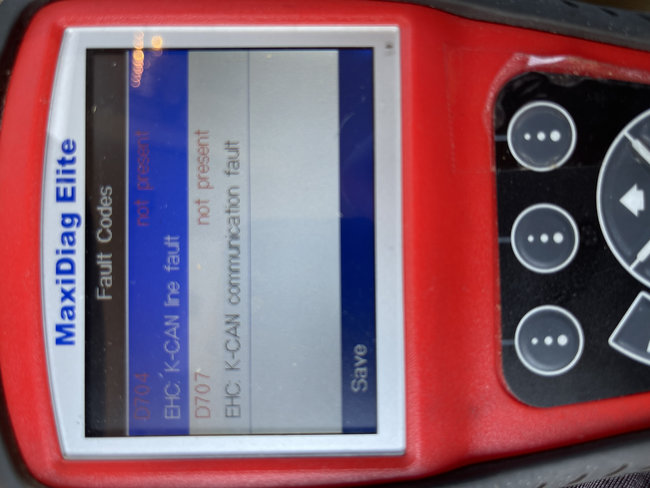

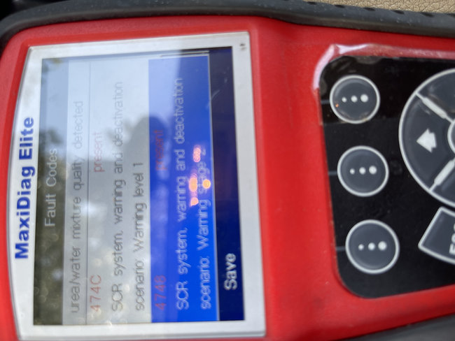

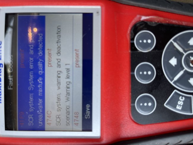

Cleared the codes and rescanned, do you think the statement indicates that the def fluid could be wrong or mixed with water some how?, is there a way to siphon it out with a pump via the fill hole? 3rd one is just codes for the ride level malfunction.
Aug 25, 2021 at 9:36 AM
  • 110,194 POSTS
Interestingly, I am not finding any of the codes, but based on the description, I would say it does appear to have water/moisture in the system.
As far as removing the DEF, you should be able to siphon it out through the filler.
