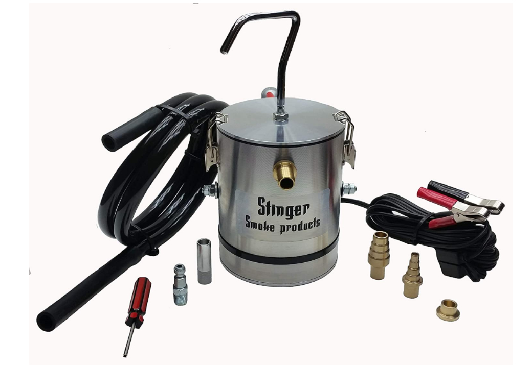

Suggest to first swap the upstream oxygen sensor from bank 2 to bank 1.
If your mechanic has smoke tester, I would suggest to smoke test the intake system and check for leaks, see image below.
How to check for a vacuum leak.
A good video.
https://youtu.be/TmV_HjeiuCc
Hope this helps.
