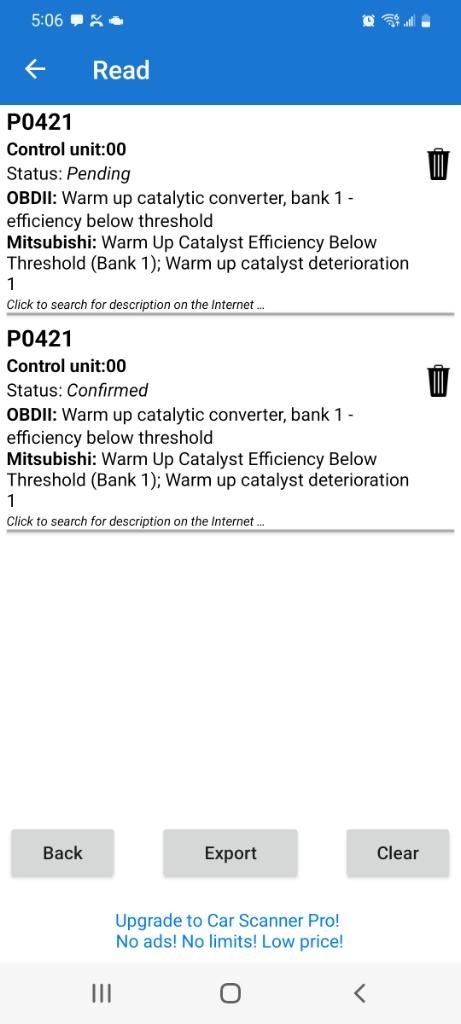

Check engine light on with code P0421, how do I fix it?
2003 MITSUBISHI GALANT
130,000 MILES • 2.4L • 4 CYL • 2WD • AUTOMATIC
JACOBPAULSEN
  • 64 POSTS
Check engine light on, how do i fix this?
Any ideas of the cause?
Aug 24, 2022 at 3:31 PM
  • 110,194 POSTS

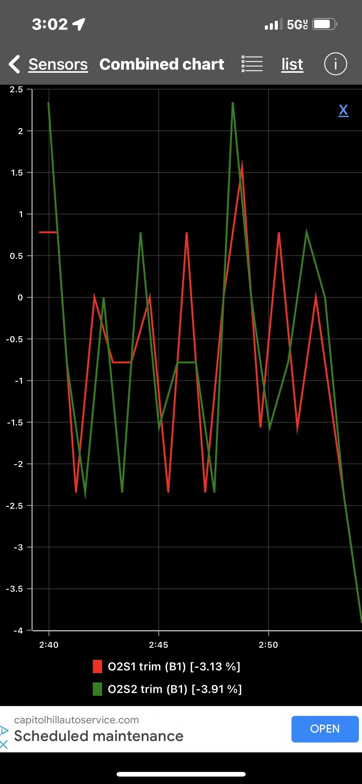

The code is related to the warm-up catalyst operating below the threshold. The most common causes for this code are a faulty or worn catalytic converter, a faulty heated o2 rear sensor, an exhaust leak before the upstream sensor, or the PCM itself.
Here is how it works. The signal from the rear heated oxygen sensor should differ from the front heated oxygen sensor. That is because the catalytic converter purifies exhaust gas. When the catalytic converter has deteriorated, the signal from the front heated oxygen sensor becomes similar to the rear heated oxygen sensor. Once the PCM recognizes this, the code is set.
So, by any chance do you have a live data scan tool that we can compare the front and rear oxygen sensors? Also, are there any bad odors coming from the exhaust?
Let me know. Also, let me know if there are any exhaust leaks.

This has been this way for about 10 years I'm just finally choosing to do something about it.
There's no exhaust leak or foul odors.

Sounds like a plan. Also, if you have a live data scan tool, watch how the sensors react. The front and rear shouldn't be nearly the same. If they are, the converter isn't doing its job.
If you don't have a live data scan tool, here is a link that explains how to test an oxygen sensor using a voltmeter or multimeter.

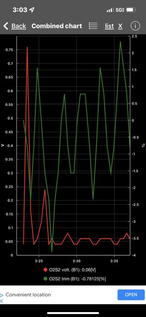

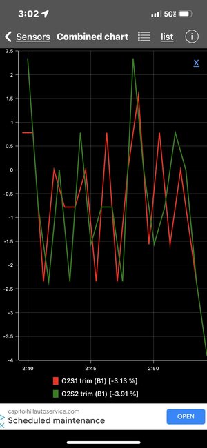

So, today I turn on the car I still haven't had time yet, but today I was stopped at a stoplight pressed on the gas pedal and the car starts jerking forward very fast.
I turned on the hazards and turned into a parking lot, put the car in park, and let it rest for a few seconds.
Then I put the car back in drive and it stopped jerking when i pressed on the gas.
Four months ago, the car would start then immediately turn off.
Could these be related?
What could be the issue be?
Aug 31, 2022 at 11:13 AM

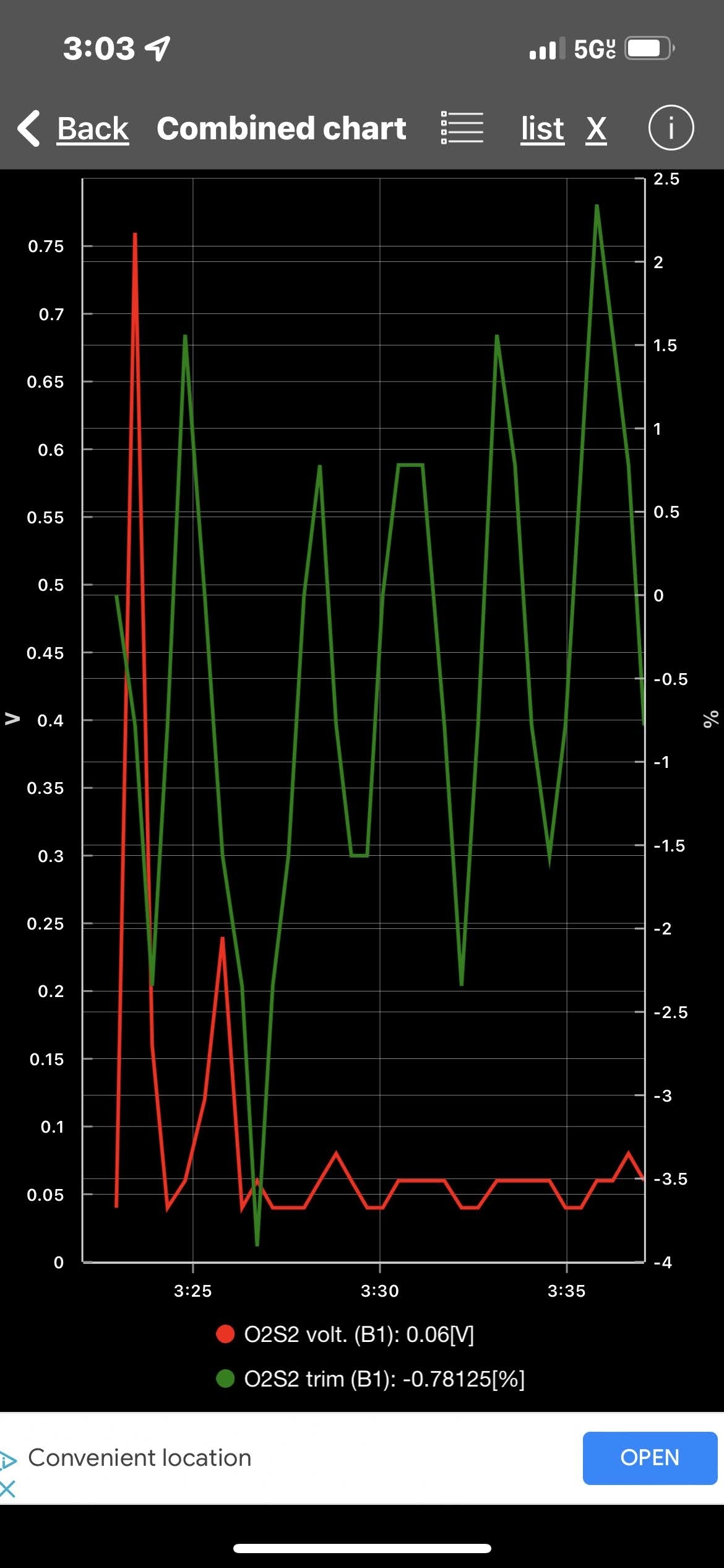

  • 110,194 POSTS

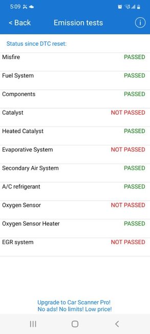

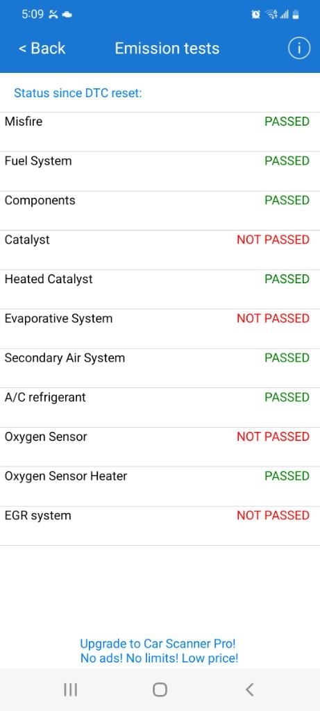

They could be related. However, I have a feeling we have a fuel issue related to the issue. Have any new codes turned up?
Aug 31, 2022 at 6:08 PM
JACOBPAULSEN
  • 64 POSTS
Nope just the P0421.

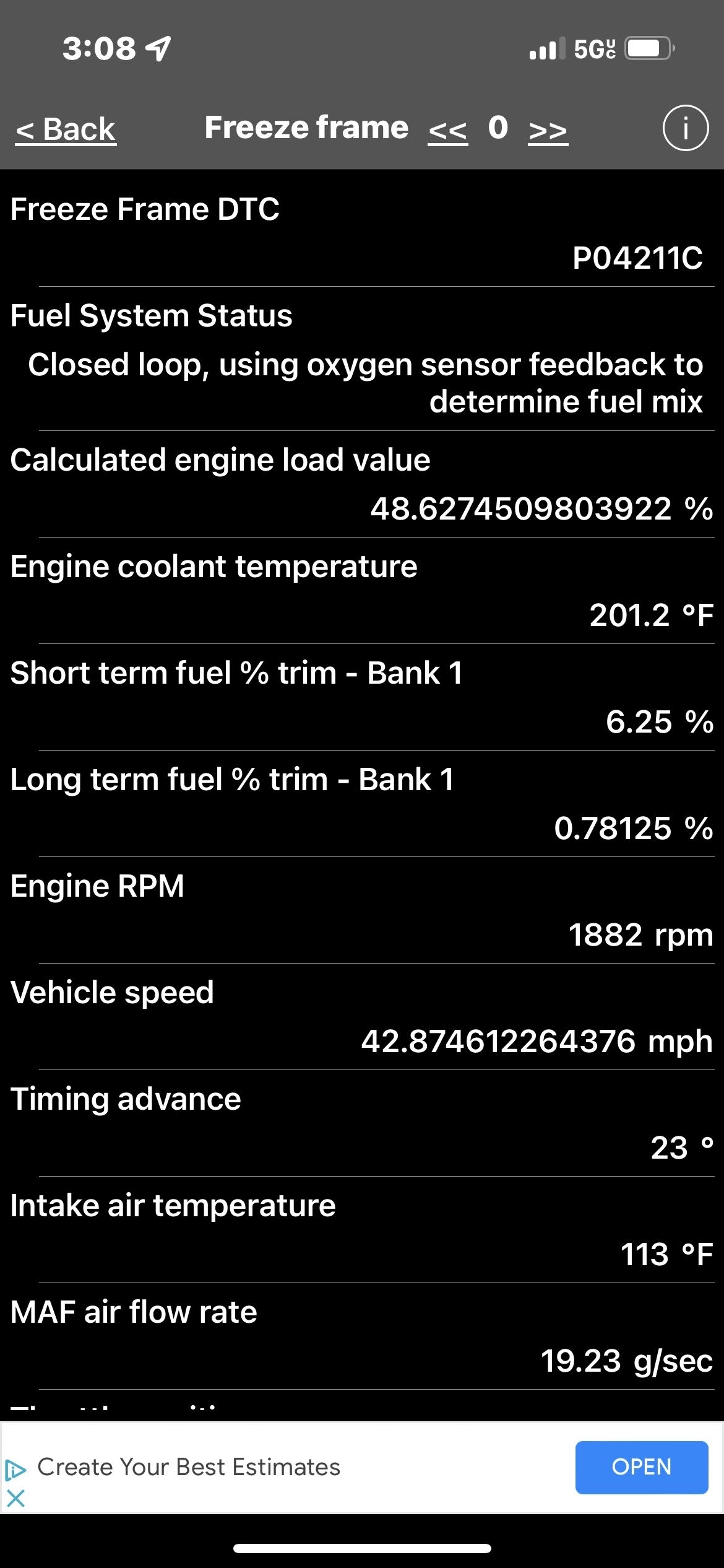

JACOBPAULSEN
  • 64 POSTS

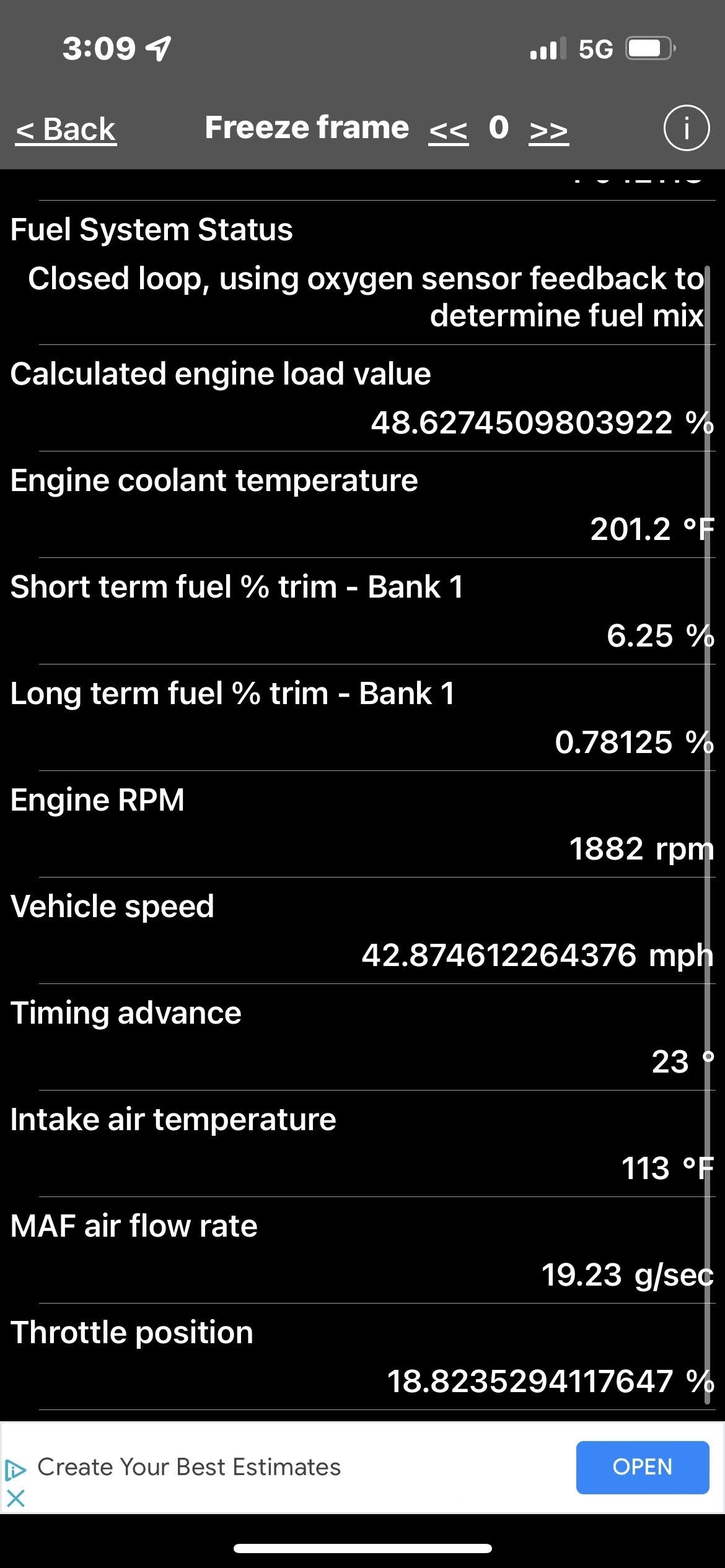

forgot this.
Aug 31, 2022 at 6:50 PM
  • 110,194 POSTS

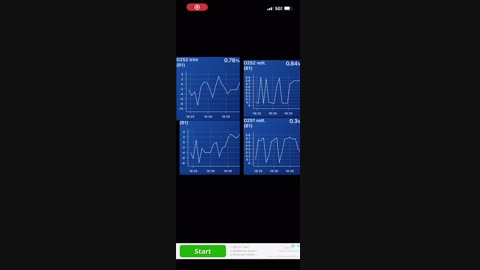

By chance, do you have the voltages for O2S1? I don't like how the voltage is somewhat flatlined in pic 3 above. As far as the fuel trims are concerned, they appear on target.
Let me know if you have that info. Also, the flatline may simply be from driving on a flat surface and not changing the throttle pressure.
Aug 31, 2022 at 7:16 PM

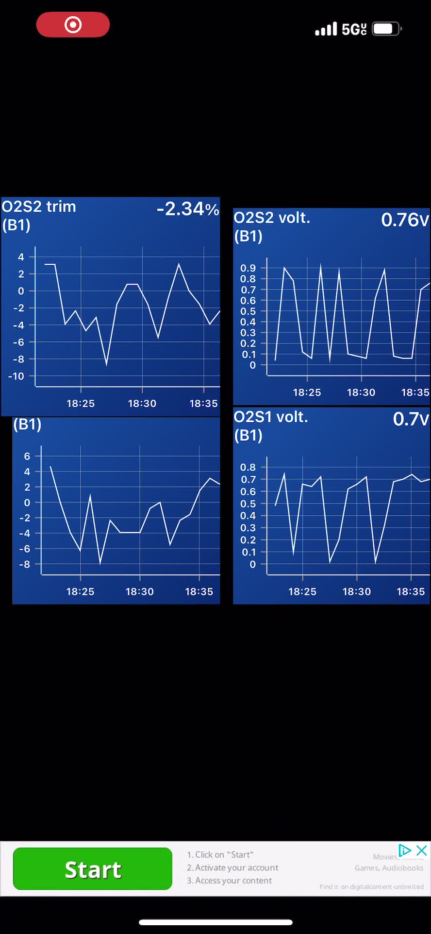

JACOBPAULSEN
  • 64 POSTS
took it around the block.
Aug 31, 2022 at 8:53 PM
  • 110,194 POSTS
I have a feeling it is sensor 1 that is bad. It shouldn't drop to 0v. It should stay between .1 and .9. Double check the connection. I say that because it seems to respond properly other than the drop to 0v.
