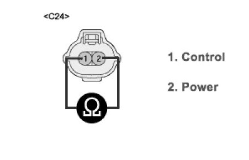

Check resistance of OCV
1. Ignition "OFF"
2. Disconnect intake OCV connector.
3. Measure resistance between terminals 1 and 2 of the intake OCV connector. (Component side)
A. Specification: Approx. 6.8 - 8.0 Ohms at 20 °C (68 °F)
4. Is resistance within the specification ?
YES
1) Go to next step as below
NO
1) Replace OCV and then go to "Verification of Vehicle Repair" procedure

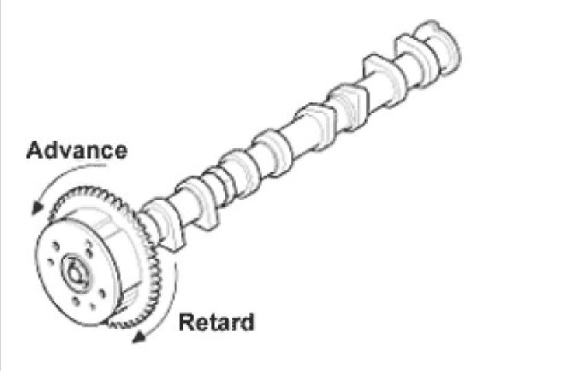

Check CVVT (Continuously Variable Valve Timing) Assembly
1. Remove the CVVT assembly.
2. Check that the CVVT assembly Is locked.

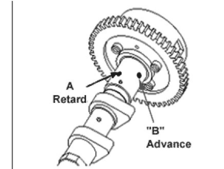

3. The one of the 2 holes on the cam journal is for advanced (upper) and the rest is for retards (lower).
Apply masking tape to all oil path holes except the one advance hole ("B") indicated by the arrow as shown in the figure.
4. To release the CVVT lock pin, wrap some tape around the tip of an air pressure adapter and apply low air pressure of approx. 150 kPa (1.5 kg/cm2, 21 psi) to the exposed camshaft port. Wrap a shop towel or rag around the CVVT because residual oil may leak out of the unit when applying air pressure.
5. With low air pressure applied, turn the CVVT to the ADVANCE direction as indicated in the figure.
CAUTION: If too much air leaks when applying the low air pressure, the CVVT lock pin may not release and the CVVT may not turn.
6. Allow the CVVT assembly to move in the ADVANCE and DELAY directions to ensure there is no binding and that it moves freely. (Movable smoothly in the range about 20 °)
7. Turn the CVVT by hand and make sure it locks in the maximum delay angle position.
