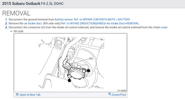

I thought the problem I had with the mess while driving was solved by replacing the plugs, but it came back. So, it seems to only happen when the car is cold. No lights on the dash until this happens, feels like you almost out of gas, couple of hiccups, never stalls or shut off, traction, brake, ABS, and check engine lights all come on. I scanned it and the brake lights came just due to the mess from engine, so it is not it. The engine came with code p0021 for cam. Any suggestions? And where is it located? is it one on passenger side by front of the valve cover? this engine has so many sensors it's hard to pinpoint it.

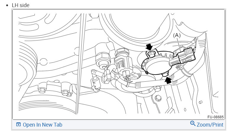

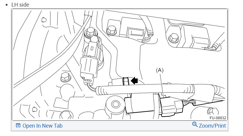

I would remove the intake valve timing control solenoid on Bank 2 and see if the oil screen is clogged, the engine oil must be clean and full as well. Please check the electrical connector to the valve and actuator. Here is more information as well.
The error code P0021 corresponds to a problem with the Variable Valve Timing (VVT) system with the intake valve timing control solenoid on Bank 2.
Check out the images (below). Please let us know how it goes.

I removed and cleaned both sides, both sides are not stuck.
