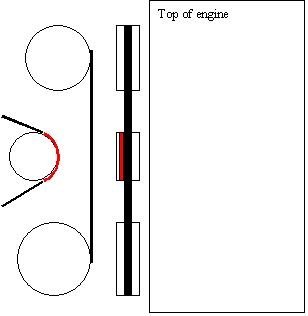

Drove car at high speed on highway for 6 hours. Now engine making noise around the belt. Tried wd 40 thinking it may have been a dry belt problem. Noise didn't stop.
It's not loud but concerning. If it would be a pulley any idea of cost to fix?

Serpentine belts must never have any type of lubricant applied to them. Squealing is usually caused by the belt sliding across a pulley as it goes around it, and lubricants make that easier to occur.
Three things can cause the belt to squeal. The least common is when there is excessive wear on the ribbed side, those ribs may not sit deep enough into the grooves on the pulley to grab it solidly. Serpentine belts are considered ready to be replaced when there's more than one crack across the ribbed side per inch. That almost always occurs before the ribs become worn enough to cause a squeal.
The second cause is a weak spring-loaded tensioner pulley, or one that is rusted tight. I suspect this happens more often to cars that frequently sit for long periods without being driven. This would probably be a less likely cause after driving for six hours.
The most common cause of belt squeal is when one of the pulleys is turned or tipped due to a worn bearing. Most smooth pulleys are painted black, then that paint wears off where the belt runs in that area. Look for a pulley where the edge of the belt is running off to one side a little, and on the other side you can see shiny silver metal showing. Also, sight down from one of the highest pulleys to one of the lowest, then look at those in the middle to see if the side of the belt is peeking out and is visible. This can be rather difficult to judge, but if the belt is off-center by as little as 1/16", that is evidence it is sliding across that pulley or the one right before it, as it goes around it. You can verify this problem by lightly dribbling a little water on the smooth backside of the belt while the engine is running and the squeal is occurring. If the noise changes, suspect a tipped or turned pulley. Those will rarely be a ribbed pulley as those are on things that rarely develop worn bearings. That includes the generator, power steering pump, AC compressor, and crankshaft pulley. Ford has more problems with idler pulleys and tensioner pulleys causing the squeal.
In my sad drawing, the right part is showing looking down from on top of the engine, then on one of the mid-level pulleys, the red area is where the belt is off-center and is peeking out on the side. Remember, 1/16" off-center is more than enough to cause a loud squeal, and this can be rather hard to tell.
