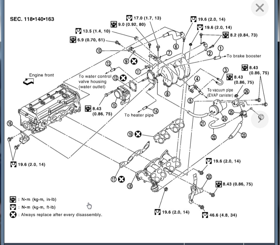

I started my vehicle and my RPMs skyrocketed and then bounced up and down. I put it in reverse and it slammed full speed in reverse and my brakes are barely working. I put it back into park and the RPMs stayed max.
Jun 5, 2021 at 11:06 PM

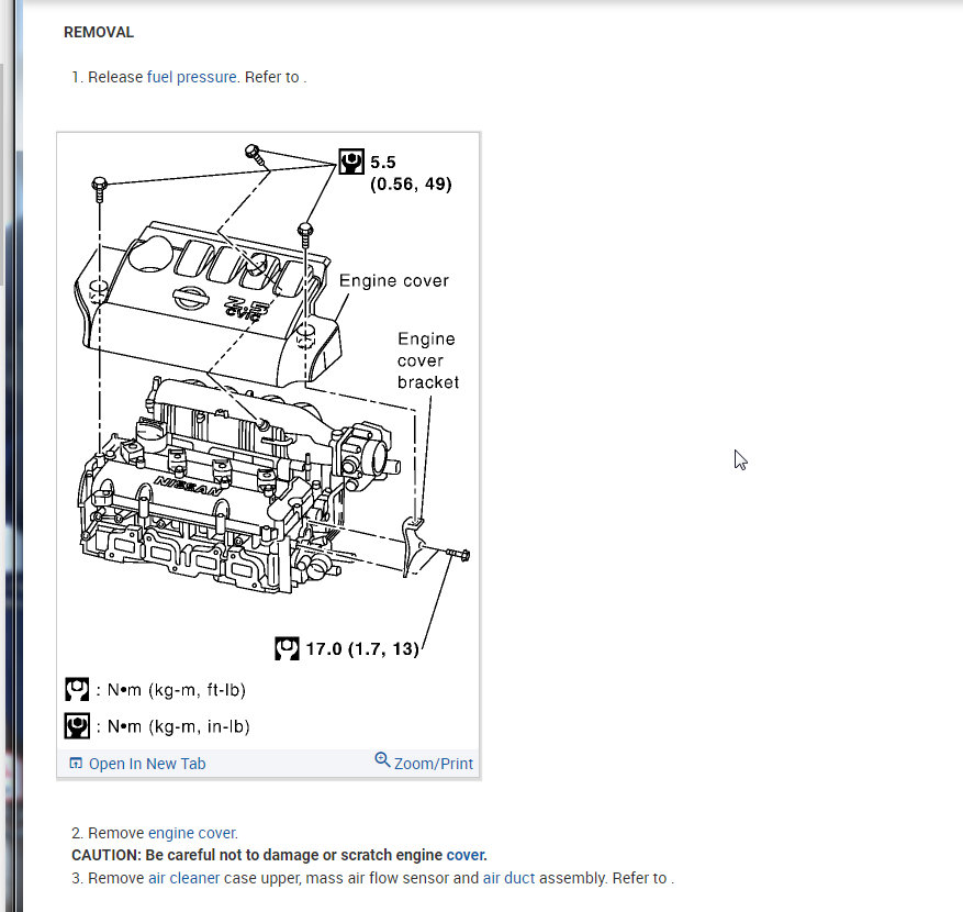

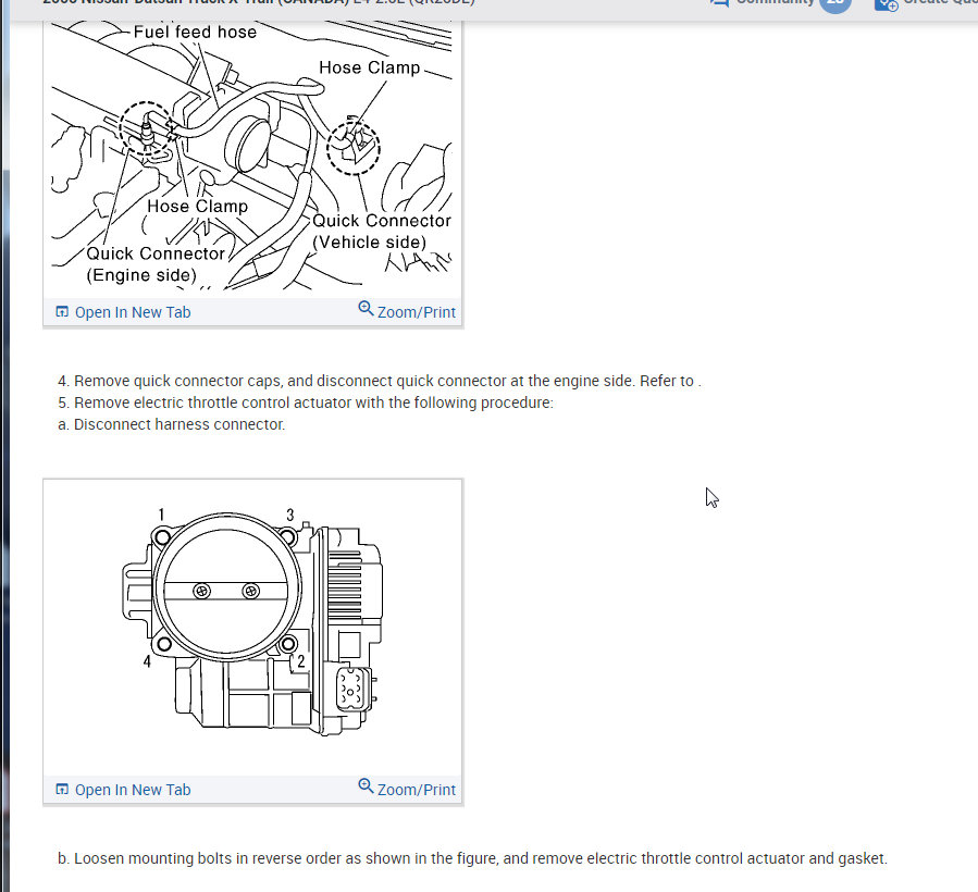

This could be a couple things, but what I would suggest we start with removing the intake tube to the throttle body and restart the engine and make sure the throttle is not sticking.
https://www.2carpros.com/articles/how-a-throttle-body-works
Basically you will see the throttle plate is remaining open and not moving. So if it is stuck open then that is the issue.
I attached the info below on the throttle body but I suspect the cable is the issues and we need to start with making sure it is not stuck open.
