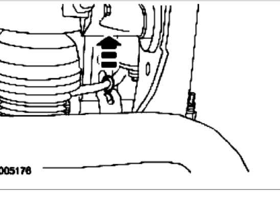

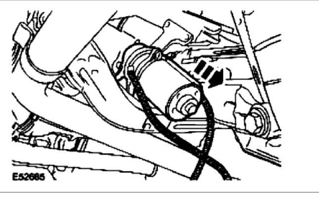

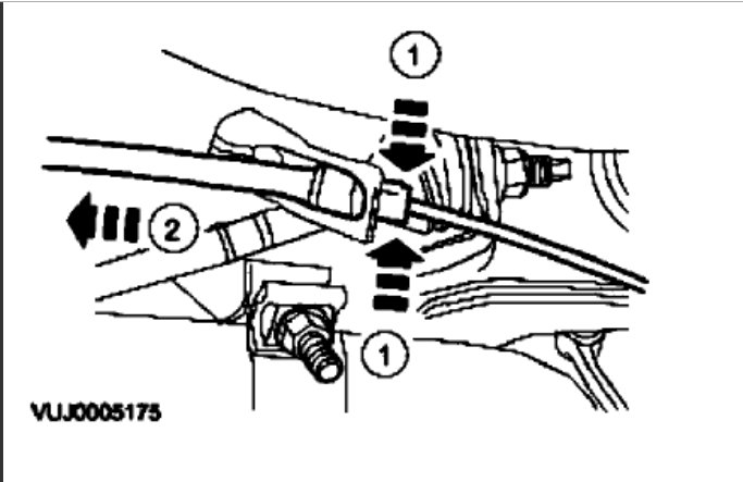

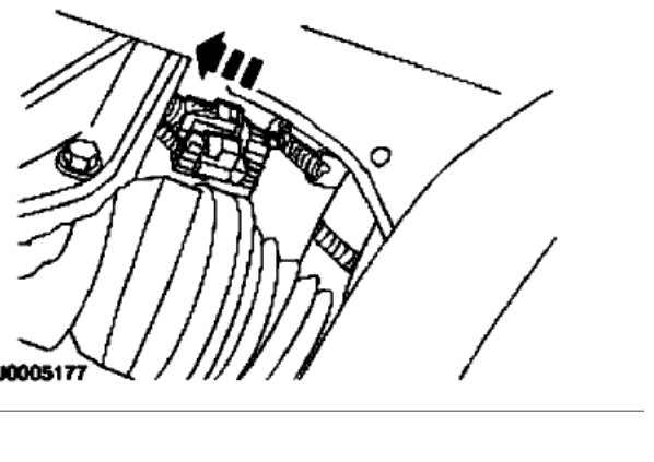

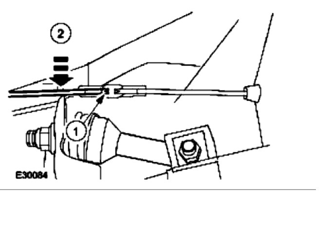

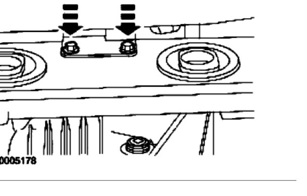

It sounds like the internal valve has a leak inside the APB system. Here are some guides to help you replace the unit and get the car fixed.
