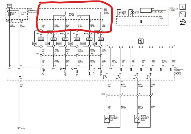

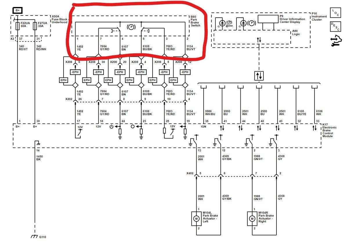

I’m a disabled vet who needs a push button emergency brake to continue driving. I found the vehicle listed above that has this feature but it’s in an awkward place. Is it possible to either move the switch to an area on the center console or simply wire another switch in parallel?
Aug 16, 2023 at 5:03 PM
STEVE W.
  • 15,349 POSTS
It should be possible to make an extension harness and add a new switch in a spot you can reach. I would add the new switch in place of the original. It is not a simple switch though, there are 10 pins on the switch, GM (23386912) so I would likely get the switch and maybe a harness pigtail from a salvage yard and determine where you can mount the switch then extend the wires on the pigtail, so it reaches. I would say you could wire it in parallel but it's a somewhat "smart" switch and one could override the other because of the automatic release of the switch in normal use.
You may want to talk to a dealer about the wiring, there might be an OE solution or at least a harness option that would make it easier to relocate.
