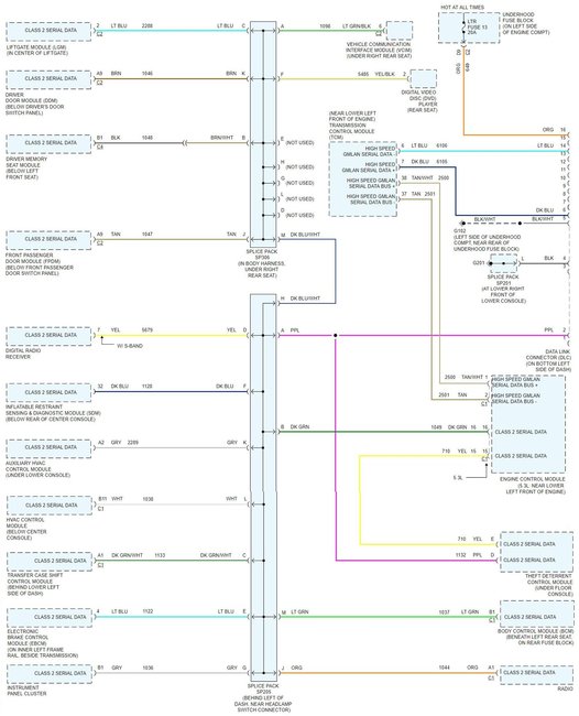

1. The indicator light for theft protection / immobilizer comes on.
2. The battery indicator light comes on.
3. Stabi-Trak comes on.
At the end the engine indicator light comes on and most recently I totally ran out of car on the autobahn.
After 2 minutes with the ignition off, the vehicle listed above started again.
After a few kilometers, the game starts all over again.
Who can help?

Are those lights on at initial start or do you have to drive it a while then they come on. At which point in the cycle of lights does the engine shut off?
From the description it sounds like a wiring harness or PCM issue that is causing it.
Does the theft light stay on solid when you start the truck or does it work normally until the problem happens?
Being essentially a GM Trailblazer with a Saab badge it likely has the same harness issues as it's siblings.
I would start by having a scan tool that can watch the network on it connected up and drive it until it acts up, then look to see what the tool shows, if it is the CAN network dropping out to the dash or to one of the other modules it will usually show up.

Those codes are all network communication failure codes.
U1064 - Lost Communication With Body Control Module
U1192 - Lost Communication With Vehicle Theft Deterrent
This code though suggests where the issue is
U1301 - Class 2 Data Link High
That one shows that at the time of the failure the data line is becoming shorted to battery voltage for at least 3 seconds, that will stop the network from operating and set the other errors because of the short.
The hard part will be that this condition is an intermittent one so testing for it is going to involve putting an oscilloscope or a data monitor on the class 2 data line at the data link connector then monitoring that signal as the fault happens.
Has anything been modified in this truck like an aftermarket radio? or a tracking device that connects to the OBD port?

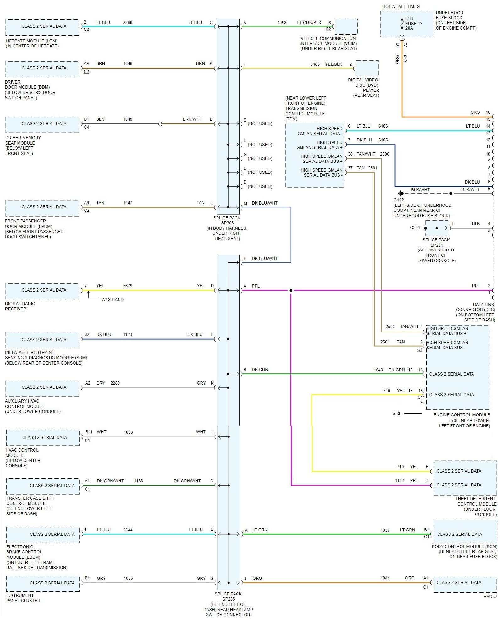

The attached image is the data lines on that truck. Everything that says class 2 data is a suspect. It could be internal to a module or simply a wire rubbing in a door.
To narrow it down will require finding the two splice packs shown. I suggest starting with the one under the rear seat. Unplugging it and then drive around and see if the condition still happens. If it doesn't then look at the items on that side of the network first for a problem.
If you unplug that splice pack and it still happens then you will need to look at the various data modules on the other splice pack. To test those you can do somewhat the same test, namely find that splice pack under the dash and unplug it while watching the network, start the truck up and see if the problem still happens, if it does then look at the theft deterrent module for the problem as it would be the only module still connected to the powertrain control module with that splice pack disconnected. If it doesn't still happen it will be a bit harder. You would need to go to the splice pack connector and remove one of the data line pins from the connector then test drive the truck for failure. This would be repeated for each data line pin. However as you are getting the codes for theft deterrent and stability, I would suspect it is either the theft module or the brake control module. that is causing the problem.
