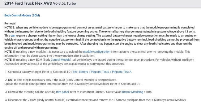

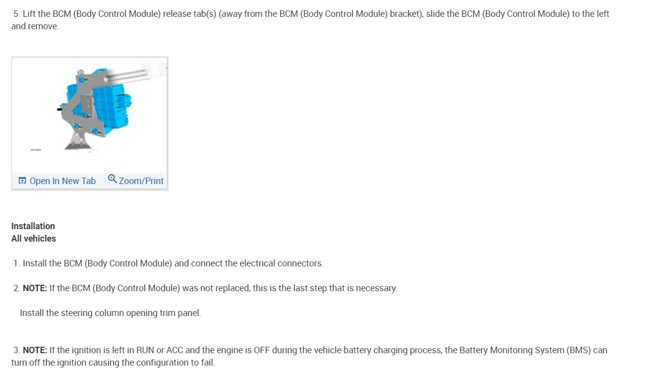

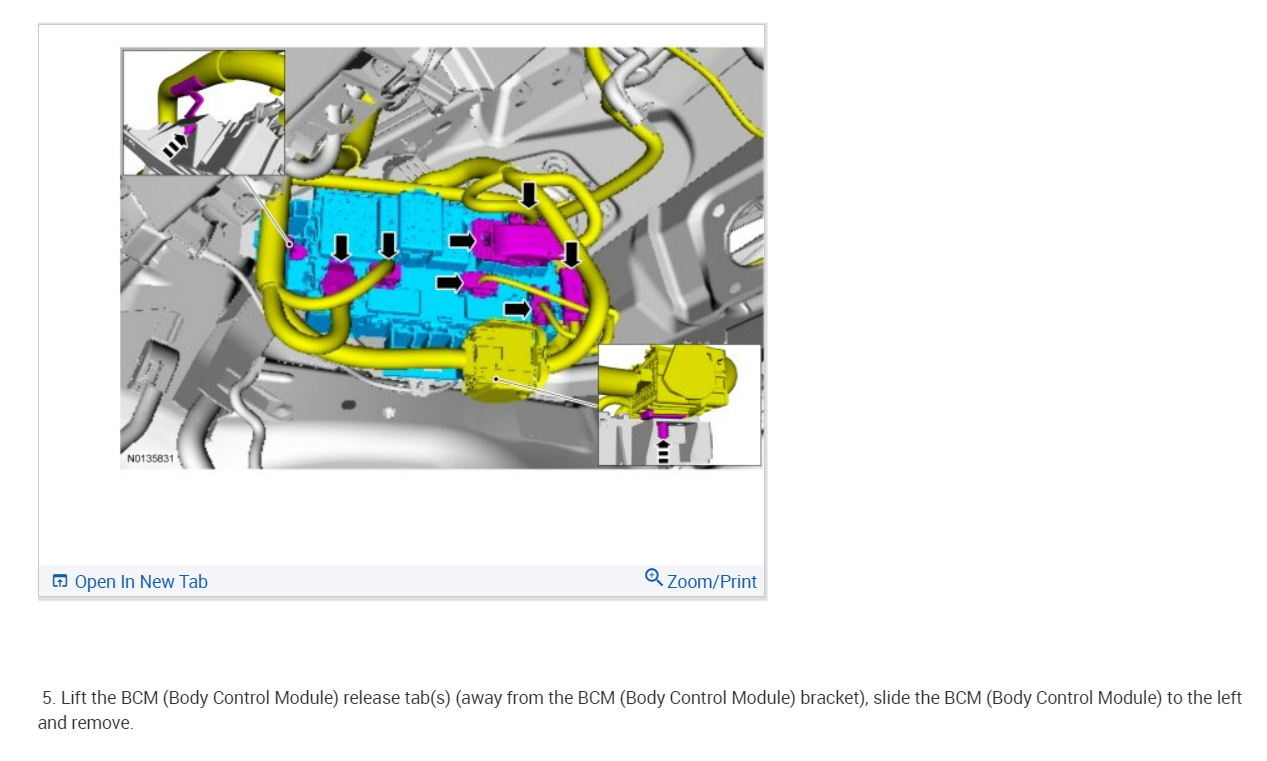

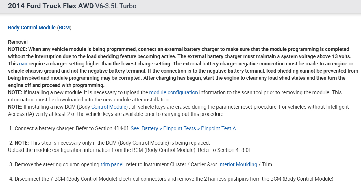

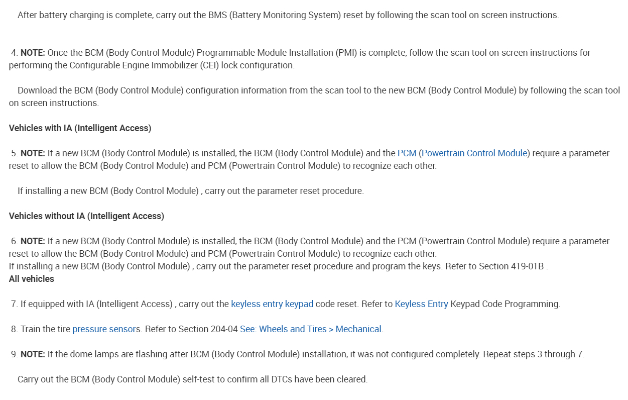

It sounds like the BCM when out when the cables were connected due to a voltage surge. Here is the location of the BCM, you can get a preprogrammed unit by searching Google or Ebay.
