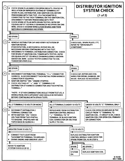

Yeah, i did the starter fluid trick for fuel. I replaced the ICM and distributor cap and still nothing. Are there any sensors or valves that might kamikaze itself?

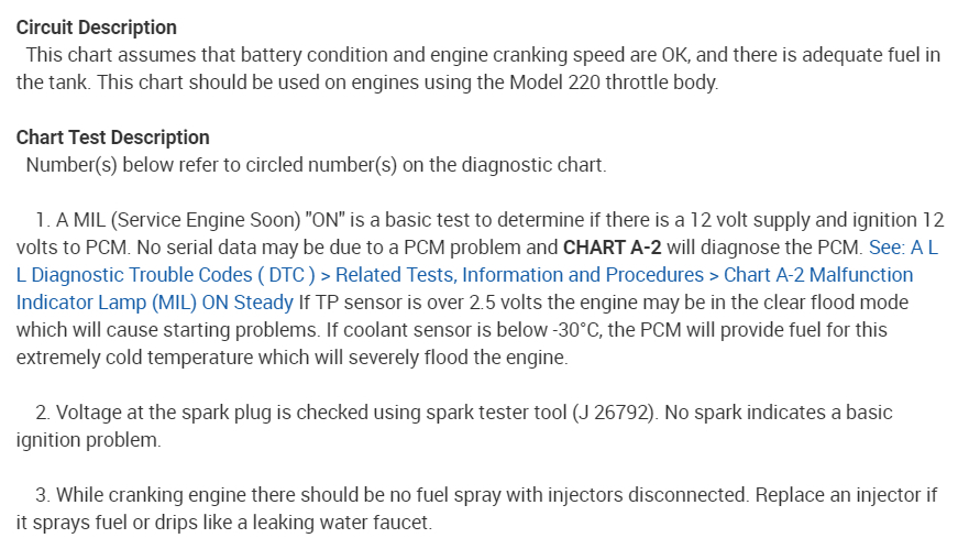

DANNY L
  • 5,648 POSTS
Hello again.

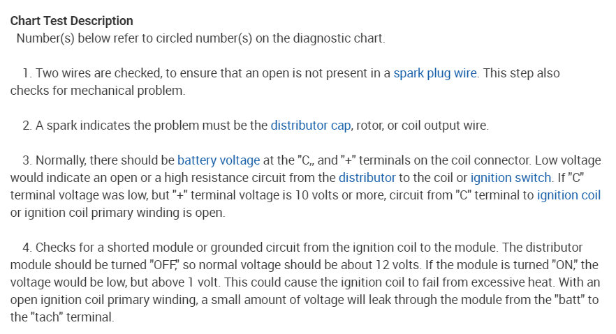

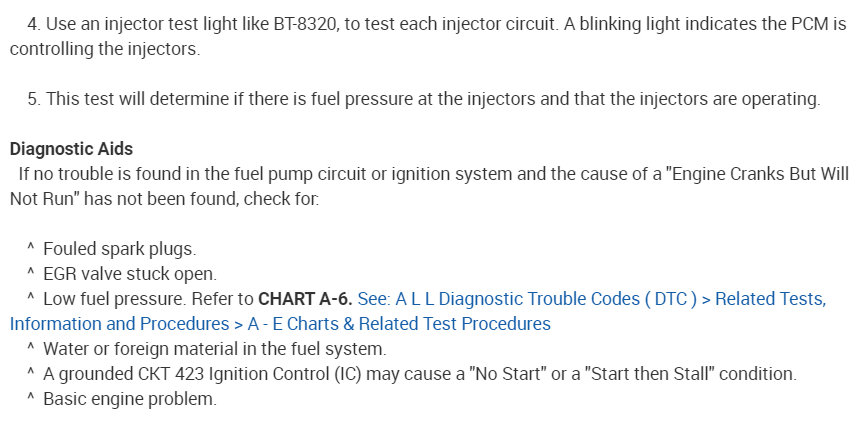

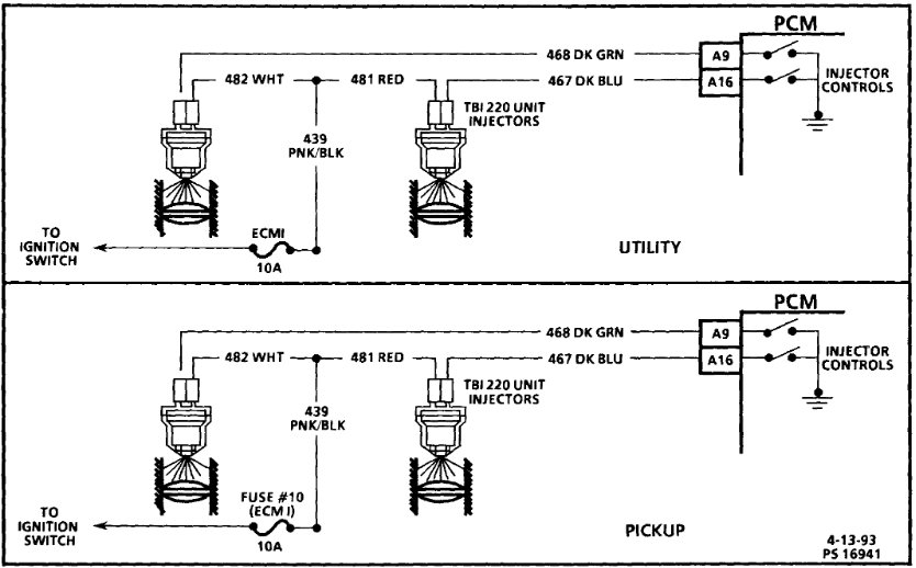

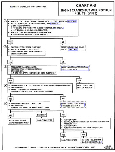

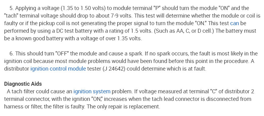

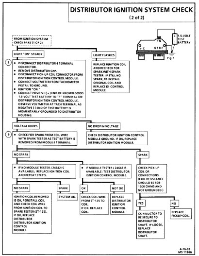

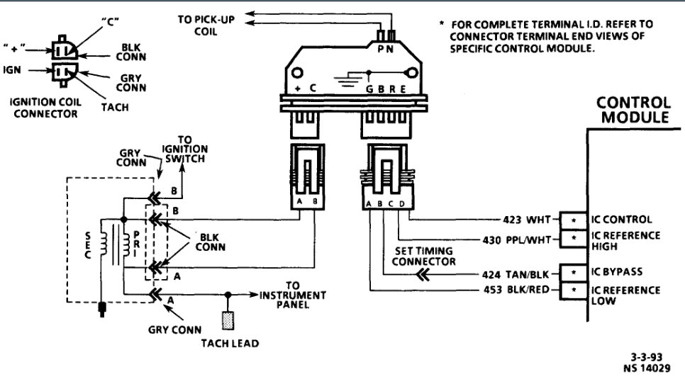

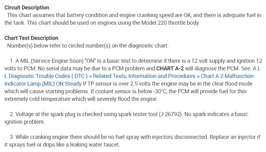

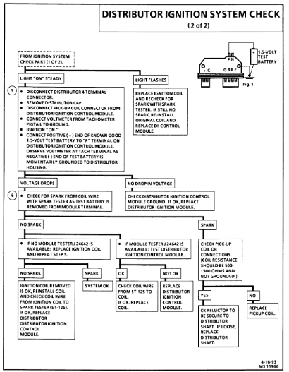

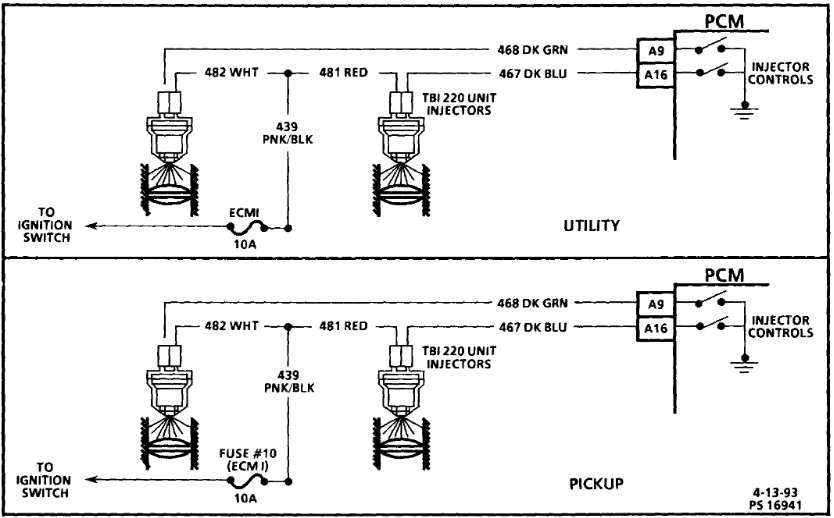

I've attached a bunch of diagnostic flow charts and instructions on how to test for a crank-no start condition. I've also attached the same for distributor ignition system testing which might help more due to no spark condition.They are attached below.Let me know what you find and keep me updated.Hope this helps and let me know if you have any further questions on this issue.Thanks again for using 2CarPros.
