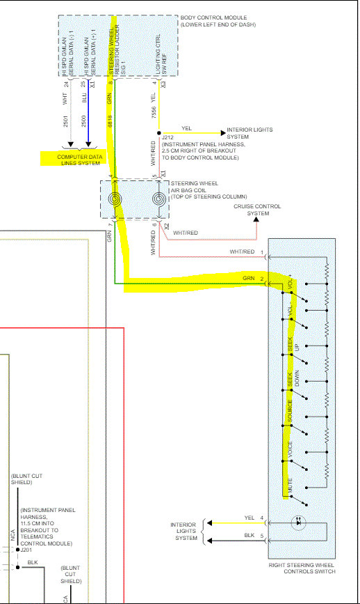

Every button on the right side of my steering wheel (the radio stuff) doesn't work
The left side with the cruise control works, but not that.
My radio shows the display, but not the temperature for some reason, and when my back up camera comes on, only one line shows instead of the whole grid.
I've already checked my fuses, and turned my car off.

I suspect the steering wheel buttons not working is most likely the switch or the clock spring that is under the steering wheel that transfers the electrical signal past the steering wheel.
Here is a guide on this that will explain it in a little more detail. Basically this is a component that allows the electrical signal to stay in contact but also allow the steering wheel to spin. If you had actual wires connecting them then they would get wrapped up around the column and be damaged.

Because of the design, you need to have the can bus system scanned. CAN stands for computer area network. The system uses a few wires to connect several modules. I attached a pic below and highlighted the wires I'm referring to. The problem could be a breakdown of the CAN or the body control module or even the switches.
Here is a video that shows how it's done:
https://youtu.be/InIlnsjOVFA
If there is an issue with a module or the wiring, this should identify where it is.
