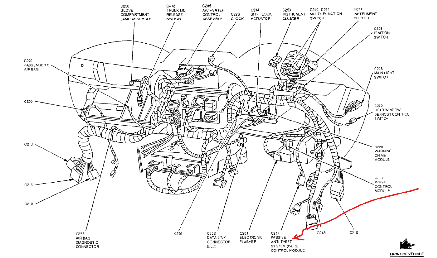

When attempting program, a new key, I cannot erase all keys?
1997 FORD MUSTANG
90,000 MILES • 3.8L • V6 • 2WD • AUTOMATIC
TRULYBLSD
When trying to program a new key for some reason i can erase all keys saved but can't learn new ones. I suspect the gem module but can't find it. Please help, all advice is much appreciated.
Dec 13, 2022 at 6:20 PM
  • 55,256 POSTS
Yep, the PATS module goes out on these cars causing the issue you have described. here is the location of the module so you can change it out to fix the problem. There is no GEM module on this car. Check out the images (below). Please let us know what happens.
Dec 15, 2022 at 3:53 AM
TRULYBLSD
I just so happen to have a Pat's control module from a mustang that is the same year as mine that I got at the junkyard, will it work as a replacement? And thank you for helping me.
Dec 15, 2022 at 2:28 PM
  • 55,256 POSTS
Nice! that should work do you have the key from that car as well? They need to be programmed together.
