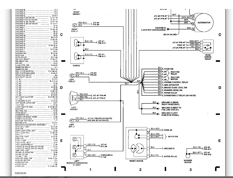

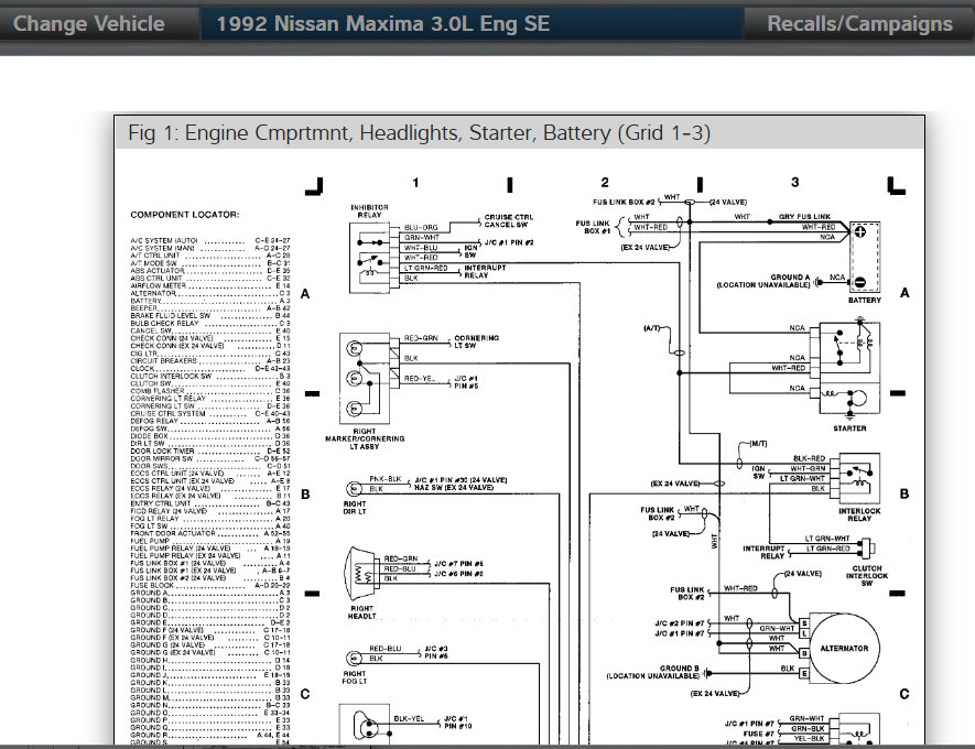

This could be a problem with the alternator not charging the battery. Double check all of the connections at the alternator and the battery. Make sure they are all connected, clean, and tight. Also check that the serpentine belt has the proper amount of tension on it. A loose serpentine belt will not spin the pulley at a high enough speed for the proper amperage output to charge the battery. Finally, if none of those are the problem, you could have purchased an alternator that is bad right out of the box. It wouldn't be the first time, nor, unfortunately. the last time that that would have happened. In the diagrams down below I have included a wiring diagram of your vehicle's charging system for you for reference. Please get back to us with what you are able to find out.
Thanks,
Alex
2CarPros
