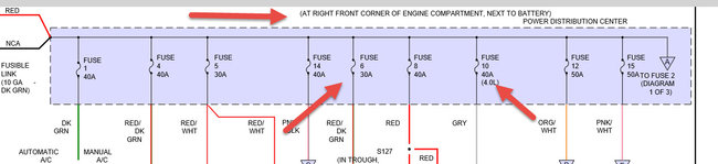

My brake light, the two in taillight assembly do not work. Checked both fuse boxes and they are good. checked bulbs all good. cleaned the bulb assembly connections with small wire brush (with battery still connected) and that got them working. The problem is now since i fixed that the A/C, the coolant fan, and the blinkers quit working. What did i do? I have 6, 10amp fuses not working on inside fuse box. And the fuses are good. How could cooling fan, ac, blinkers all quit at once? And 6 fuses not be getting power at all

because a more main fuse that supplies power to those areas either burnt up or your fuse box has a problem. remove fuses and check for corrosion on them they may not be making contact. see pic also check fuse 15 in pic that supplies another area of truck

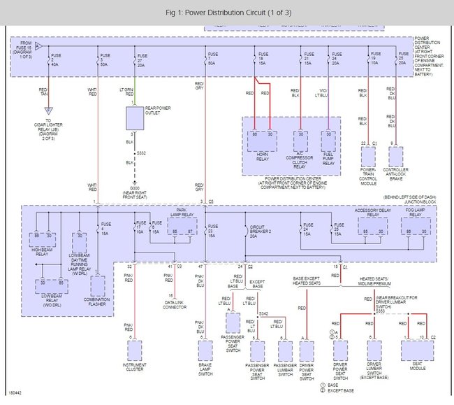

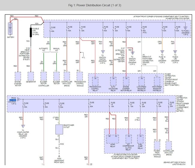

All fuses and relays good. I must have wiring or connector problem. I really need my blinkers working first. I wanna run new wires mtself but not 100 percent which wires or what color.....or from where to where they actually go. How should i go about running new wires for these blinkers.

Hey JEREMY,
Here is a power distribution wiring diagram so you can see how the power is routed. Use a test light and do some testing to see where you are loosing it.
Please run some tests and get back to us so we can continue helping you.
