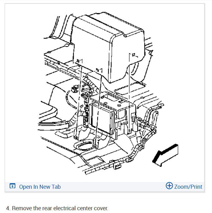

Why are the cluster and dash lights staying on when I shut off ignition?
193,000 MILES
PIPPIN1

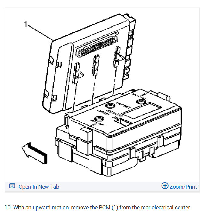

Cluster and dash lights stay on when I shut off ignition.
Jan 26, 2025 at 10:38 PM
  • 55,628 POSTS

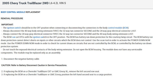

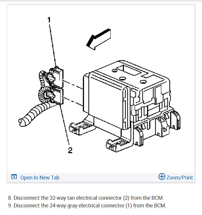

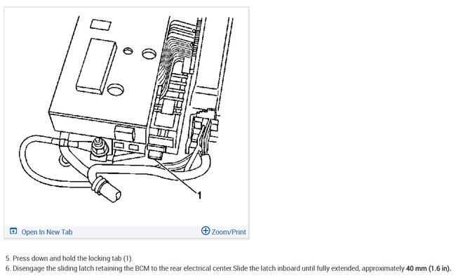

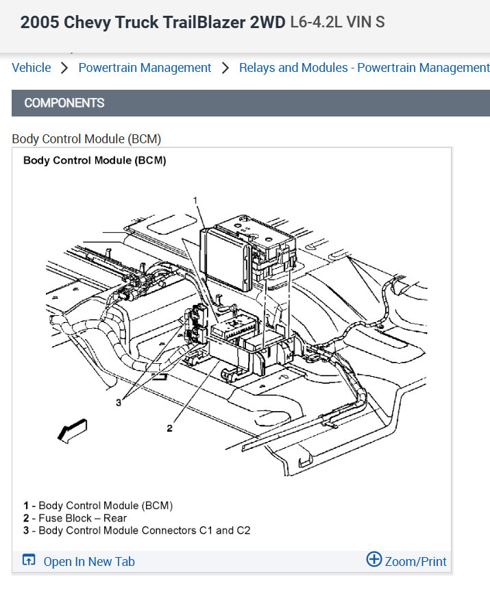

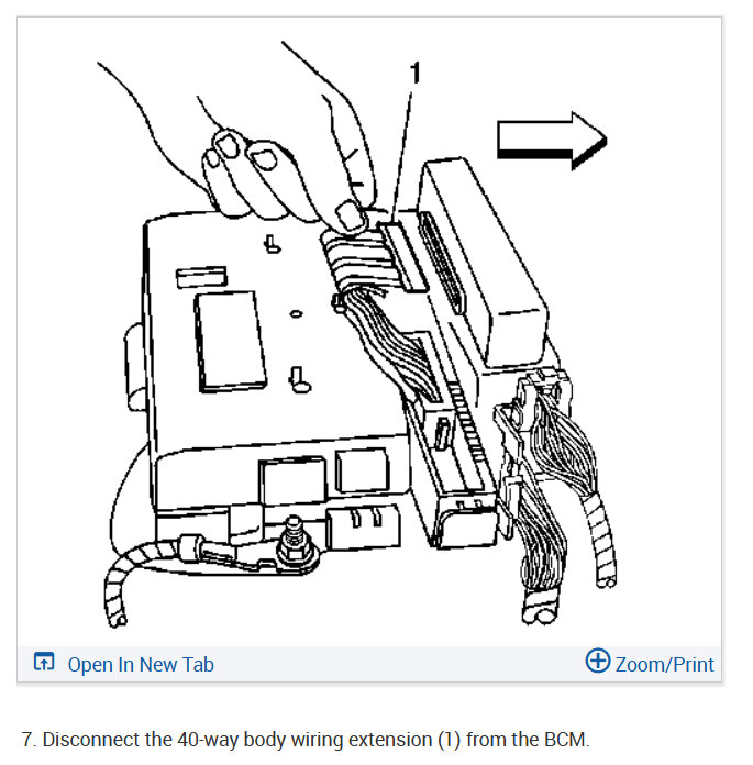

Yep, that would be a BCM error, so it sounds like the BCM is bad. I would do a CAN scan to be sure. You can get a CAN scanner (Controller Area Network) which will work on most cars from Amazon.
https://youtu.be/u-4syLc-ifQ
Here is how to change the BCM out, you can get a preprogrammed unit by searching Google or Ebay. Check out the images (below). Let us know how it goes.
