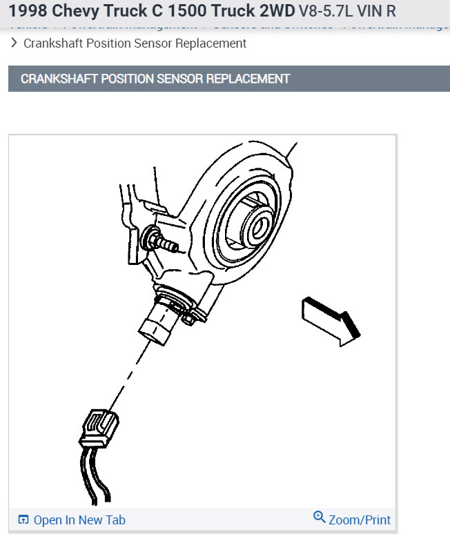

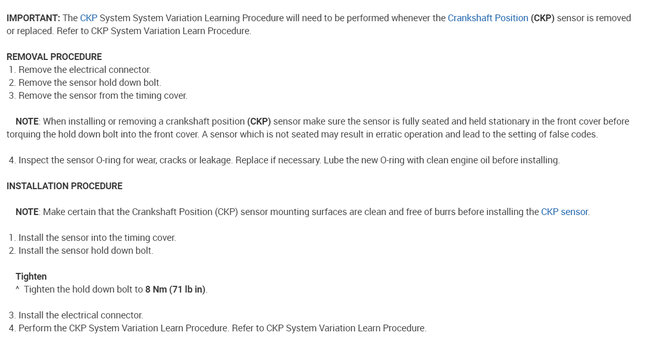

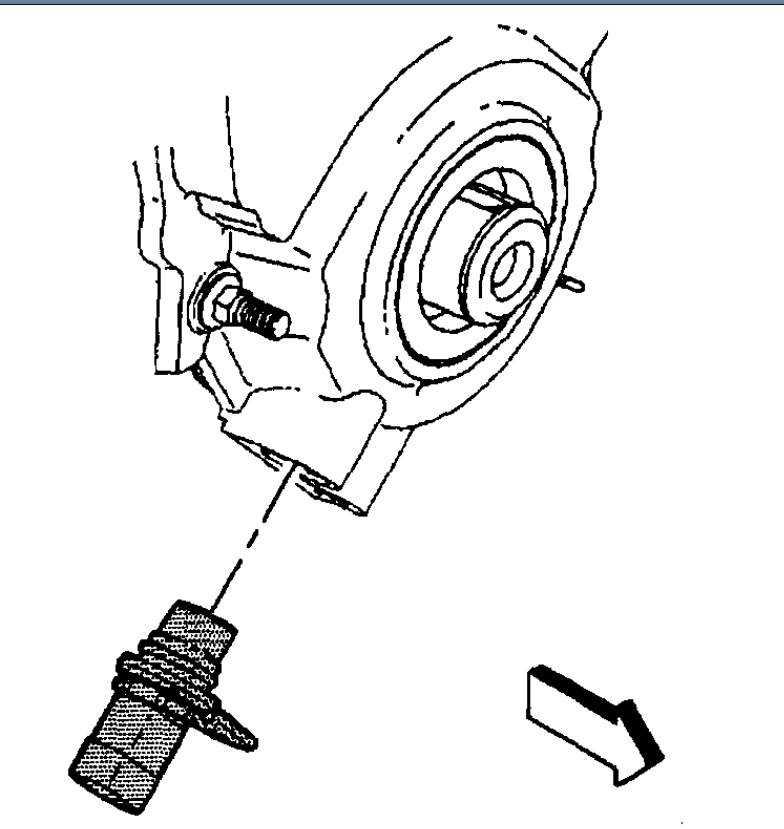

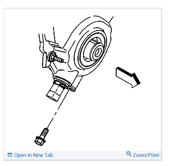

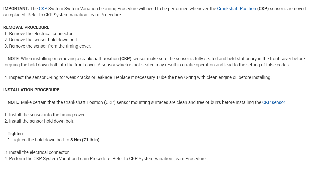

I have already replaced camshaft and crankshaft sensor last year, but the code was stored in the memory. That’s why I tried to erase them and when I did it shut off the truck and now it won’t stay running. It starts for about 2 seconds then shuts off.
Jul 16, 2023 at 3:33 PM
  • 54,832 POSTS
So, the P1345 code is for the crankshaft sensor so you may have a defective part. Is the security light flashing?
Here is more information on the codes:
P1345: This code refers to a problem with the crankshaft position sensor (CKP) or its correlation with the camshaft position sensor (CMP).
P1153: This code is related to the oxygen sensor (O2 sensor) on Bank 2, Sensor 1.

This issue I’m having is to do with fuel I have already fixed the crankshaft sensor problem. I had to replace the timing chain cover cause the sensor kept pushing out under load. The problem I’m having now I believe the computer is shutting off the fuel pump right after start up. I can keep the truck running with choke cleaner, but it shuts off as soon as I stop spraying.
