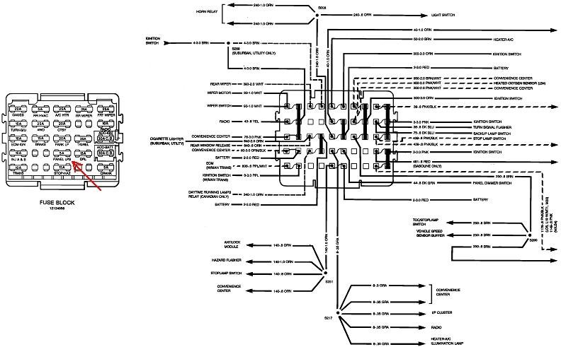

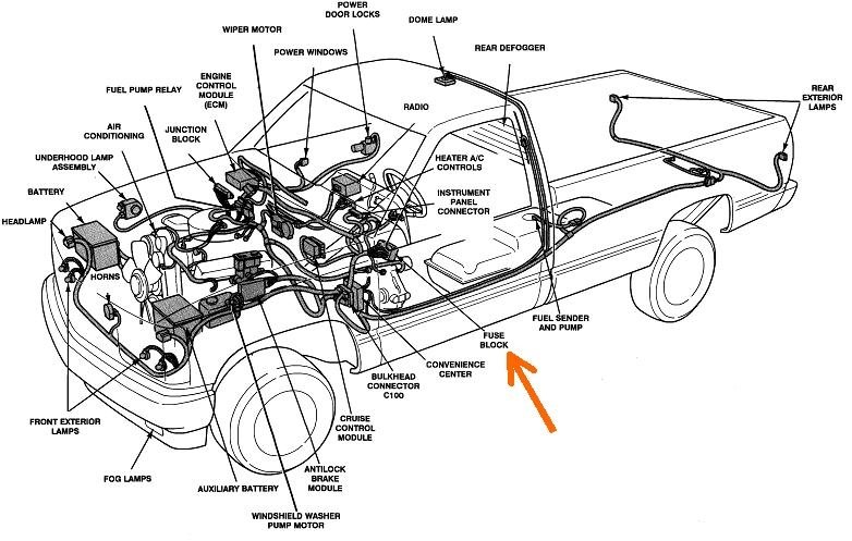

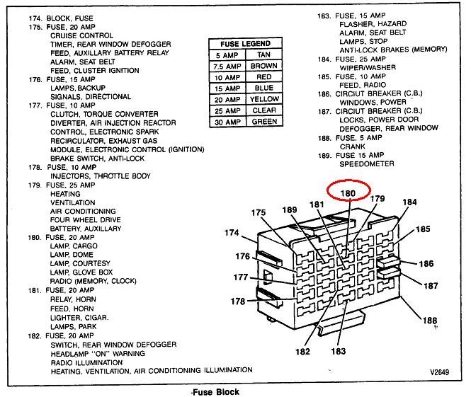

I think where I'd go next is to the inside fuse box and measure the voltage on one or more fuses for the problem circuits. I circled the fuse for the interior lights. The second drawing is for the fuse box and its wiring. I apologize the writing is so small. I had to copy and paste it into an MS Word document, stretch it as much as possible, then click on "200 percent" to make it large enough to read. Fortunately the print remained clear enough to read. The red arrow is pointing to the five-amp instrument cluster fuse.
Sometimes digital voltmeter readings jump around and can be hard to see this type of problem, so you might have better luck with a test light. We're hoping to find it flickering along with the other lights in the truck. All of these spade-type fuses have two tiny holes on top for test points. We aren't in need of testing any fuses, but this article has photos that show these fuses and where to take the voltage readings:
I strongly advise against removing any fuse from its socket. We know they aren't burned open because none of the circuits are dead. We need the problem to keep on occurring so we can narrow down the cause. Moving and wiggling on things might make a bad connection work for a while, then we'd have nothing to look for.
Specifically what I have in mind is around this time, GM was experimenting with aluminum wires to save on cost, and one problem area they did that was where the aluminum wires are riveted to the brass "buss bars", (connecting strips) in the fuse box. One corroded wire can be feeding two or three fuses. The fuse box is right in the area of your feet, where salt can get dragged in. Salt is an acid. Two different kinds of metal and an acid is how a battery develops a voltage. That same "galvanic action" causes corrosion, particularly of those aluminum wires. On the last one of these I worked on, you could see sparks at the bad connection when the wires were wiggled in the dark. This one happened to be for the tail lights.
Those aluminum wires could be identified by their translucent insulation. They are colored, but you can see the wire through it. It is never acceptable to poke a hole in a wire to take a reading, but that applies even more with aluminum wires. With copper wires, the moisture that gets in through a hole will lead to corrosion real soon, and a crumbling wire in ten to 15 years. A hole in an aluminum wire will lead to corrosion and crumbled powder in a few weeks.

That sounds like a power booster problem, but it gives you a dandy place to be looking. Also look at the terminals in the bulkhead connector. Sometimes water drips down there and sneaks inside, leading to corrosion.
