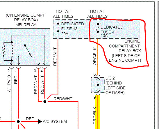

radio, clock, interior lights went out. Central lock only works with key on. I replaced all fuses..But car now fails smog test. Tech reset ECM and won't pass now. I purchased a scanner to check for readiness, and after I get them all ready, as soon as I shut car off and disconnect scanner, ECM reverts back to not ready... Please help...Need to bring it back through emissions soon.
May 25, 2020 at 9:23 AM
  • 110,251 POSTS

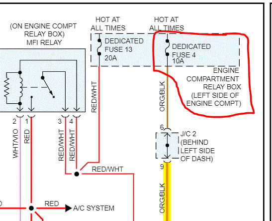

Either there is power loss to the PCM or the PCM no longer holds memory. Do me a favor. Take a look at the attached portion of the wiring schematic. Check the fuse I indicated. That fuse provides power all the time to the PCM. Make sire it is good. The only way this should be happening is if the codes are being cleared by the scanner or if the battery is disconnected (power loss).

Hello. After looking at the diagram, not sure what fuse your indicating. I did change all fuses in car with the fuses that light up when blown. My car did recently have work done, throttle body and idle valve cleaned and PCM cleared or reset. I've used a scanner and have done road test and actually had all monitors ready. I shut car off, unplug scanner, remove key and if I try right away, still good. But after a minute or 2, monitor revert back to not ready. Again, all fuses have been replaced unless there's one I'm not finding or maybe a relay. Just frustrating as time for recheck is approaching quickly. Thanks for your help.
May 26, 2020 at 6:04 AM

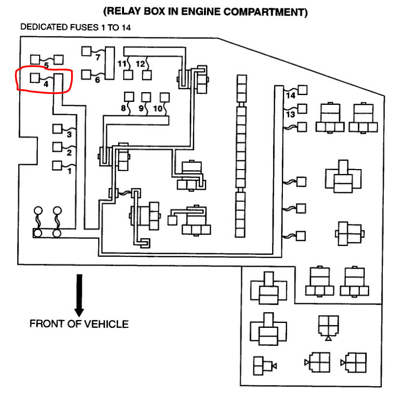

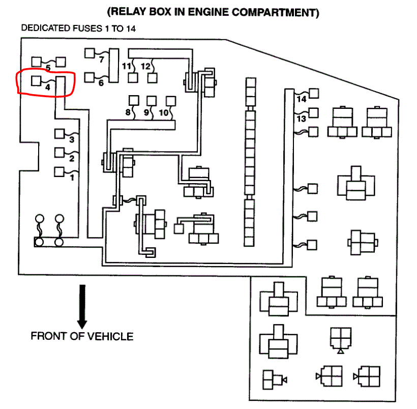

  • 110,251 POSTS
The PCM should have power at all times. When power is lost, so are the readiness indicators. To the best of my knowledge, fuse 4 is the one that provides constant power for the PCM. Take a look at the pic and let me know if it helps.

STEVE GRASSINI
  • 11 POSTS
I've replaced them all. Everything was working good 1 night, and next night, no dome light, clock, radio, and central door locking issue as well as car wanted to stall at stop light once car was warm and not on high idle. All happened at once. Tech said he cleaned parts I mentioned earlier and said he cleared PCM, but doesn't remember if there where any codes. No check engine light was ever present. I have read others have had this issue, but none so kind as to post resolve if any. I'm getting nervous now...

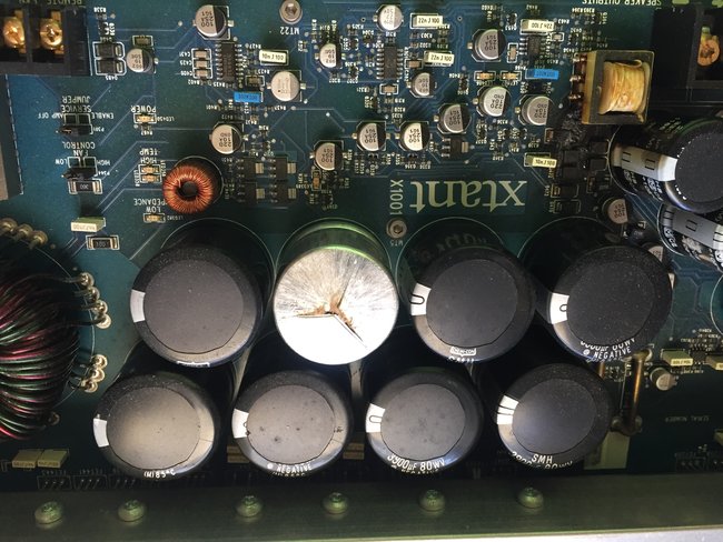

I have another thought after reading an article earlier this evening. A few weeks before my problems stared, I had an Xtant X1001 amplifier burn up on me when car was left warming up. I came outside to find a burning smell and when I entered the car, a few seconds later a loud pop and tons of smoke from amp. I pulled amp out immediately. Drove car and it was fine. (Car is hardly ever driven as it's our once in awhile ride.) So a few weeks of no driving and I decided to put an old school power hungry amp back in it's place and all was working good... One night I decided to take car to store a few mile at best...all was good... I came home music blasting. Everything was good. Next day, problems as stated earlier in post started....boom just like that....no radio, clock, dome light, and central doors on work with key on...also found out once car was warm it wanted to stall at stops. I since removed that amp also, and added a newer more power friendly amp...and rewired my stereo memory power to horn fuse and all is good with sound system...Sorry for the lengthy post but trying to give U everything in a nutshell... My question here is, I read that.. When the alternator diode pack fails it can leak AC voltage which can cause disruptions in the electrical system including causing premature battery failure. It can also cause other electrical components such as the radio and gauges to act strangely. Could this interrupt PCM?? I was thinking if I had a diode pack problem and AC voltage went into the battery, could that have burnt up my amplifier? It has a large 60 amp fuse straight from battery going to amp and maybe a small amount of AC current made it's way through fuse and into amp. Whatever the case, the amp was destroyed beyond repair...(Blew a large capacitor and burnt some off the board. Please lend your thought. This is the damage to my amp.

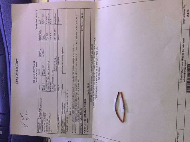

STEVE GRASSINI
  • 11 POSTS
As promised, here's the update: please share with whomever has similar issues. 2 broken wires in harness the runs through left fender. No dome light, clock, radio. and central locking issue. Also, it would not pass emissions for readiness monitors because the ECU wasn't getting power. The tech found issue within an hour 27 years with Mitsubishi.. So now the car runs perfect and shifts better as well (was shifting a little funky,) flare between 2nd and 3rd. Well that's it. Back to good. I've attached pics of wires.
