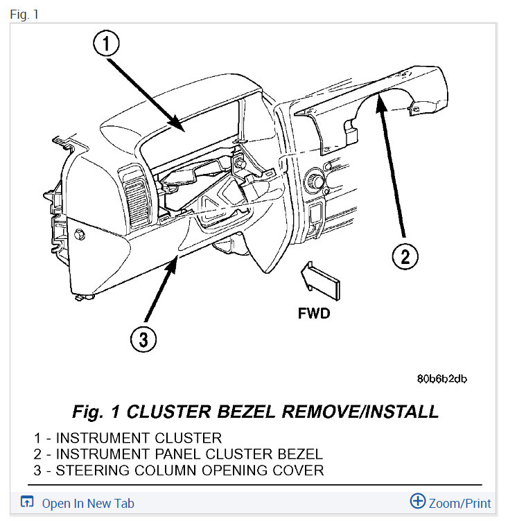

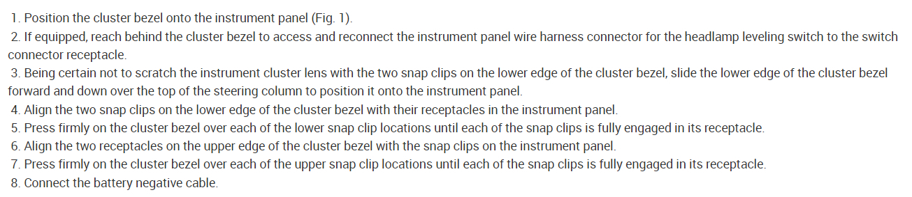

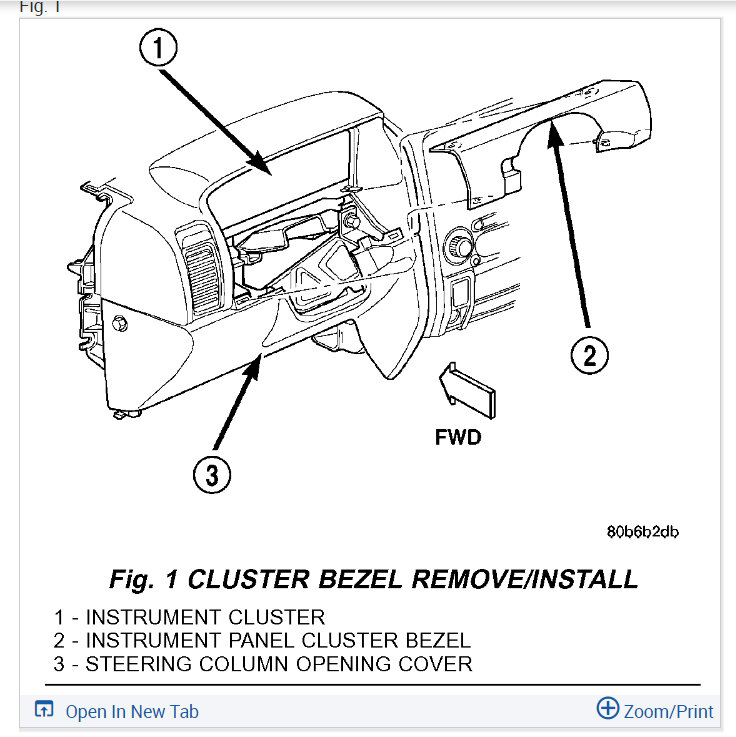

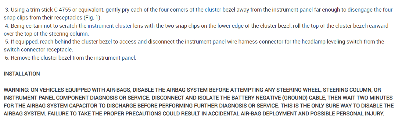

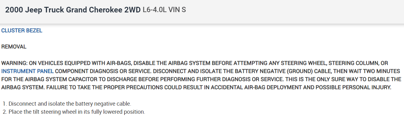

I have seen the instrument cluster cause this issue, it has a short in the circuit board but to be sure let's unplug the cluster and start the engine to see if there is any change, here is how the job is done. Check out the images (below). Please upload pictures or videos in your response to any problems so we can see what to help you with.

I unplugged the cluster and the issue persists.

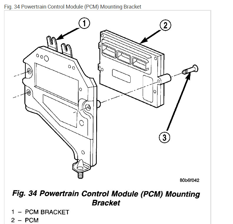

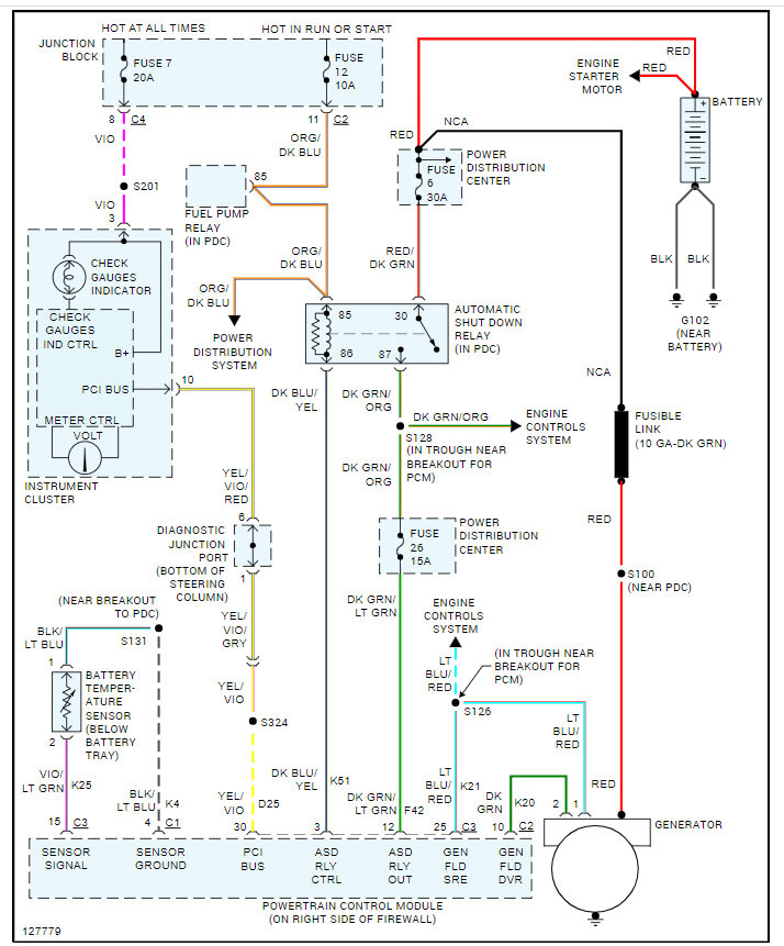

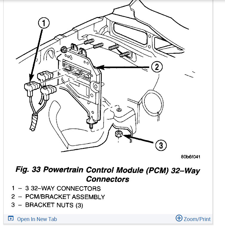

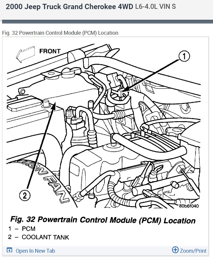

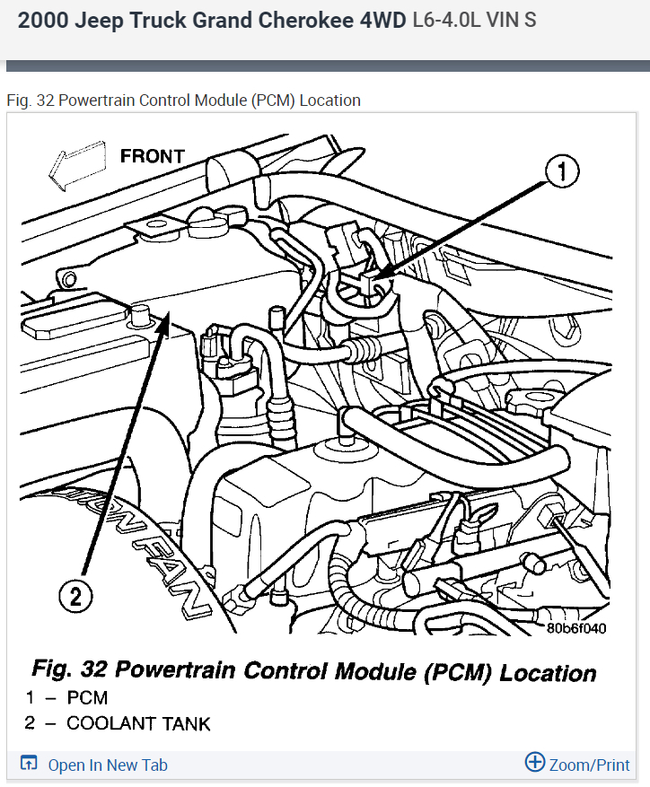

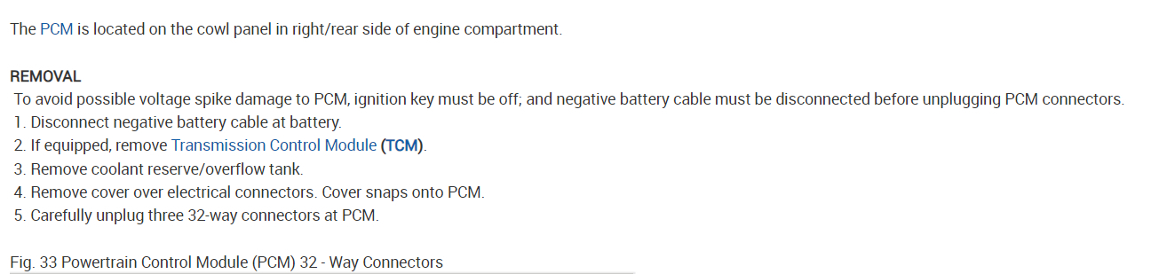

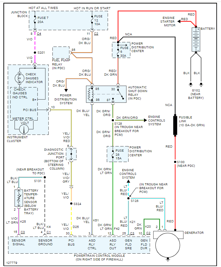

Okay, so when the engine is running good without the alternator plugged in correct? Can I ask if the alternator is charging? this guide can help you.
If the alternator is not charging I would check the fuses which are mentioned in the alternator wiring diagrams below. If they are okay it sounds like the PCM is bad. You can remove it and send it into a rebuilder for testing.

Engine runs fun with the field wires unplugged. Plugged in it gets really rough. Took a multimeter reading with alternator plugged in and it was reading upwards of 17-17 volts. As soon as i unplug the alternator again the jeep stalls out. Did an ohms test on the fuses and had zero resistance, plus they looked ok visually.

Unsure if this is out of spec or normal but i did an ohms test on the ground field wire to the pin on black pcm connector and had zero resistance. With the connector plugged in I did an ohms test on the ground field wire to the negative battery post and get .350
Appreciate you're help. Thinking im gonna need to send the PCM in to get repaired. What are your thoughts on possibly trying an external voltage regulator, if that's even the issue.

17 volts is too high, so you have found the problem. I would swap out the PCM which controls the alternator. Please let me know how it goes.
