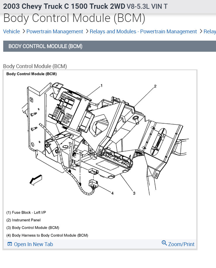

All my gauges quit working. we tested all the fuses unplugged wiring harness plug it back in and everything started working. Now you turn on the left turn signal and step on the brake it blinks really fast and the cruise control quits working. Let your foot off the brake the blinker blinks fine cruise control can be reset. Now the gauges have quit again. what is my problem.

It sounds like you have a fuse out on the BCM. To be sure lets use this guide to check for power using this guide and the BCM location below:

We checked all fuses that we could. There are black ones that are factory with no viewing port. All checked good. Is there a fuse on the BCM? The gauges are now working but the left turn signal still blinks fast with foot on the brake, blinks normal without brake pressed. Cruise still will shut off if engaged when left signal is turned on, but has no affect on right signal

Yes there are fuses on the BCM I would check those first.
