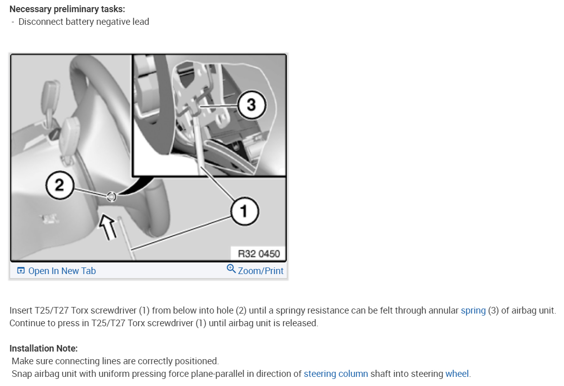

While driving the horn went off and would not turn off
2004 BMW 530I
130,000 MILES
JANELLEB410

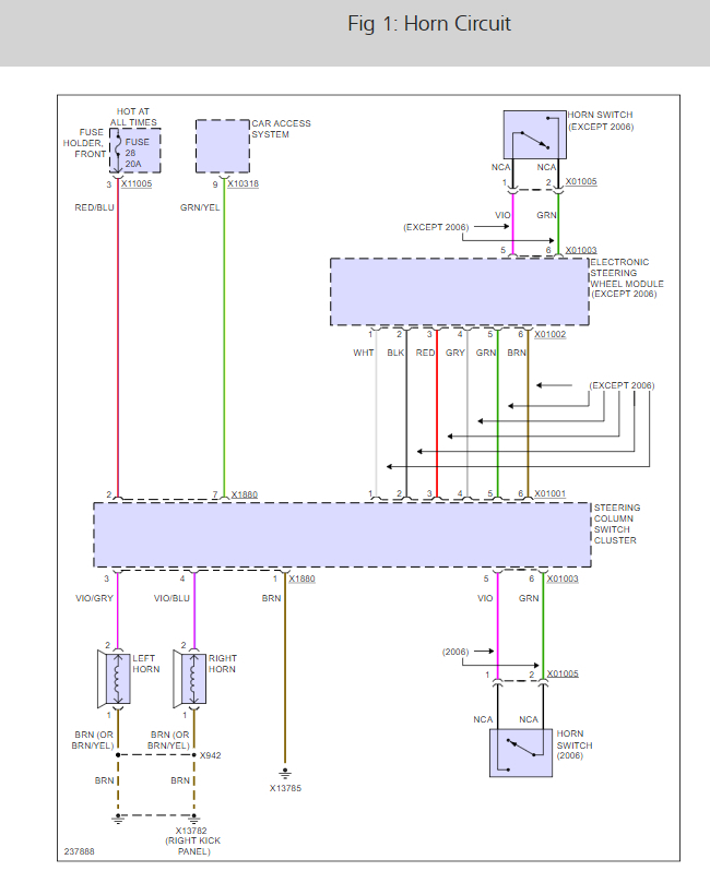

I was in the middle of driving and all of the sudden my car horn went on. The horn stays on unless I put the car in park and turn it off. As soon as I turn my key to turn the car back on, the horn starts up again. How do I get it to turn off?
Feb 17, 2019 at 2:46 AM
  • 55,433 POSTS

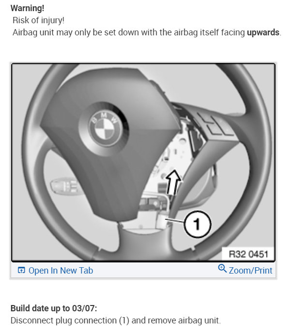

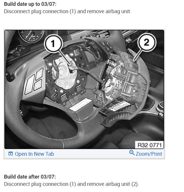

It sounds like the horn switch in the pad is stuck on but to be sure lets remove horn pad to remove the wires. Here is a wiring diagrams so you can see how the system works in the diagrams below and a guide to walk you through the steps:
https://www.2carpros.com/articles/air-bag-removal-steering-wheel
