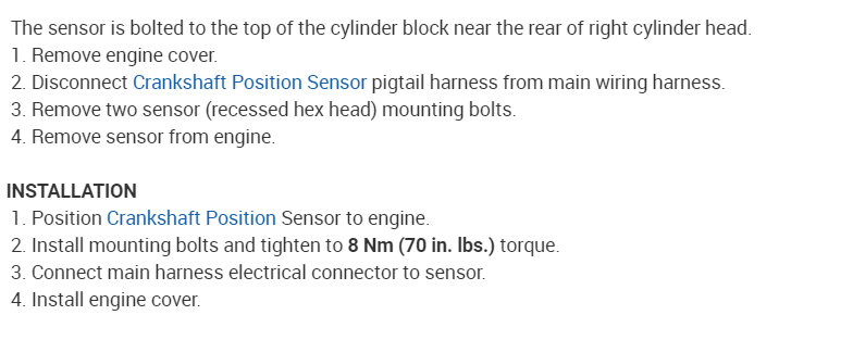

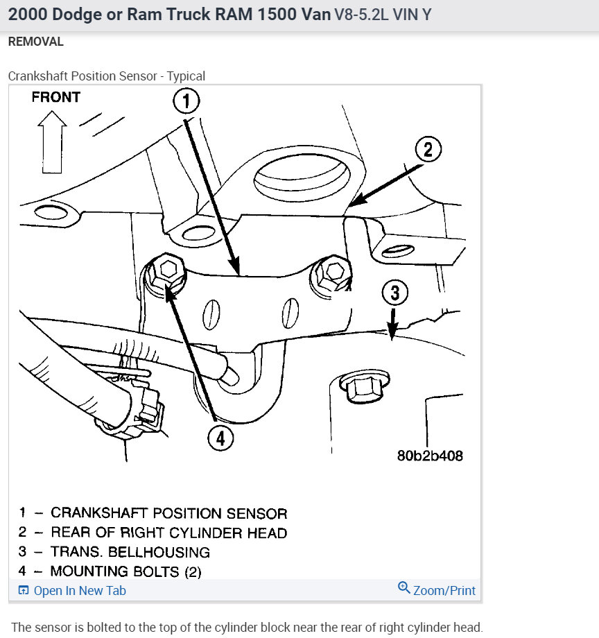

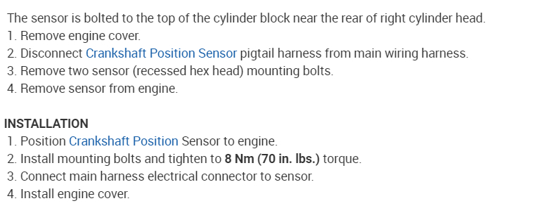

Most of the time this will be a fuel pump or the crankshaft angle sensor. When the engine stalls see if it will run on starting fluid, if so, the problem will be fuel related.
Here is a guide to help and the location of the crankshaft angle sensor so you can check it out:
https://www.2carpros.com/articles/engine-stalls
