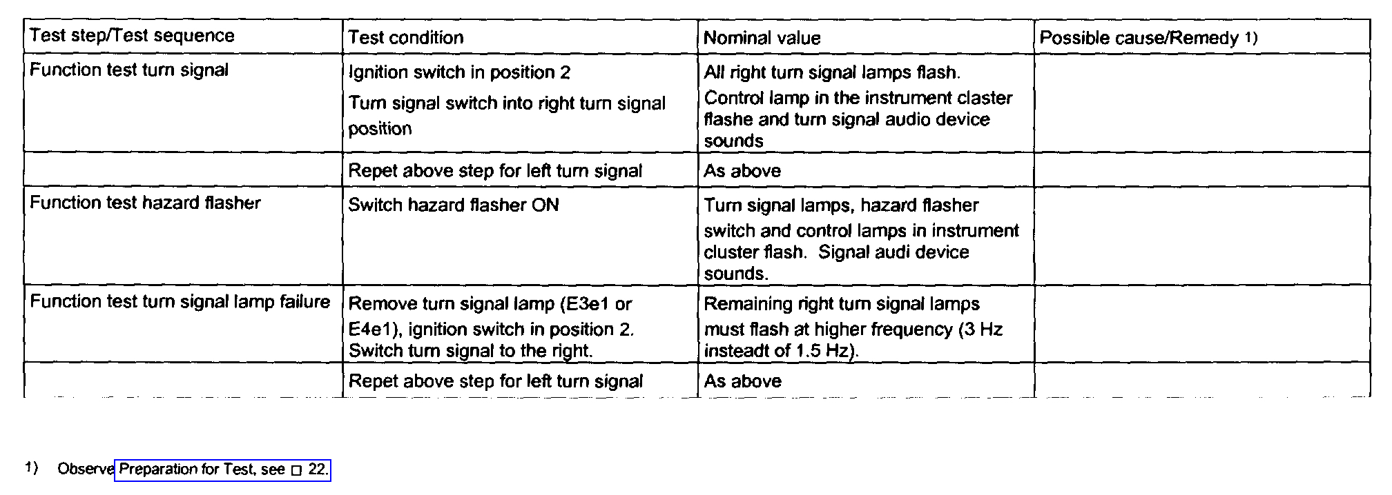

As far as the signals, here is what I have. The pictures correlate with the directions.
Function Test
Function Test Explanation
Signal pickup and activation module (SAM) left front (N10/1) and electronic ignition lock control module (N73) both control the turn signals function and they have to be in perfect working condition.
Turn signals function can be checked using HHT. Turn signals function test with HHT can be conducted through:
- Signal pickup and activation (SAM) control module (N10/1),
- Electronic ignition lock control module (N73)
- Flasher function
There are following functions to choose from:
1. Control module version coding
2. Diagnostic Trouble Code (DTC) Memory
3. Actual values
4. Activation
CAUTION: To prevent damage to the control modules, the connectors on the control modules must only be removed or connected with the ignition OFF

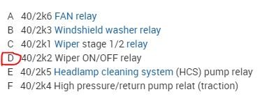

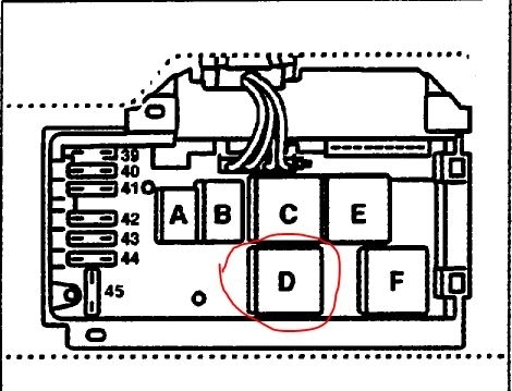

Did you replace the wiper relay? I realize you most likely did, but if you didn't, try it. Pictures 2 and 3 correlate with the relay.
