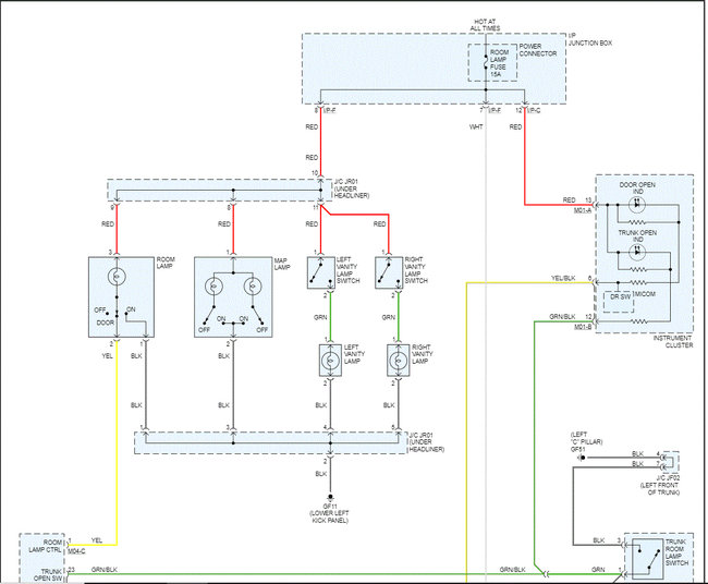

Been a really long time now :) Since the COVID outbreak this car has mainly been relegated to sitting in the driveway. However, now I want to give it some TLC. So, I did a draw test on this and it's getting a very very acute draw...just 0.16 milliamps...but we want it between 0.02 to 0.05, correct? So, not a huge draw, but enough to kill it after a few days, week or week and a half to 2 weeks.
Now, I pinpointed the fuse as well. It's the ROOM LP fuse (again, 2008 Hyundai Elantra) and I see five things on that...Map Lamp, Dome Lamp, Trunk Room Lamp, digital clock and Home Link. Now, wasn't sure what the hell the home link is but did a little research and pretty sure this car doesn't have that :) I've read the ROOM LP can be pretty dreaded when it comes to draws, so I am wondering if there is more than meets the eye than just the 5 things going to it.
So with that, I hooked up the multi-meter again and got the draw and started taking those components apart (door shot, car off and "sleeping") to see if just unplugging the components would do the trick one-by-one. Would that work, just unplugging them? because it didn't for me. Or do you have to clip the wiring to whichever is causing the issue? That's the part I am trying to avoid :) Not sure if I am going to want to go behind the fuse box and pinpoint the exact wire.

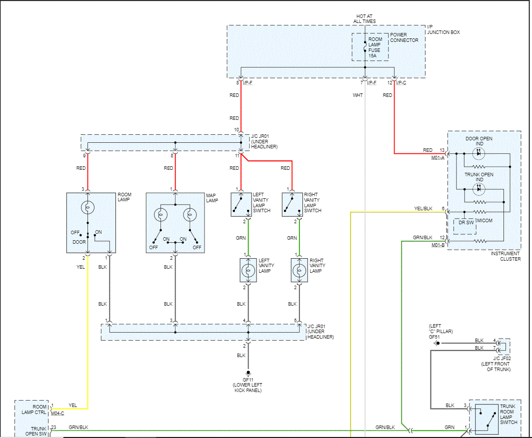

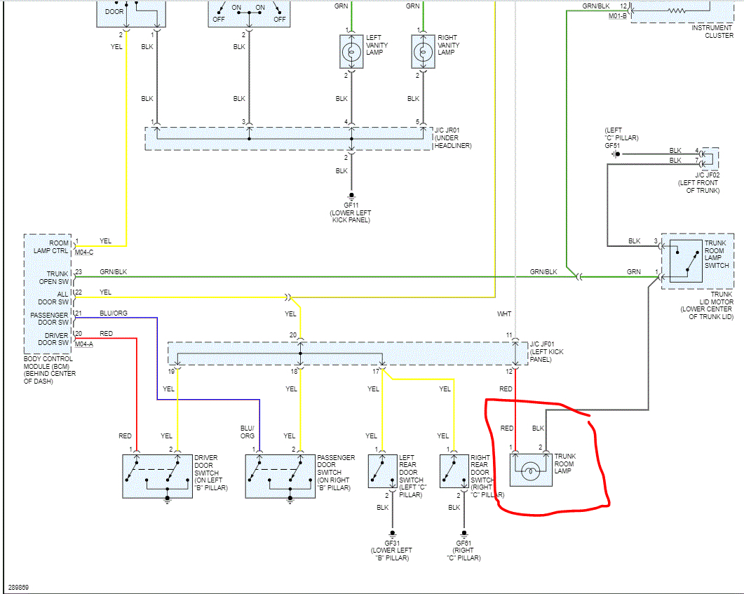

Okay, the fuse you found as the draw basically covers everything you mentioned. Do not cut the wires to test for a draw. How did you check the trunk light? Did you remove the bulb? Where were the other components disconnected?
If you look at the two pics below, I attached the entire wiring schematic for that circuit. See if anything was missed.
I cut the pic into two parts so you could read it. However, I did overlap them so you could follow from one to the other.

No, I am not cutting any wire, I was going to do that as a last resort and/or remedy as the car is old and has 110,000 miles on it. I wanted to pinpoint the wire if I can and then cut it to remove the draw. I don't know if I'd have the wire fixed or not, especially if it's something simple as a dome light or trunk light, I don't care if those don't work. :)
But what I did with the digital clock, trunk lamp, map lamp and dome lamp was simply unplug them. I popped the plate open on the dashboard to get to the back of the digital clock and literally just unplugged it from the unit. Did the same for the other things as well. Didn't remove any bulbs.. basically what you would do if you got a replacement part.. unplug the old and simply plug the new in, and pop or screw it back into place.
I was hoping that's all it would need to be done so I don't have to clip any wires to fix anything. but would simply unplugging like that do the trick? If so, then I need to unplug elsewhere since I unplugged all of them and that didn't do it.
I am wire diagram illiterate I'd say. I'm trying to make sense of it.

What you did makes sense. However, I want you to tr something different. Unplug all of the components at the same time to see if the draw is gone. If it is, then plug one in at a time until the draw returns.
I know that sounds like the same thing just in reverse, but there could be something you disconnected that has a short and is allowing power to be drawn all the time. If everything from that circuit is disconnected and we still have a draw, then we need to start checking the wiring between the fuse and components for a short.
Also, there could be one power wire that supplies power for a few different things.

Well my friend, I figured out where the draw came from! I was kind of doing what you suggested already.. just unplugging things all at once and one-by-one plug them back in, etc. Got nothing. Unplugged a few other components for the heck of it to see and got nothing. Was about to throw my hands up and say "well, gotta go to the shop, can't figure it out." Then thought at the last moment as I was putting all the door jam switches back into place "hmm, let's do the driver side front door, that had work on it." Bam, removed the door panel and unplugged everything there, boom, draw went to 0.00 and fluctuated between that and 0.01. :) Yay! Then plugged in each door component one-by-one to find the culprit and found it.. was the wiring going to the outside door mirror. I plugged that in..draw went up to 0.16, unplugged, down to 0.00. Just leaving it unplugged for now as it really isn't vital to me.. maybe at some point I'll get it taken care of either by myself or a shop, but we will see, just glad I found where it was.
Thanks for everything. your opinions and suggestion helped push me over the edge to find this pesky problem.
