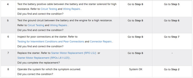

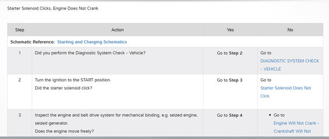

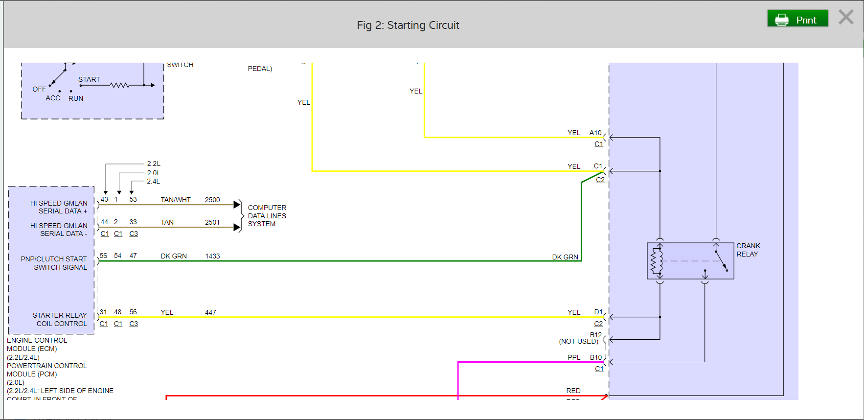

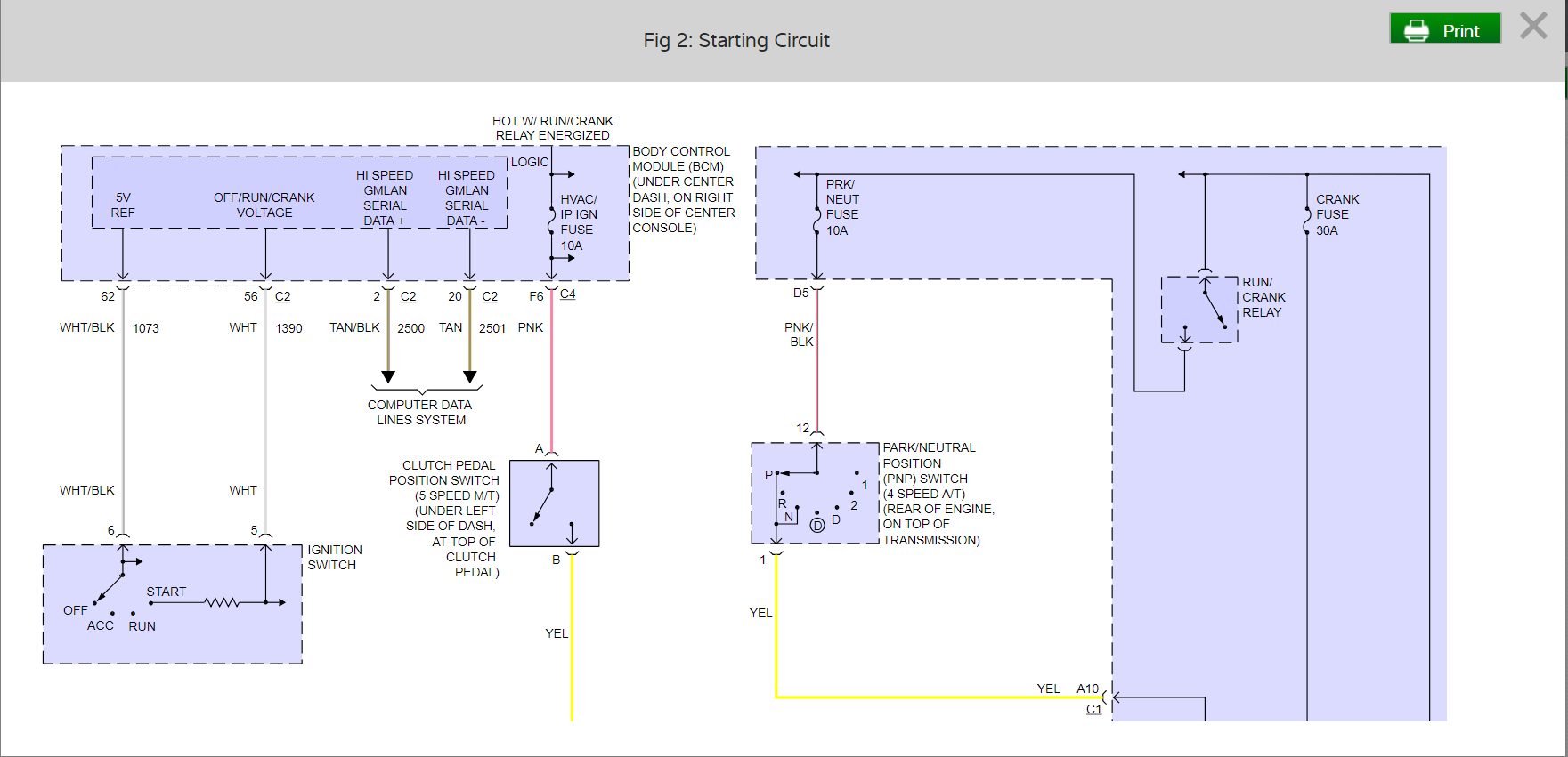

My brake booster was just replaced and I got a brand new battery. when I turn my key to start the car there's no cranking. All the lights on the dashboard comes on. Would it be my run/crank fuse? I tried jumping my car it doesn't work.

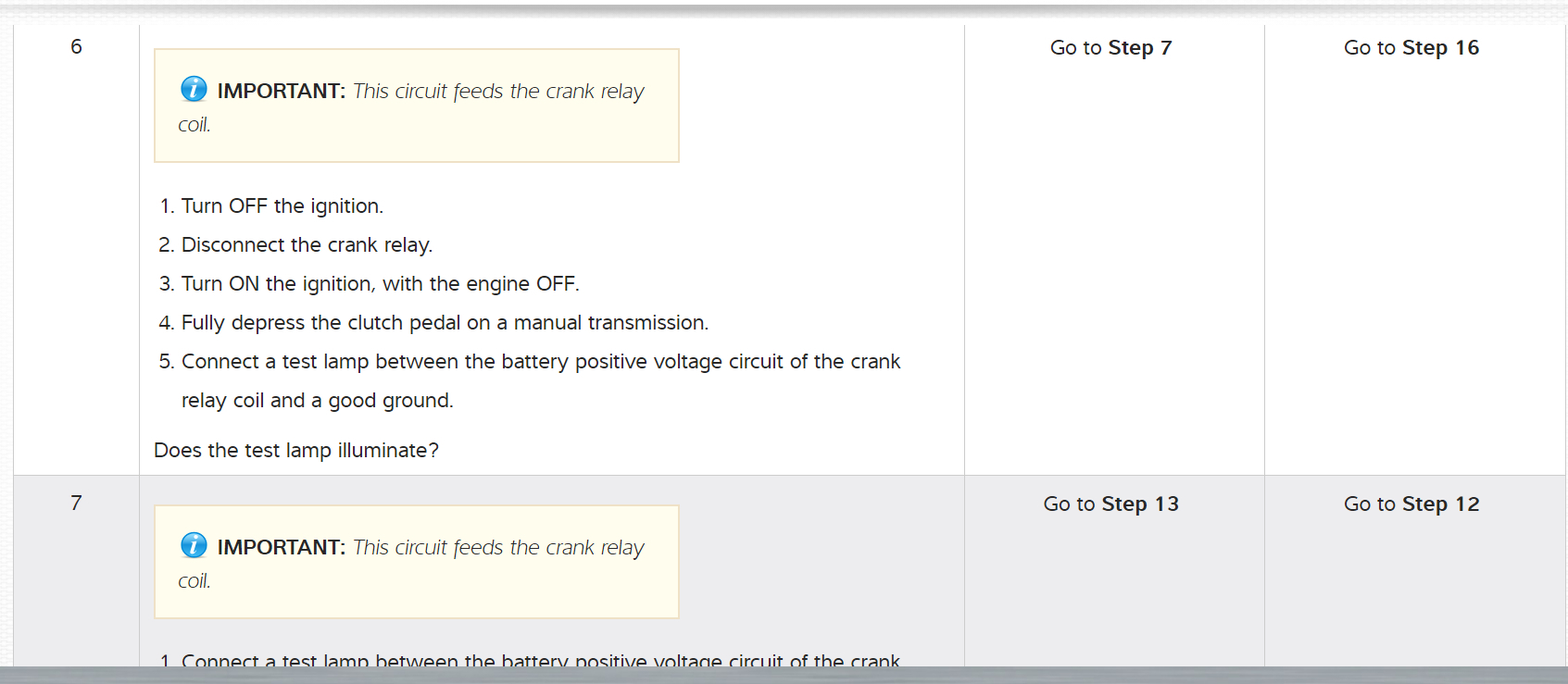

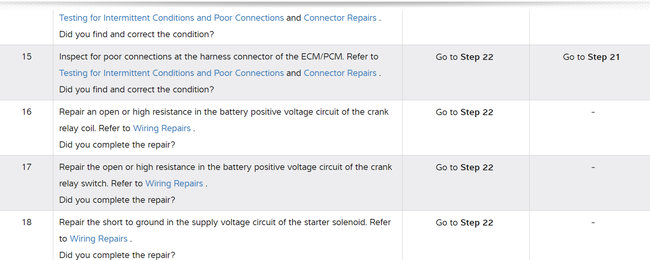

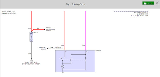

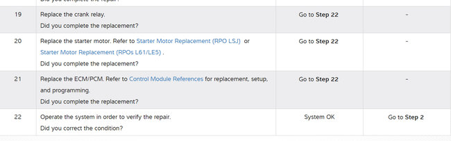

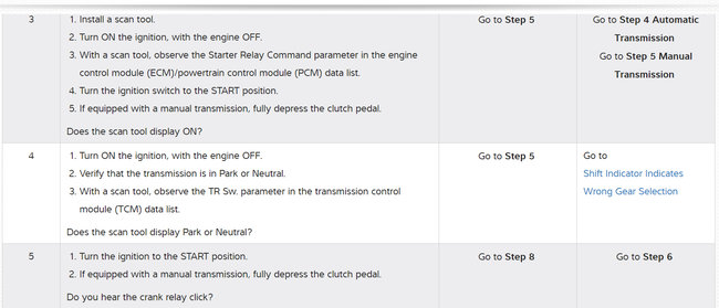

This could be a problem with the starter solenoid. I have included a link for you to go to down below.
https://www.2carpros.com/articles/engine-cranks-excessively-before-starting

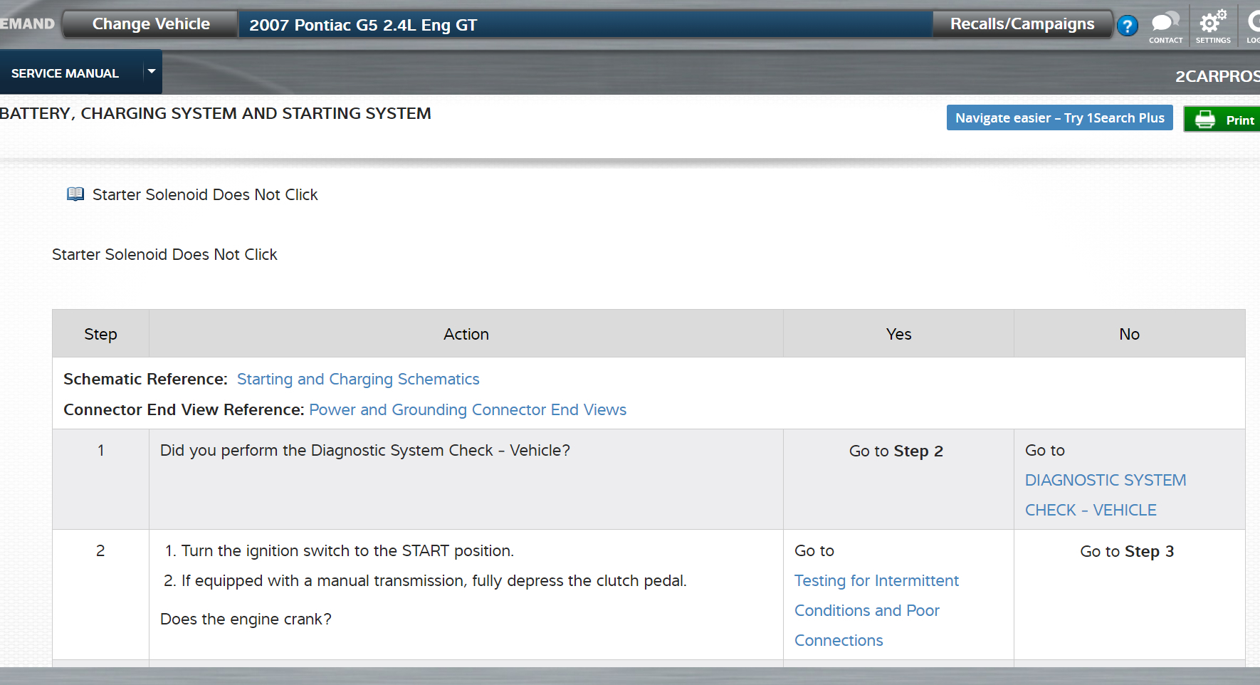

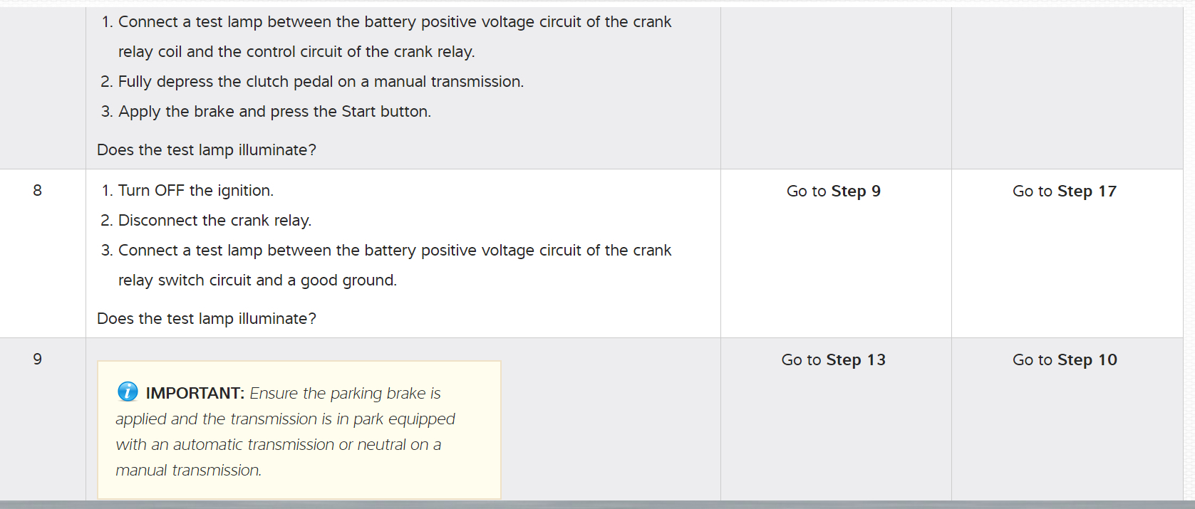

I also have included troubleshooting flowcharts specific to your vehicle for starter solenoid does not click (no crank), starter solenoid clicks (no crank), as well as starting system wiring diagrams for you in the diagrams down below. Please go through the guide and the flowcharts and get back to us with what you find out.

Okay. Sorry about that. Please go to the link below.
Please go through this simplified guide and get back to us with what you find out.
