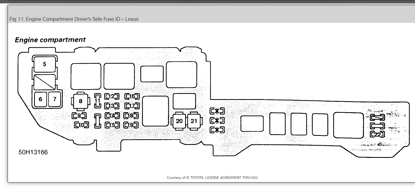

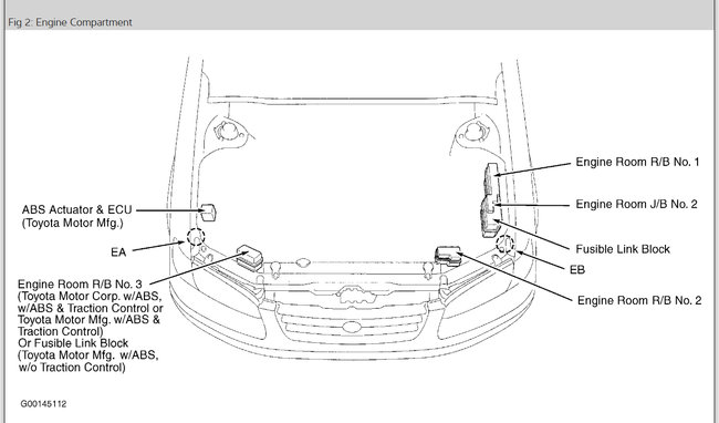

I had someone help jump my car and the cables were switched. I have recharged my battery, replaced all of the fuses but I have no panel, heat/AC, no gauges, power locks/windows, break lights and my car won't shift into gear. The car starts now, and the headlights work and the dome light still comes on when the door opens. Do I need to change the relays?
Feb 3, 2019 at 3:35 AM
  • 55,743 POSTS
I sounds like a fusible link is blow. here is a guide to help check it. please test Link 5, 6, 7 and 8 in the diagrams below.
Check out the diagrams (below). Please let us know what you find.
