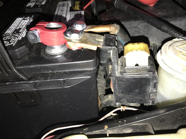

The vehicle does have an aftermarket remote start. I started with that first when testing. I did test all circuits. The only one to show a change in the flow was the generator circuit. I did check the fuse itself. It appears to be clean and unbroken. The only fuse I did not pull was one that comes from the positive terminal on the battery. I was not sure what this fuse was for but I am guessing that it helps to regulate or protect against voltage spikes. I attached the photo of this.

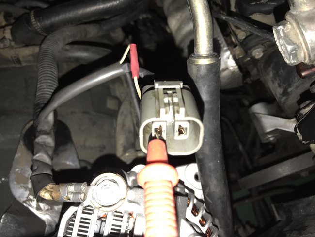

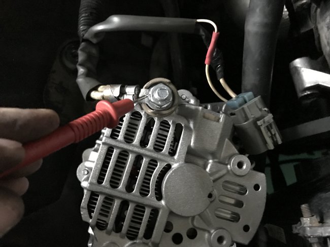

I do not know if this matters but both ends of the alternator cables have power going to them. I tested both cables out and both have 12 volts going to them.

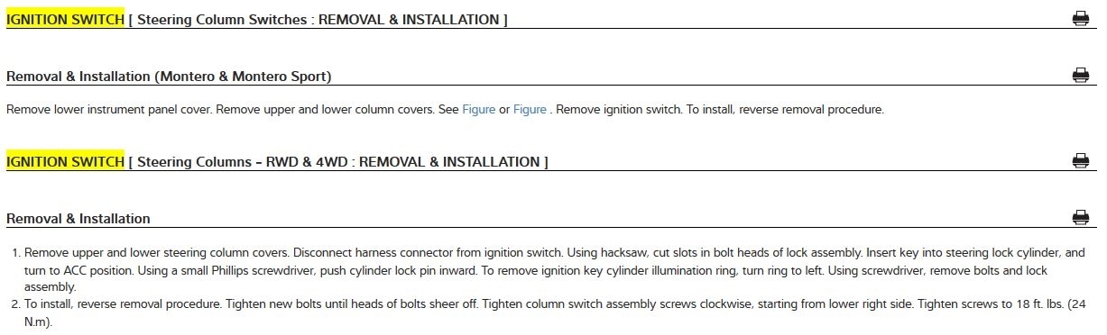

Sorry, I really meant to. In the process of buying a house and it is consuming all of my extra time. Anyways, the best way I can figure to test it would be to do the drain test that you ran earlier, but this time unplug the electrical connector to the ignition switch and observe the voltage drop. Attached is Mitsubishi's instructions on how to remove and replace the switch. The directions are less than impressive, in my opinion. But that is what we get sometimes.

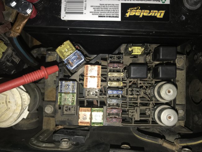

So I really appreciate your help Heyman1104. I ran the drain test and disconnected ignition switch. The drain was still there. I disconnected the alternator and the drain was still there. I went back and checked all fuses again and removed all aftermarket wires and accessories. I tested again and still the only fuse to stop the drain was the one linked to the alternator. or at least I believe it is. I attached a photo of the fuse (it is a 100 A fuse). When I take the fuse out and both cables are attached to both terminals and then place the fuse back the ABS relay clicks. I removed the relay and the drain is still there. I guess it just means that power is being shunted over there bypassing the ignition switch.
