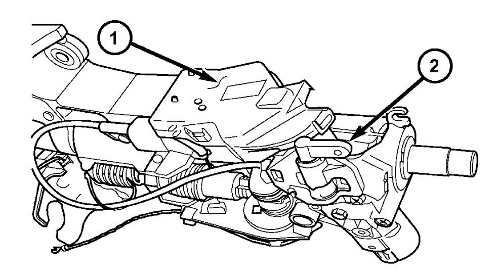

The ignition switch is loose in the column and the key is hard to turn. And after I pull the key out the bell still rings and in the morning it's like my battery is dead. Is there something in the ignition switch that may not be turning the vehicle completely off?
Feb 24, 2019 at 4:22 PM
Good morning,
It sounds like you need to change the key cylinder and the switch. There may be a short internally not turning off the alarm and that would cause the battery to go dead overnight.

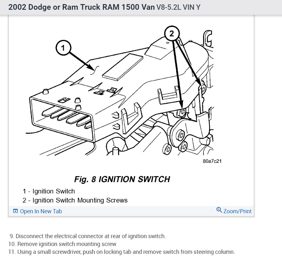

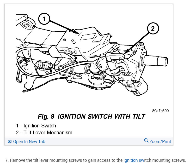

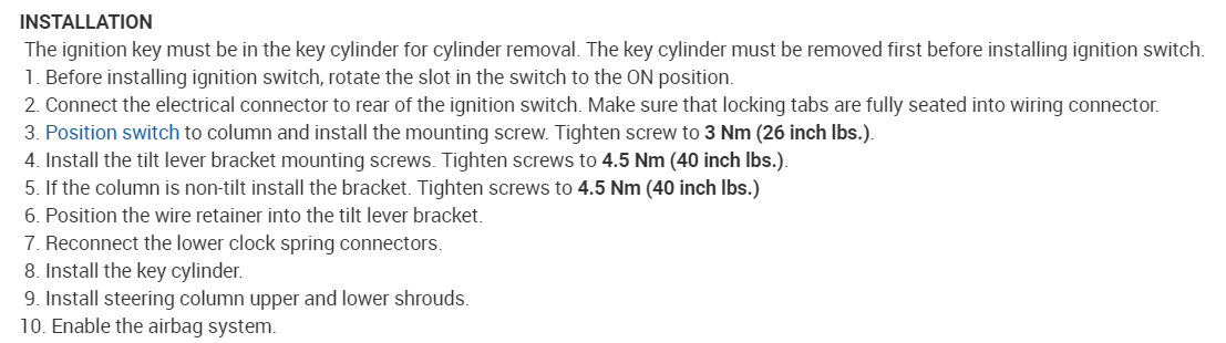

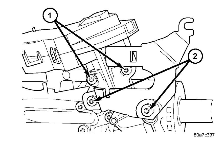

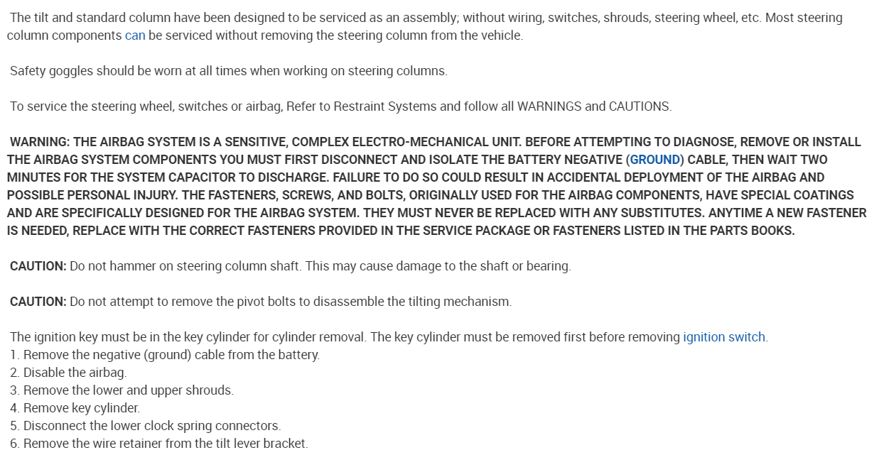

Procedure
The tilt and standard column (4) have been designed to be serviced as an assembly; without wiring, switches, shrouds, steering wheel, etc. Most steering column components can be serviced without removing the steering column from the vehicle.
Safety goggles should be worn at all times when working on steering columns.
To service the steering wheel, switches or airbag, Refer to Restraints and follow all WARNINGS and CAUTIONS.
Warning: the airbag system is a sensitive, complex electro-mechanical unit. Before attempting to diagnose, remove or install the airbag system components you must first disconnect and isolate the battery negative (ground) cable. Then wait two minutes for the system capacitor to discharge. Failure to do so could result in accidental deployment of the airbag and possible personal injury. The fasteners, screws, and bolts, originally used for the airbag components, have special coatings and are specifically designed for the airbag system. They must never be replaced with any substitutes. Anytime a new fastener is needed, replace with the correct fasteners provided in the service package or fasteners listed in the parts books.
CAUTION: Do not hammer on steering column shaft. This may cause damage to the shaft or bearing.
CAUTION: Do not attempt to remove the pivot bolts to disassemble the tilting mechanism.

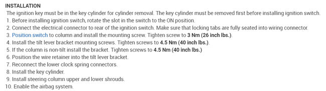

The ignition key must be in the key cylinder for cylinder removal. The key cylinder must be removed first before removing ignition switch.
1. Remove the negative (ground) cable from the battery.
2. Disable the airbag.
3. Remove the lower and upper shrouds.
4. Remove key cylinder.
5. Disconnect the lower clockspring connectors.
6. Remove the wire retainer from the tilt lever bracket

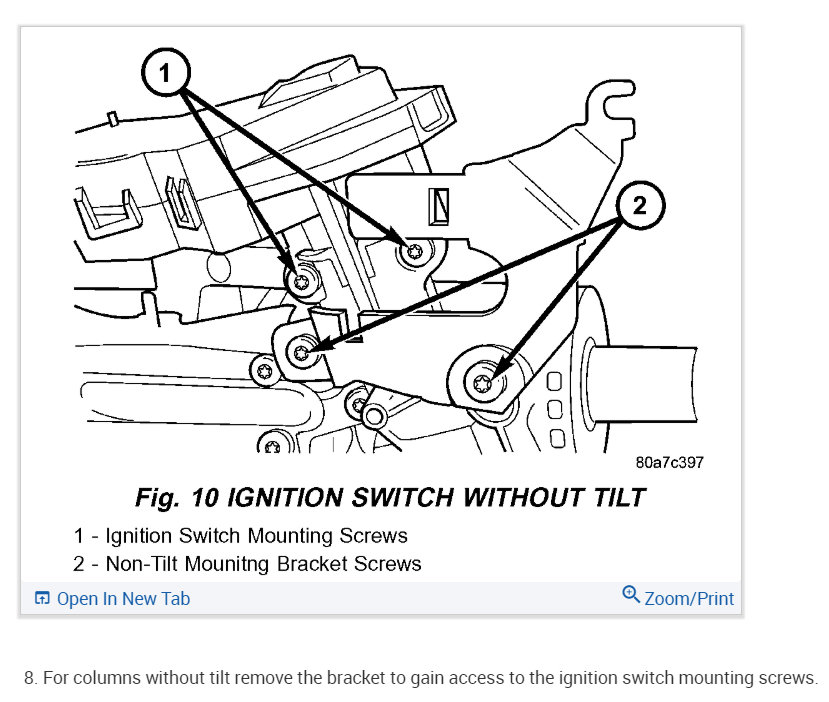

7. Remove the tilt lever mounting screws to gain access to the ignition switch (1) mounting screws.
8. For columns without tilt remove the bracket (2) to gain access to the ignition switch mounting screws (2).

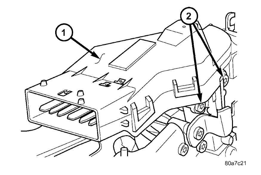

9. Disconnect the electrical connector at rear of ignition switch (1).
10. Remove ignition switch mounting screw (2).
11. Using a small screwdriver, push on locking tab and remove switch from steering column.

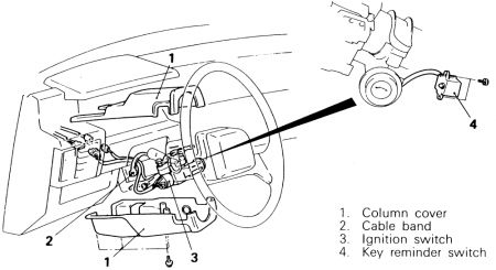

As far as directions check out the guides below. Check out the diagrams (Below). Please let us know what happens.

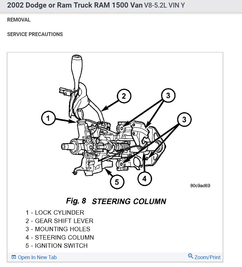

How to take out old ignition lock cylinoid and install the new one. The one in there now I have to pull the key almost all the way out of the ignition after turning it once just to be able to start it. An it's getting worse. I have the part already now just need to know how to install step by step.
Jun 23, 2021 at 12:03 PM (Merged)
CARADIODOC
  • 34,379 POSTS
There are screws to remove from the bottom of the trim covers on the steering column, then the upper and lower halves unsnap and can be removed. Look straight down from the normal driving position toward the cylinder and you'll see a small silver roll pin about 3/16" in diameter. Use a punch or small screwdriver to push that roll pin in. It will go in about 1/8" to 1/4". That will let the cylinder pop out. I can't remember for sure but I think you need to have the key inserted.
Once the cylinder is out, look at the cam on the end of it. Sometimes those crack. The symptom is everything works except it will not turn the ignition switch quite far enough to crank the engine. The dealer has a repair kit for that but you don't have to worry about that if you're installing a new cylinder.
Slide the new cylinder in, insert the key, then turn it to crank the engine. Turning it all the way will push the roll pin out to lock it in place.

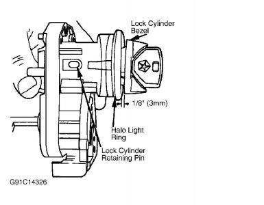

the parts store will sell me the switch but i cannot get the lock cylinder separated from the switch
BMRFIXIT
  • 19,053 POSTS
Removing lock cylinder remove ignition switch with key in switch and in lock position depress lock cylinder retaining pin using a small screw driver rotate to OFF position lock should now be unseated from ignition switch rotate cylinder counterclockwise to lock and remove key and remove lock cylinder

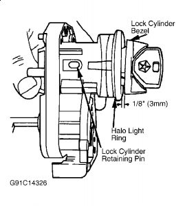

how do you change a ignition lock cylinder?
Jun 23, 2021 at 12:04 PM (Merged)
CYBER TECH
  • 23 POSTS
If you have a tilt column unscrew the tilt lever and then remove the upper and lower covers around the top of the column. Remove 3 tamperproof torx screws and remove ignition switch from column. With key inserted and switch in the LOCK posiiton, depress lock cylinder retaining pin with a small screwdriver. Rotate cylinder to the OFF position and this will unseat the cylinder from the switch. Rotate back to LOCK position and remove key, then separate cylinder from switch.

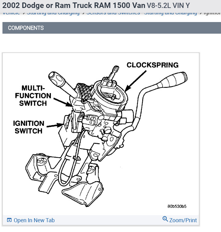

RYANROSS
basically my manual on repair for the truck says my ignition switch should be in the top of my steering column thing is it isnt and i dont know where it is and apparently my book is saying it for power wagon instead of power ram like i have i just need to know where it is located
BLUELIGHTNIN6
  • 16,542 POSTS
If it says power wagon, that is an old manual (pre 83). I learned to drive in a 78 power wagon. Dodge has come out with the PW package on the 2010 model year, but that is it. As far as you switch, it should be located on the bottom of the steering column. If you have the trim off the steering column, there is a rod that runs from the tumbler to the switch. Follow that and it will lead you to the switch. Let me know what you find. Joe
