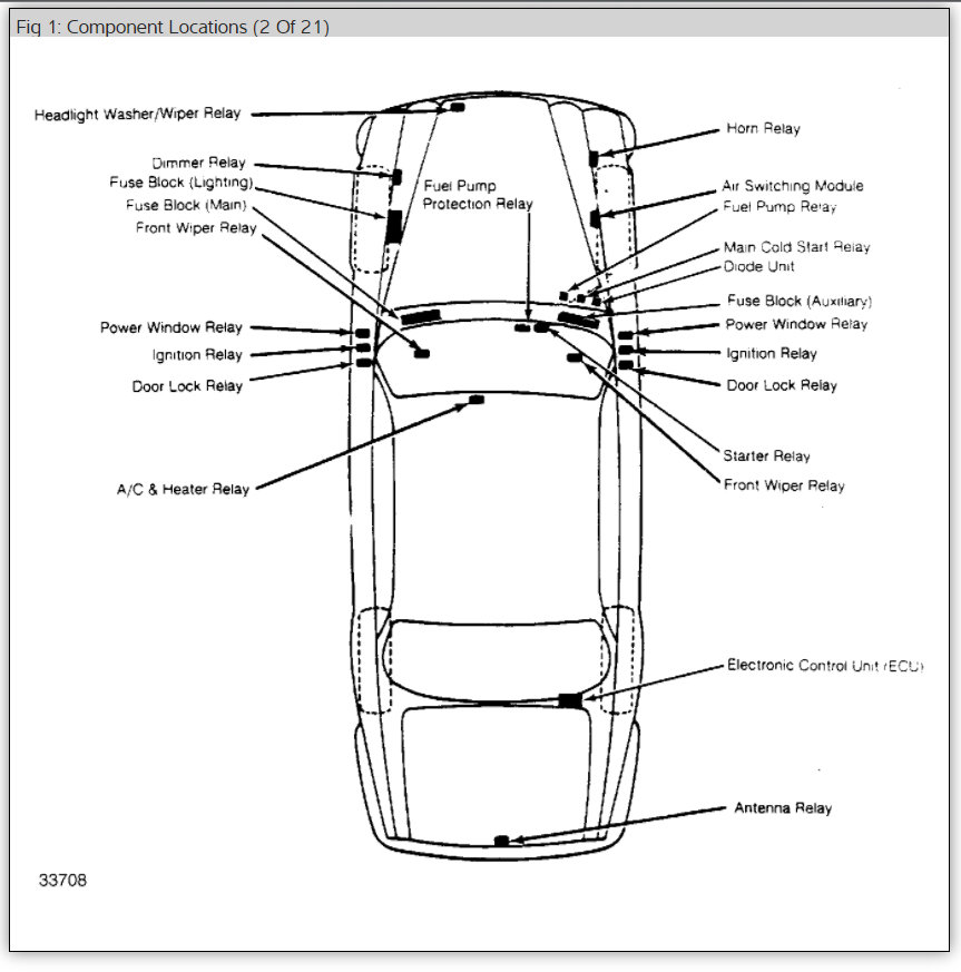

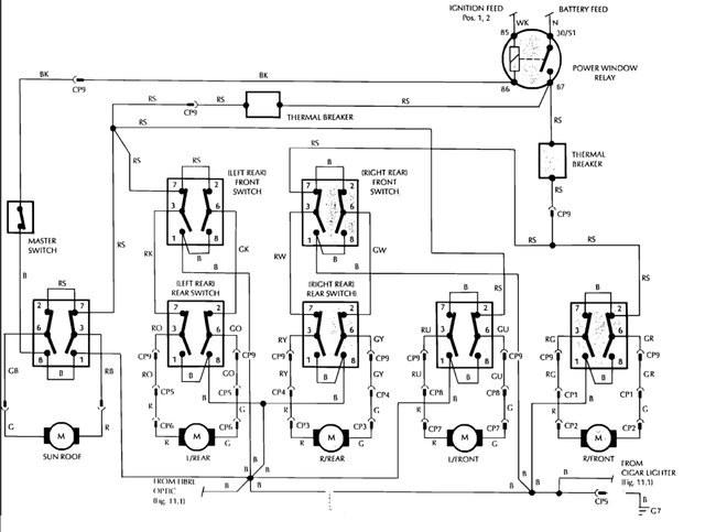

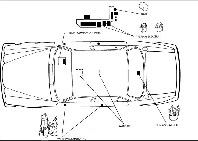

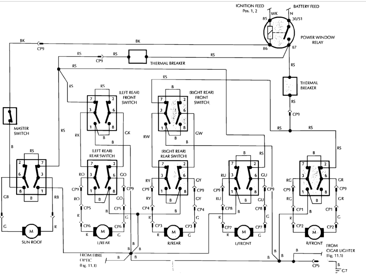

The windows and the sunroof do not operate.
What should I do to troubleshoot or find the problem? Be specific.

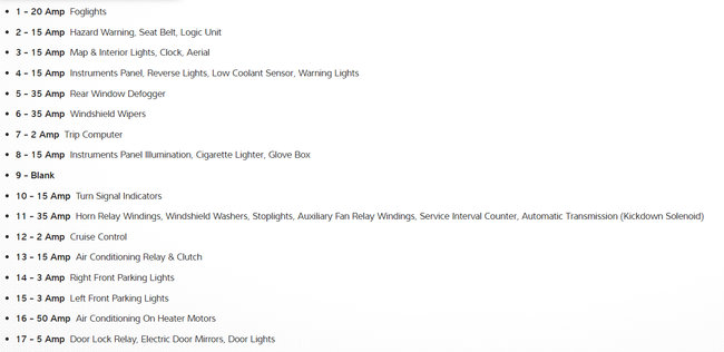

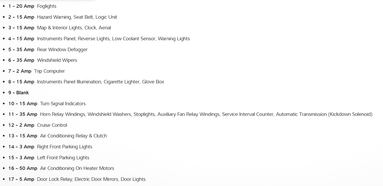

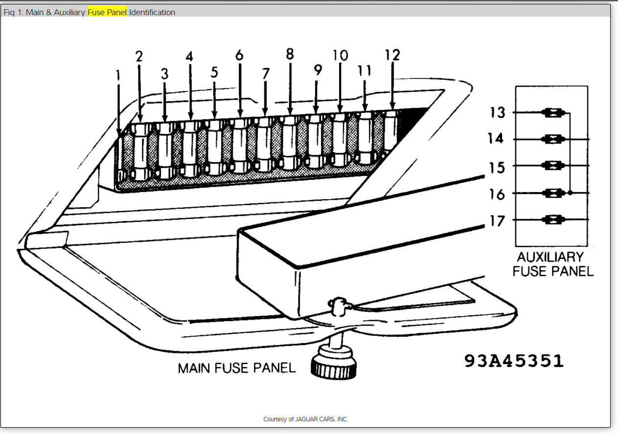

Which fuse would operate the windows, and location?

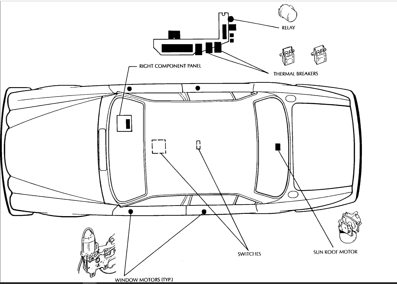

I am not sure what or where the relay would be, per some of the comments read.

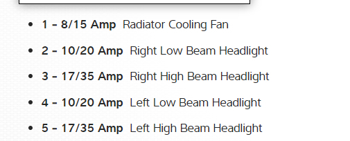

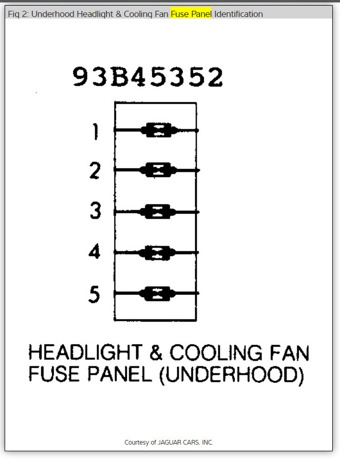

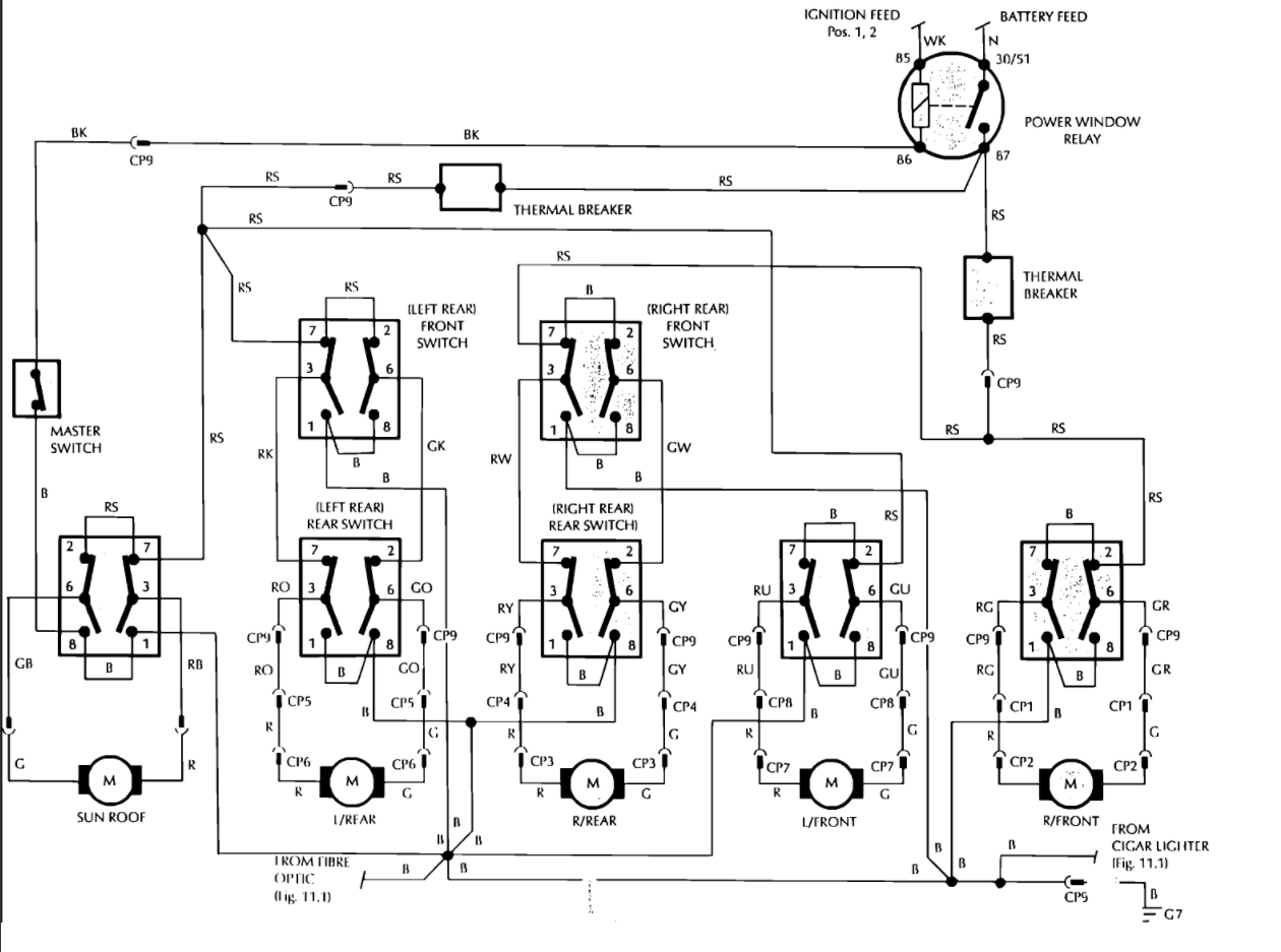

Here are the wiring diagrams and fuse locations for the windows and the sun roof with a guide on how to check the fuses and the wiring:
and
and
