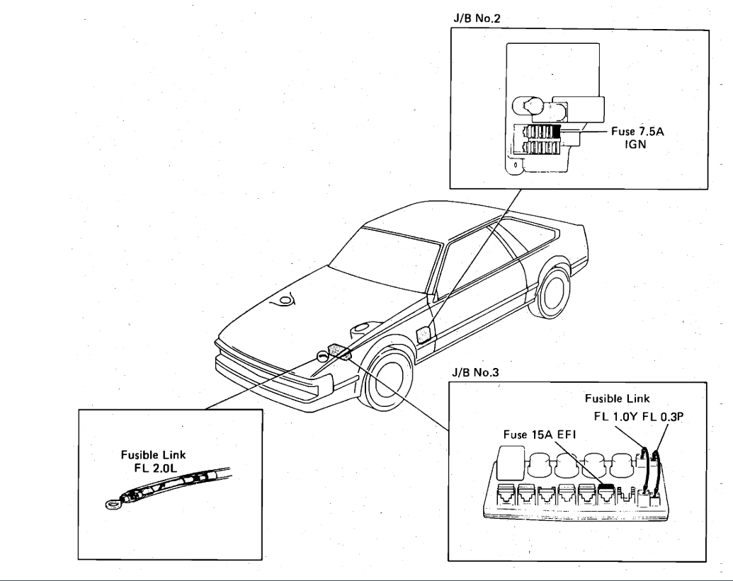

I had my alternator go out and changed it, yes I was sure the alternator was the issue, so I changed it. i made sure to connect everything correctly and now there’s no electricity to the car. I found a wire that runs from the same grouping as the alternator that isn’t connected to anything and I can’t find its home.

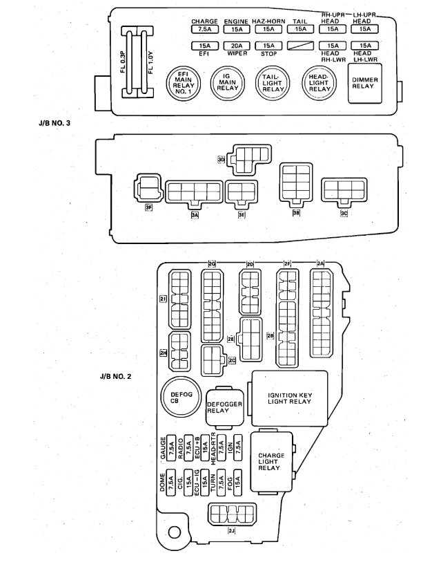

Good morning,

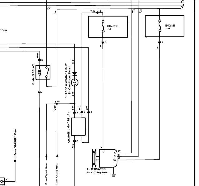

Can you upload a video or pictures of the wire that is hanging free? I attached a diagram for you to view.
Do you have power to the alternator from the battery?

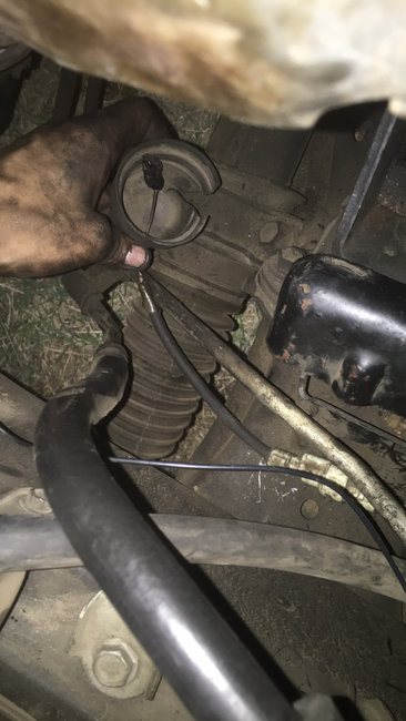

This is the wire end:

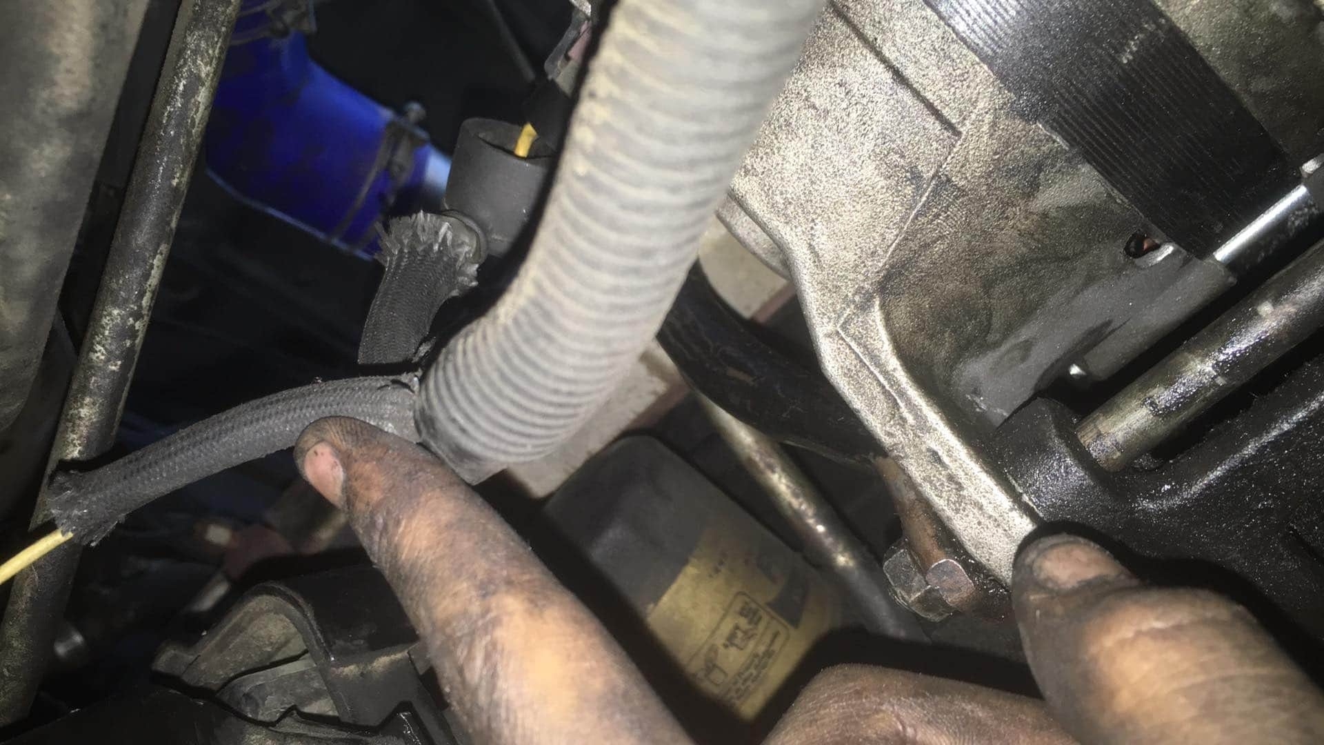

This it where it splits off from the alternator.

Or at least from the same wires as the alternator.
Jul 18, 2020 at 6:41 AM
Is the yellow cut back by the alternator? It looks like the wire is cut.
Jul 18, 2020 at 8:53 AM
SLIDYMK2
  • 11 POSTS
No all the wires to the alternator are connected and in tact.

Is that a used alternator or did you not change out yet?
Do you have power to the alternator wire from the battery? You need 3 wires with power to the alternator. Can you verify that?

I only believe I have 2 the harness and the ground. I can send more pictures too.

Please send as many as you can. The diagrams I have are generic and I would like to see what you see.

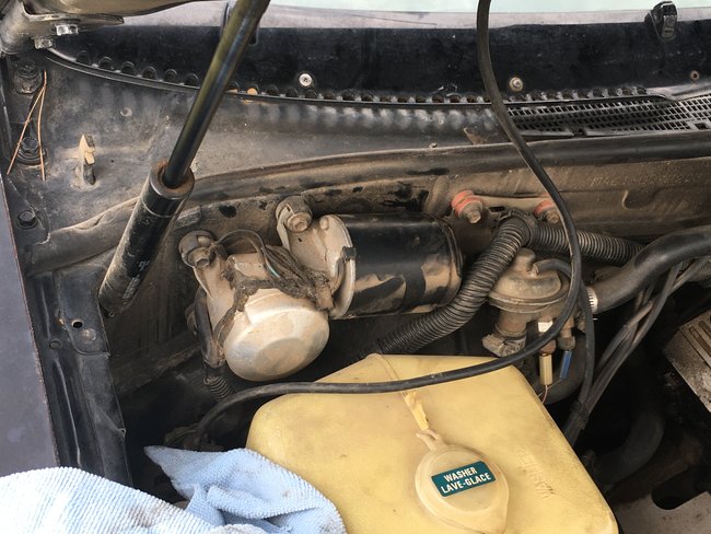

Could you possibly tell me what part this is?
Jul 24, 2020 at 10:18 AM
Please start a new question on a different issue.
Jul 24, 2020 at 8:14 PM
SLIDYMK2
  • 11 POSTS
It’s still the same issue, I was told to try replacing it I just can’t remember the name.
Jul 25, 2020 at 8:16 AM
That is the wiper motor and has nothing to do with the alternator.

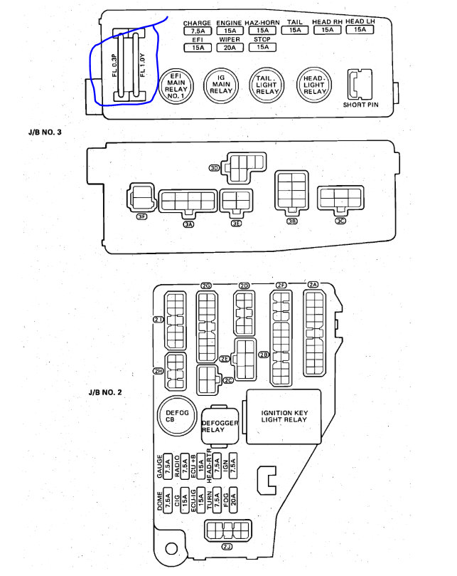

You say that, but after fixed a wire on there i started the car today.
Jul 27, 2020 at 6:48 AM
SLIDYMK2
  • 11 POSTS
My friend that helped me thinks the wire that was off was arcing on the car
Jul 27, 2020 at 8:12 AM

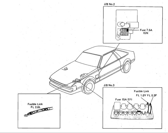

Then check the fuse block for a high amp fuse. Test it on both sides with a test light.
