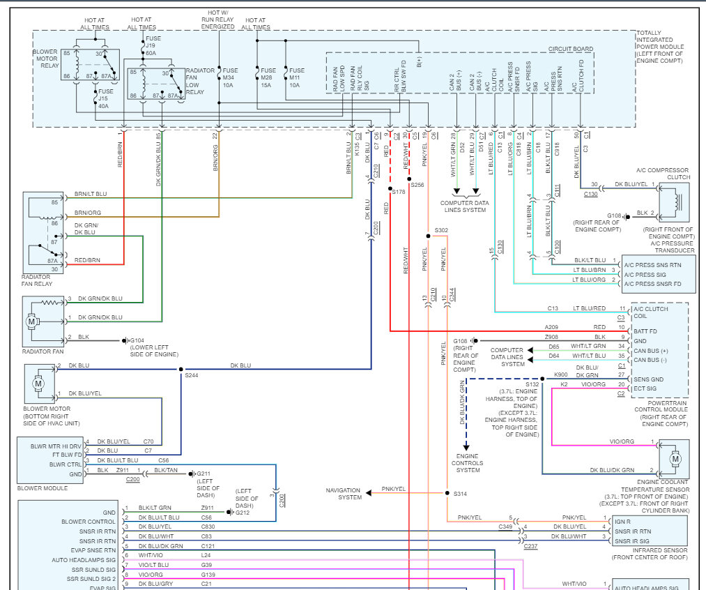

Electric Condenser fan will not turn on when Air Conditioner is turned on?
2012 RAM 1500
114,000 MILES • 4.7L • V8 • 4WD • AUTOMATIC
JERRY WILLIAMS2

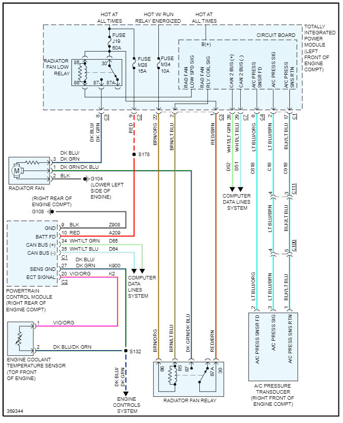

Fuses are all good. I pulled the connectors on the TIPM and saw no corrosion.
If I bypass the high-speed relay which is on the horn bracket, the fan works.
Jul 10, 2023 at 1:01 AM
  • 55,224 POSTS

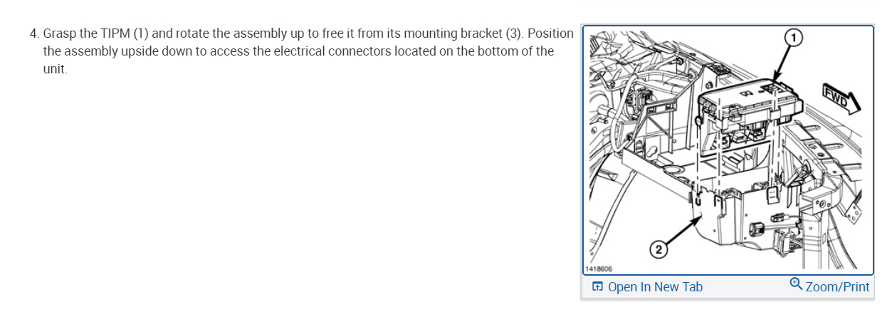

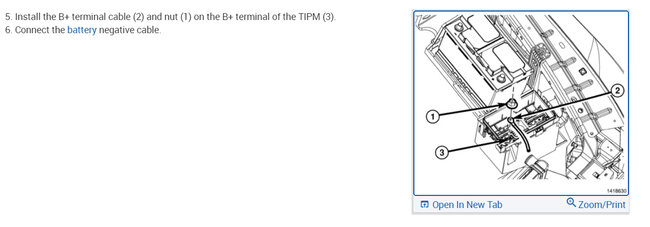

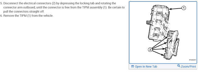

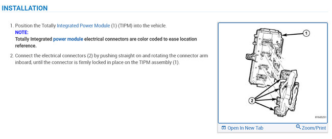

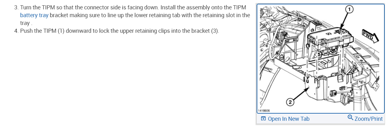

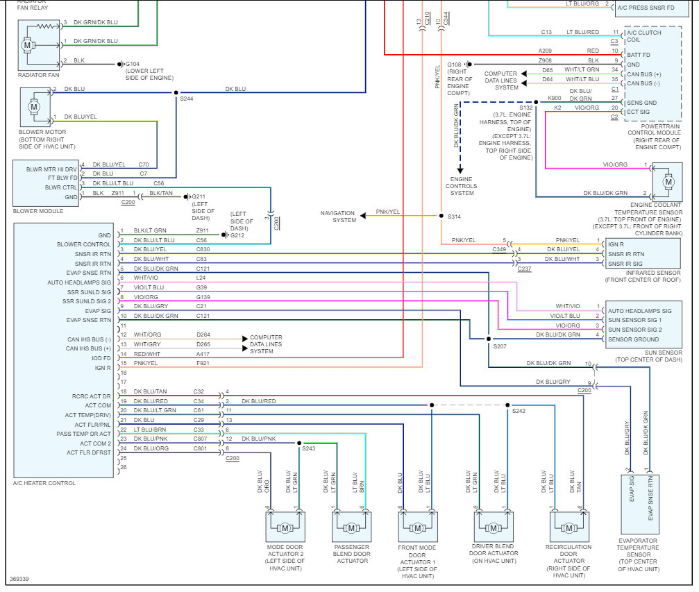

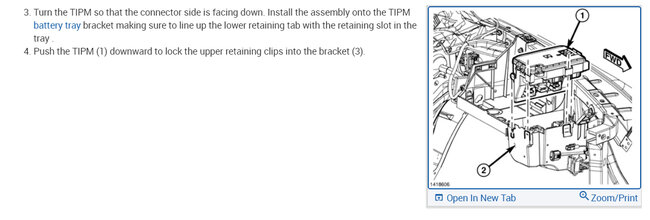

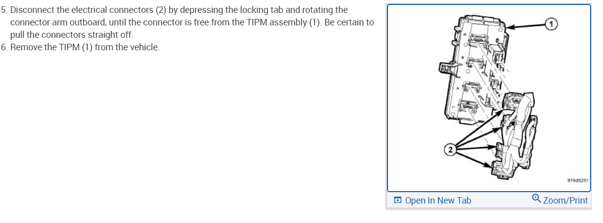

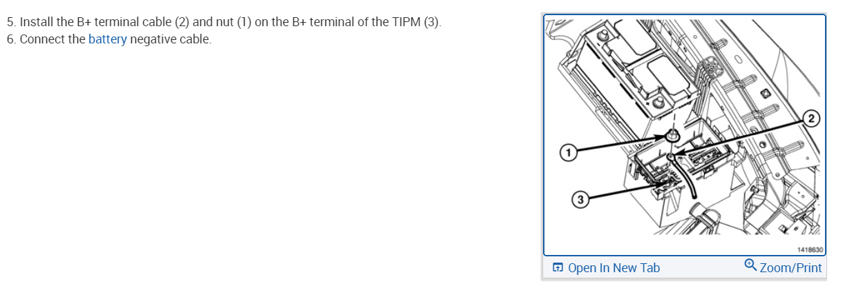

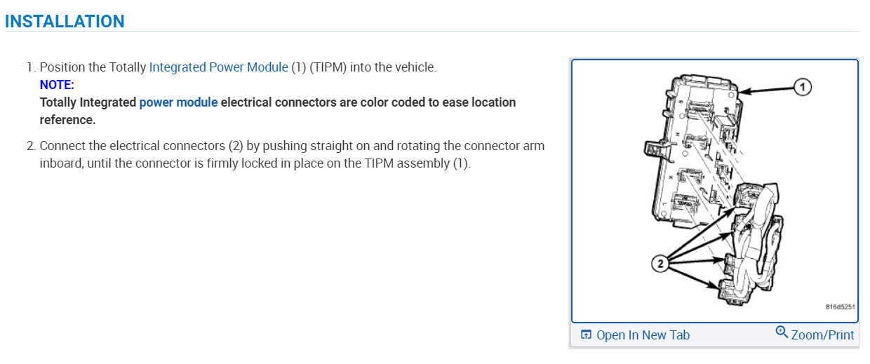

So, the condenser fan is run by the TIPM which goes out all the time in these trucks, but to be sure we should do a CAN scan, you can get a CAN scanner (Controller Area Network) which will work on most cars from Amazon.
https://youtu.be/u-4syLc-ifQ

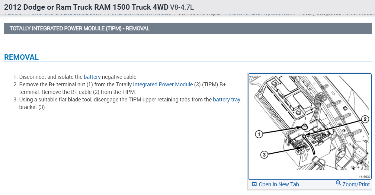

Here are the fan wiring diagrams so you can see how the system works and I have included how to change out the TIPM which is easy because it-self learns. Check out the images (below). Please let us know what happens.
