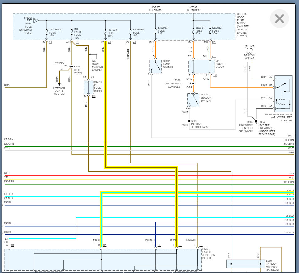

This could be a few different things.
Note: I am basing my ideas on the rear taillights/dash lights not working.

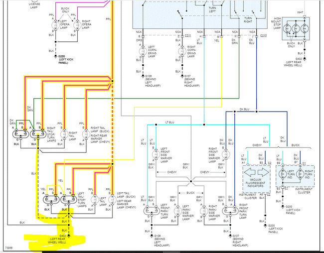

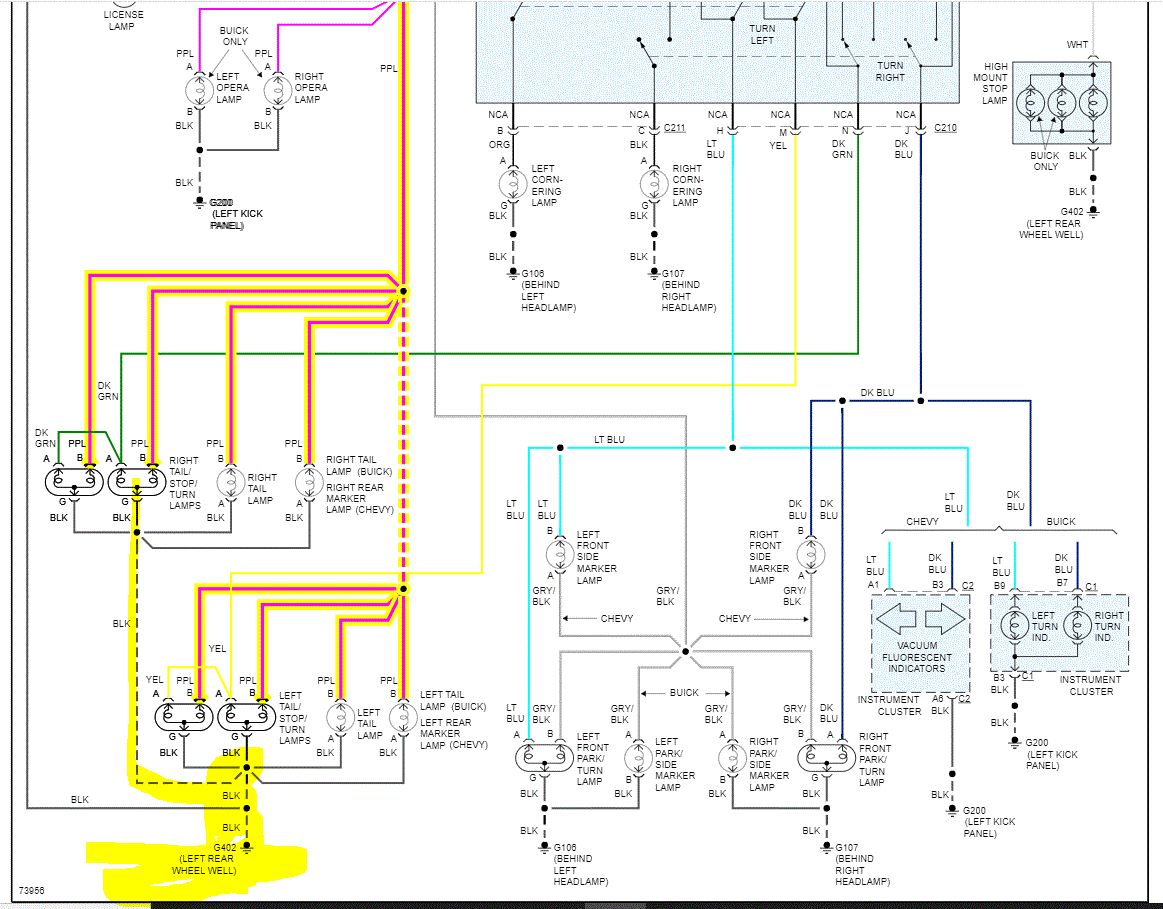

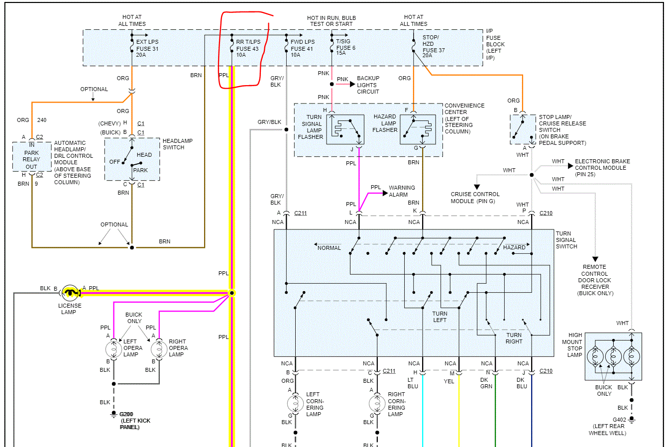

If none of the taillight's work, my first suspect is the ground was lost. All taillights share a common ground. Also, there is a fuse designated for the rear taillamps.
IF you look below, I attached the wiring schematic for the rear lights. I had to cut it in half to make it readable, but I did overlap and highlight areas of interest.

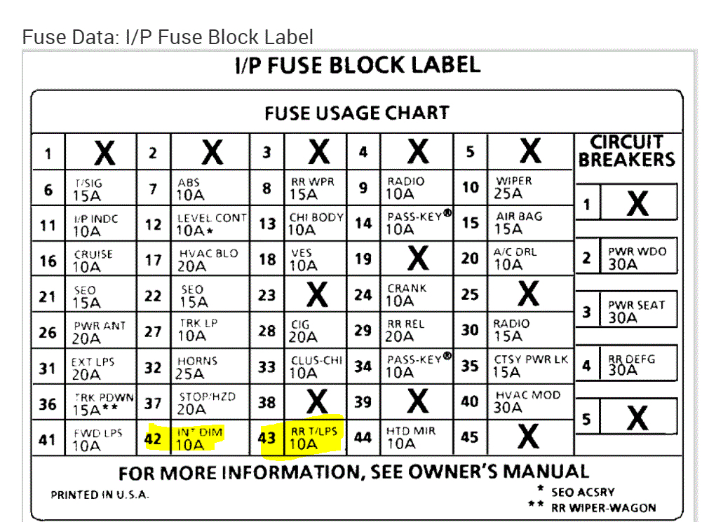

First, I need you to check fuse 43 in the instrument panel fuse box. In addition to checking the fuse, confirm there is power to and from it. Here is a link you may find helpful:
If the fuse is good and has power, then we need to locate the main ground for the lights. It is attached to the left inner wheel well. If you are unable to locate it, check any of the black wires at the lights for continuity to ground. Here is a link you may find helpful:

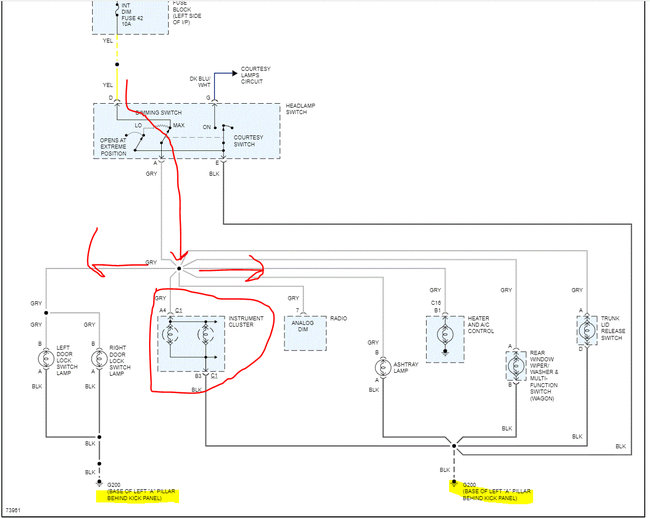

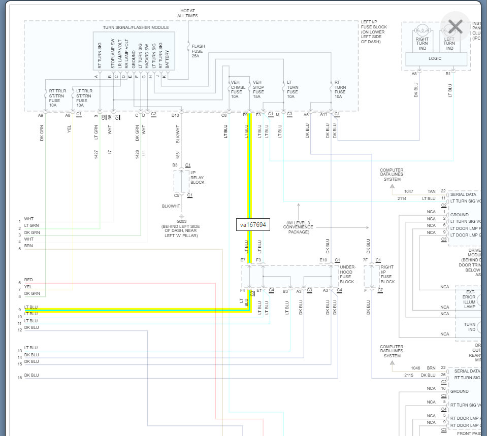

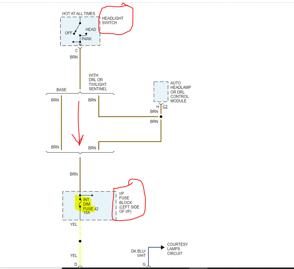

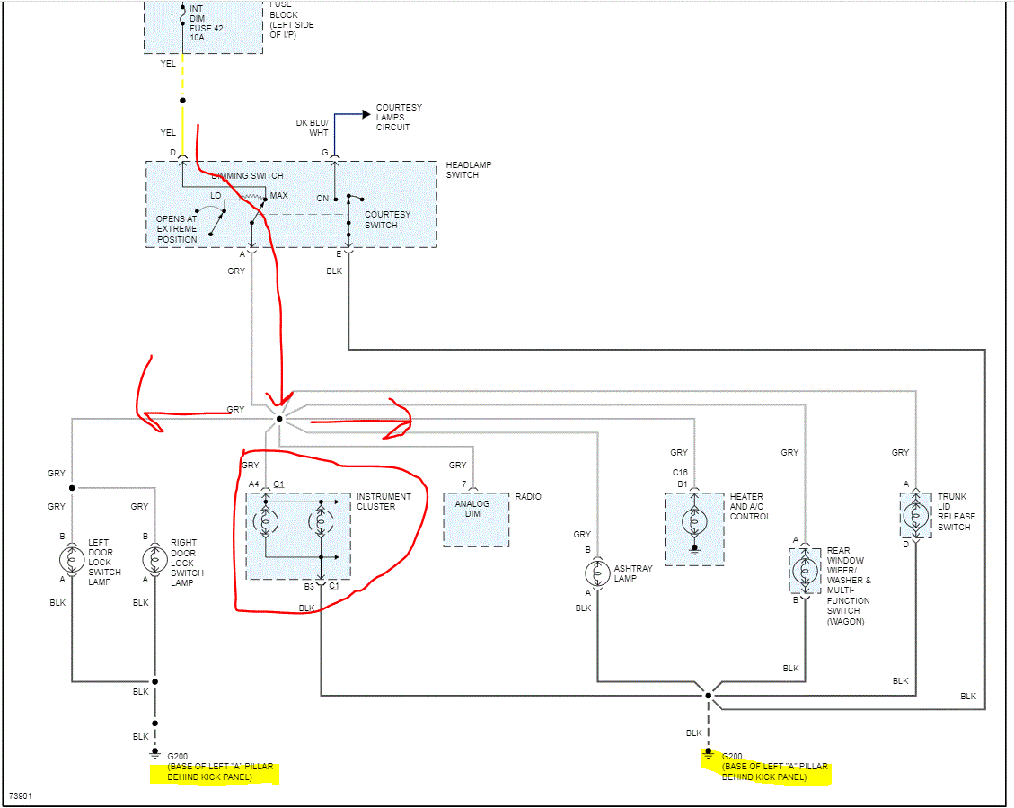

As far as the interior dash lights, the only thing tying them together with the rear lights is the headlamp switch. However, there is a separate fuse to the IP lamps after the switch and before the dimmer. It is fuse 43 in the instrument panel fuse box. I would start by checking that fuse and the ground for this circuit. If there is no power to fuse 14, I suspect the headlamp switch is bad. I also attached the schematics for this circuit, pics 3 and 4.
Note: The two fuses are side by side so that may be where the issue is.
The last pic below shows the fuse box and fuses to check. I need to know if they are good and have power.

I don't have a fuse box like the one you sent me.
Dec 30, 2021 at 6:40 PM
  • 110,194 POSTS
Interesting... Is the year, make, and model above, correct? Does it have the 5.7L V8? Also, is it a sedan or wagon?
