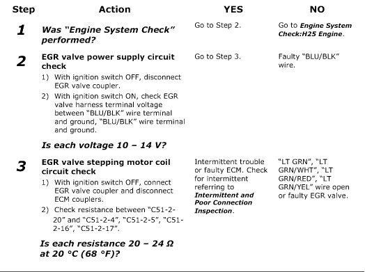

Changed the EGR valve because I was getting a random misfire code and the engine was stalling. Now I am getting a po403 code and the engine still intermittently stalls.

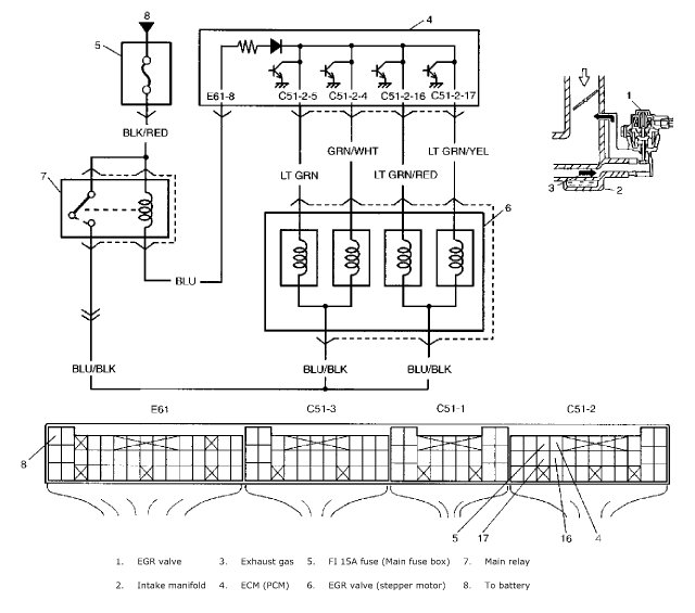

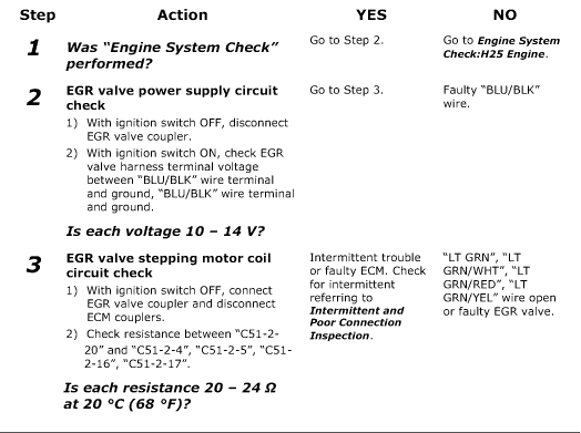

Hi and thanks for using 2CarPros.com. You will need a scanner to perform the following test to diagnose if there is a problem with the EGR and to make repairs. You will also need a multi meter to check terminal voltage. Note: I figure you are already know it is related to the EGR since you replaced the part already. However, this code indicates an issue with the EGR control circuit. Here are the diagnostics and flow chart information to help determine where the problem is coming from. I have also attached a schematic, picture, and flow chart for you to follow.
DTC P0403: Exhaust Gas Recirculation (EGR) Control Circuit
Wiring Diagram
DTC Detecting Condition and Trouble Area
DTC Confirmation Procedure

Step 1 - 3
DTC Troubleshooting
