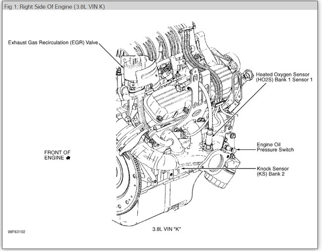

i purchased a second hand work vehicle. the engine light comes on code P0404 comes up on my hand computer. car shuts off at high speed but after a while it seems something warms up and it runs without shutting off. EGR valve and body control module. Can you help?
Mar 23, 2018 at 2:23 AM
  • 55,721 POSTS
It sounds like the EGR valve is shorting out causing he engine to stall. unplug the EGR and take it for a drive to see if the engine stalls? If it runs okay then the EGR valve is to blame.
Here is the location of the EGR valve.
You might what to test the valve as well. Here is a video:
