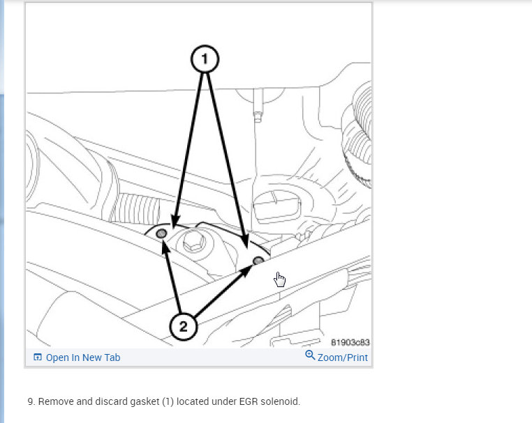

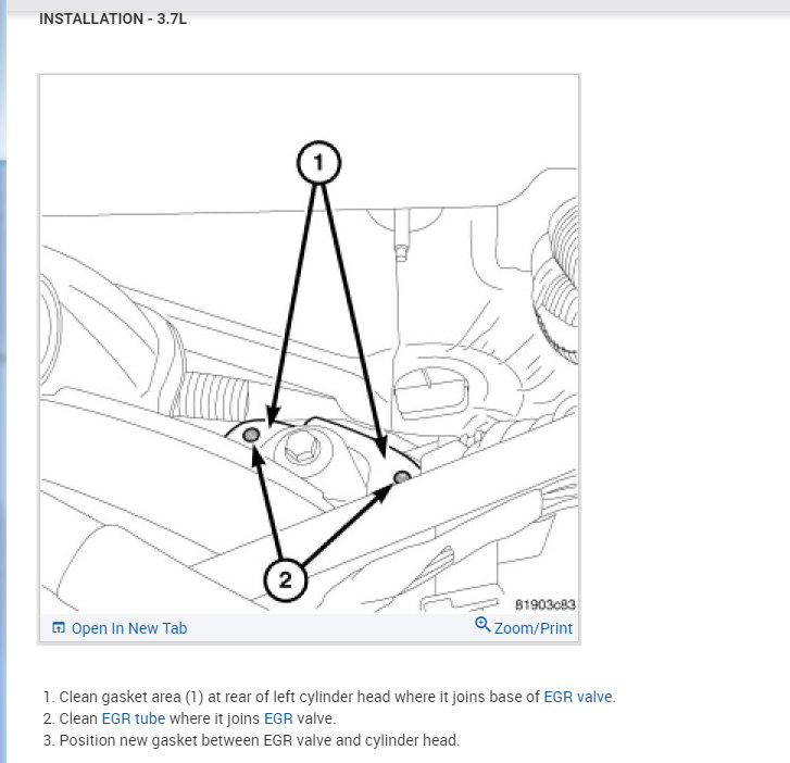

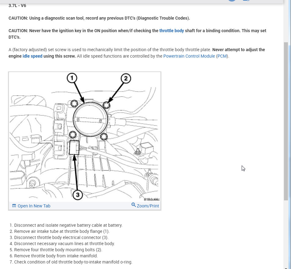

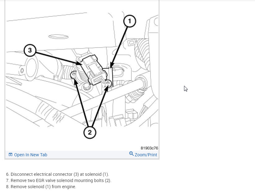

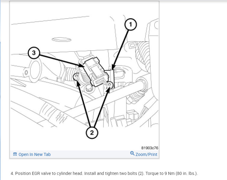

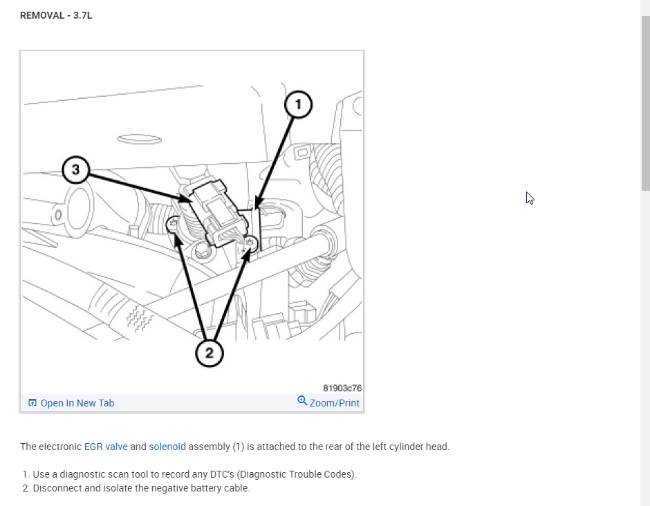

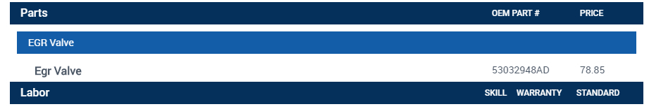

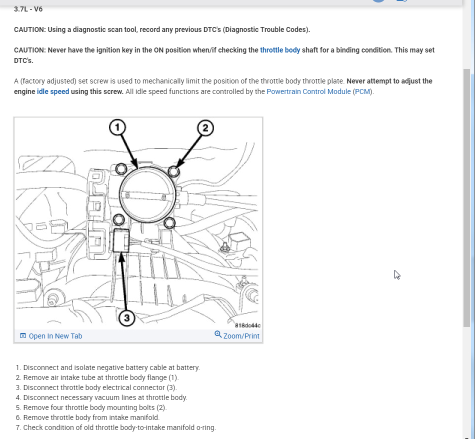

Hi, I'm needing to replace both parts on the vehicle listed above high idle off at least 600 at park.engine light on changed throttle body light came of 24 hours now on again.where are these located. can diralast EGR 260 fit my car model?
Jun 27, 2020 at 8:55 AM

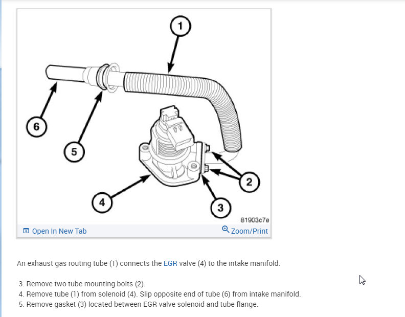

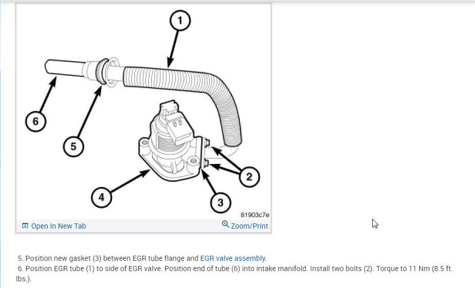

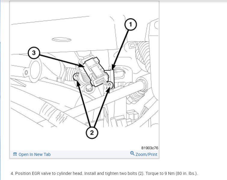

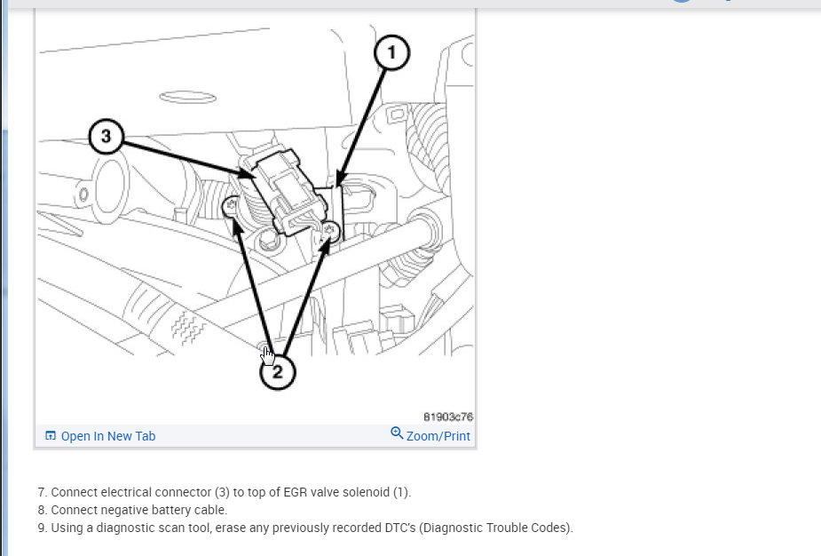

I attached the processes for these components. However, I would suggest we run through the testing for the codes that you are getting for these lights. If you have not scanned for codes, we need to do that. If you have, can you provide the codes and we can do some testing to make sure these components are causing the issue?

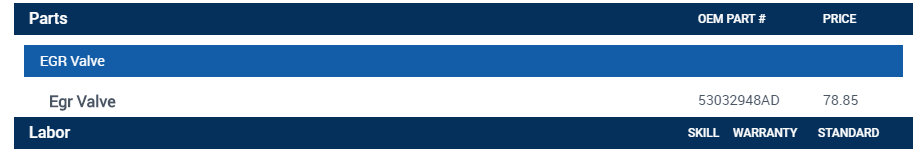

As for the part fitting your vehicle. I attached the OEM part number for you to run a cross check on the part that you have. Otherwise, you can provide me that part number off that part and I can check to see if it fits. Thanks
