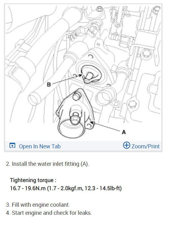

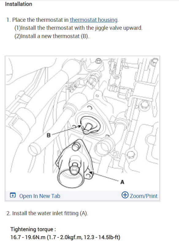

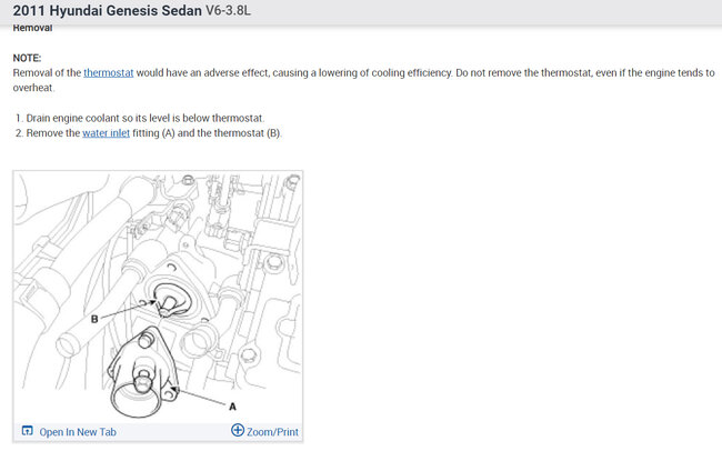

Please don't junk the car, we can fix it. The one reason for the monitors not to set is a bad thermostat. Please check out this guide to help as well and I have included how to change the thermostat out correctly.
https://www.2carpros.com/articles/how-to-reset-an-engine-computer-monitor-program
If the thermostat is removed and it is stuck open this will be the problem. Also did they scan the system for codes?
Check out the images (below). Let us know how it goes.
