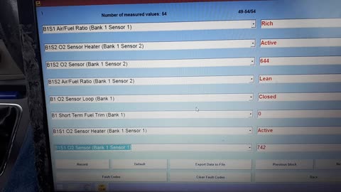

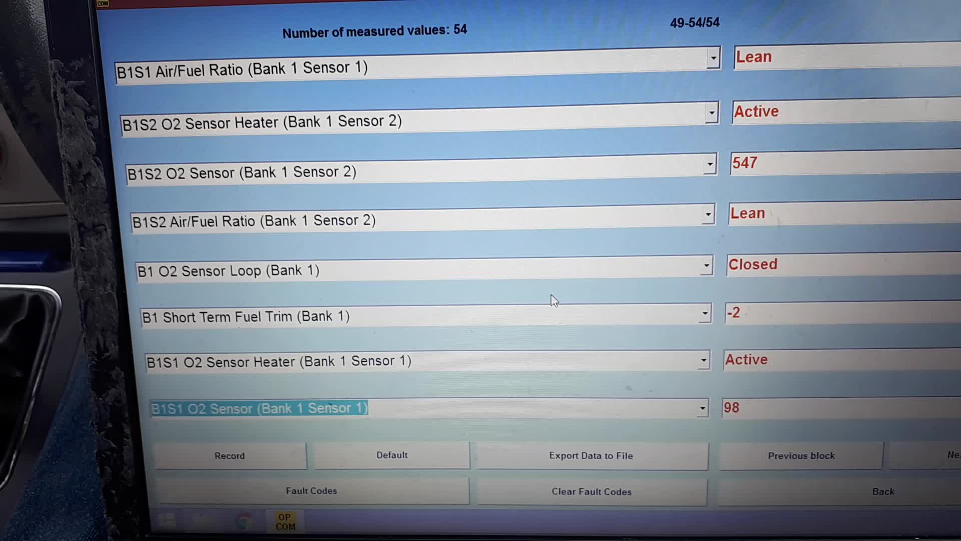

I have a problem with emissions and fuel trim. I had engine light come on so had a friend look at diagnostics to tell me the fuel trim is lean. I was advised to try cleaning inlet manifold and EGR. I have done this to my best ability (2 days as I'm a noob) I have reset the management light and It has not been on since. But I am noticing slight sluggish acceleration and a slight judder. I have included a video of recent diagnostic if it helps. The eml did come on after a long motorway drive originally but hasn't come back on since cleaning.

Based on that video the o2 sensor is not telling you that it is lean. It should be switching back and forth like that. Basically the engine controller cannot keep the engine running perfectly all the time so it is constantly changing it to get it to switch between rich and lean. This means it is right on the sweet spot.
What was the actual code that you are getting and is there a reason they are saying it was running lean?
We don't have a manual on your vehicle because it is not offered here in the USA but I am sure we can try to figure this out as an engine is an engine.
