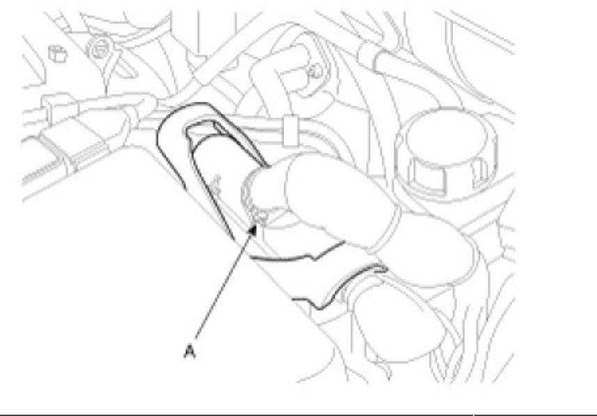

Does anyone know the location of the ECU/PCM on the vehicle listed above LX? If possible could you provide a diagram? Thank you!

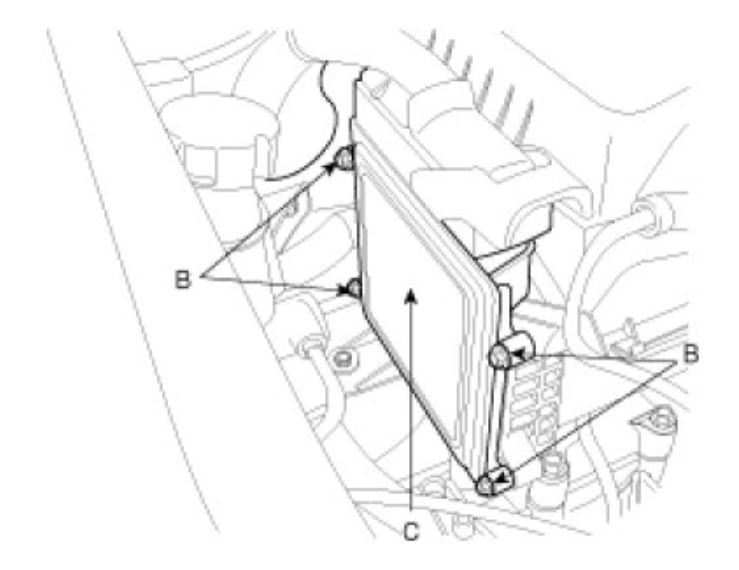

The ECM is by the master cylinder. I attached the procedure and a picture for the repair.
Replacement
1. Turn ignition switch off.
2. Disconnect the battery (-) cable from the battery.
3. Remove the PCM cover and disconnect the PCM connector(s) (A).
4. Unscrew the PCM mounting bolts (B) and remove the PCM (C) from the air cleaner assembly.
5. Install a new PCM.
PCM mounting bolts:
9.8 - 11.8 N.m (1.0 - 1.2 kgf.m, 7.2 - 8.7 lb-ft)

Thank you!! Found it!!
